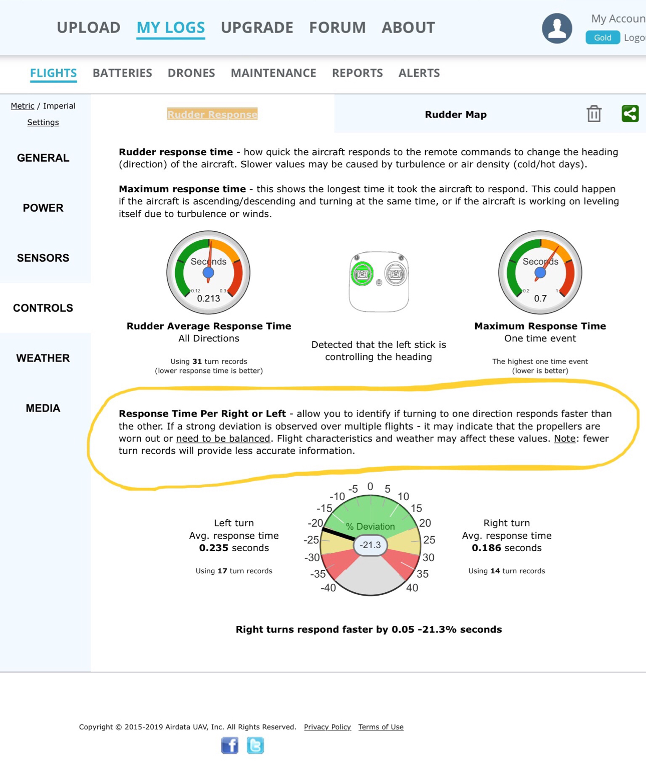

According to Airdata under controls rudder response, if there is a strong deviation in time between turning left or right it’s an indication of worn out props or props that need to be rebalanced.
