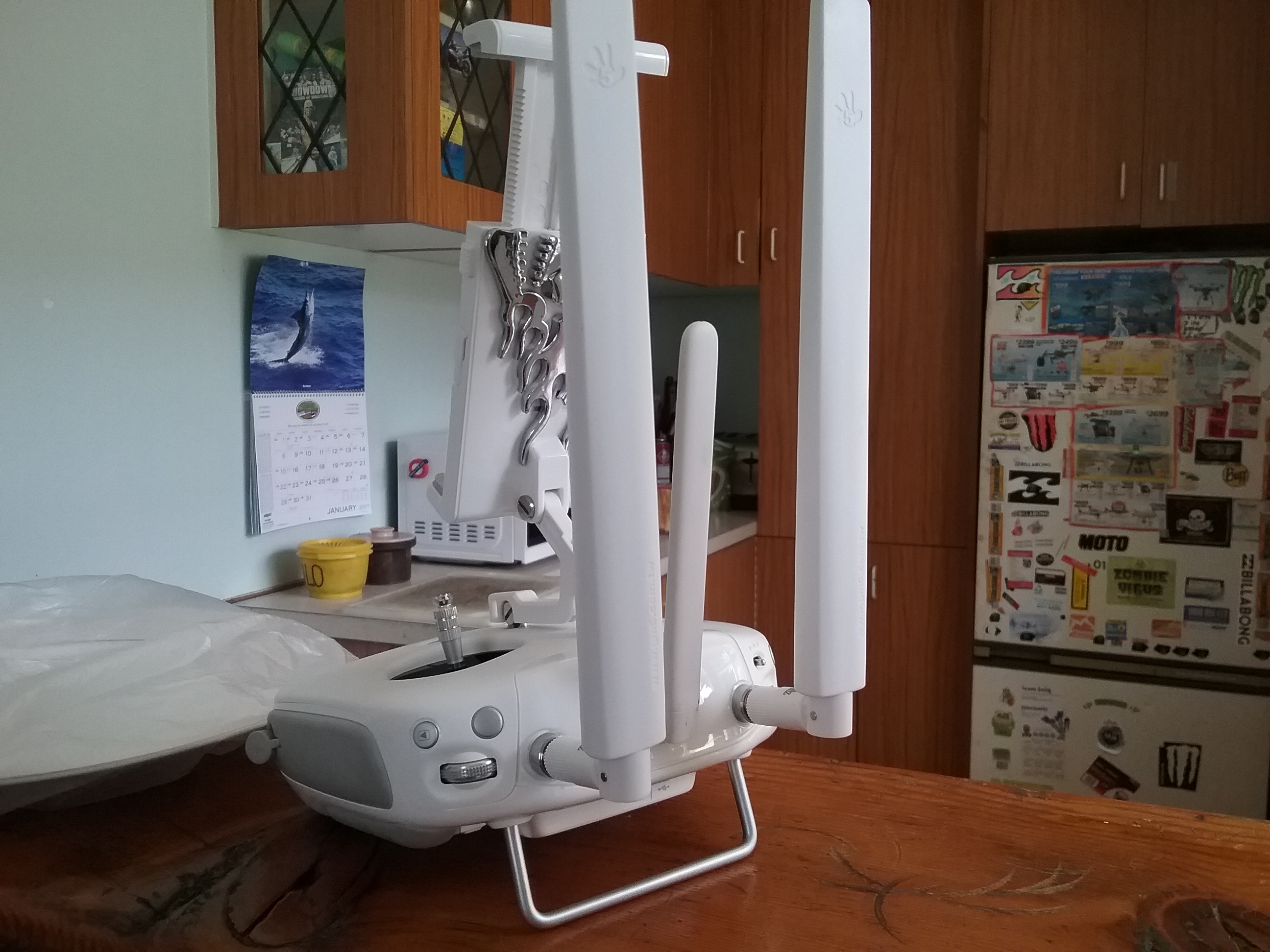

I did get these for p3 but ended up putin on p34k,,help a little buts these wernt good value,,,35 bucks off ebay but i got what i paid for.....not much,,,,,i also use windsufer with these to try help bit more,,,

I did get these for p3 but ended up putin on p34k,,help a little buts these wernt good value,,,35 bucks off ebay but i got what i paid for.....not much,,,,,i also use windsufer with these to try help bit more,,,View attachment 78448
Not saying this to be mean; I thought these were a joke when I first saw your picture. Those things are HUGE!
Mate all good have had al sorts of remarks:)cant find box they came in so cant give info,,sposed to be x5 ,,no even in need panels to complete set,,BUT they worked beta than originals,
