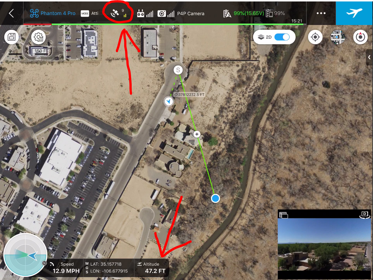

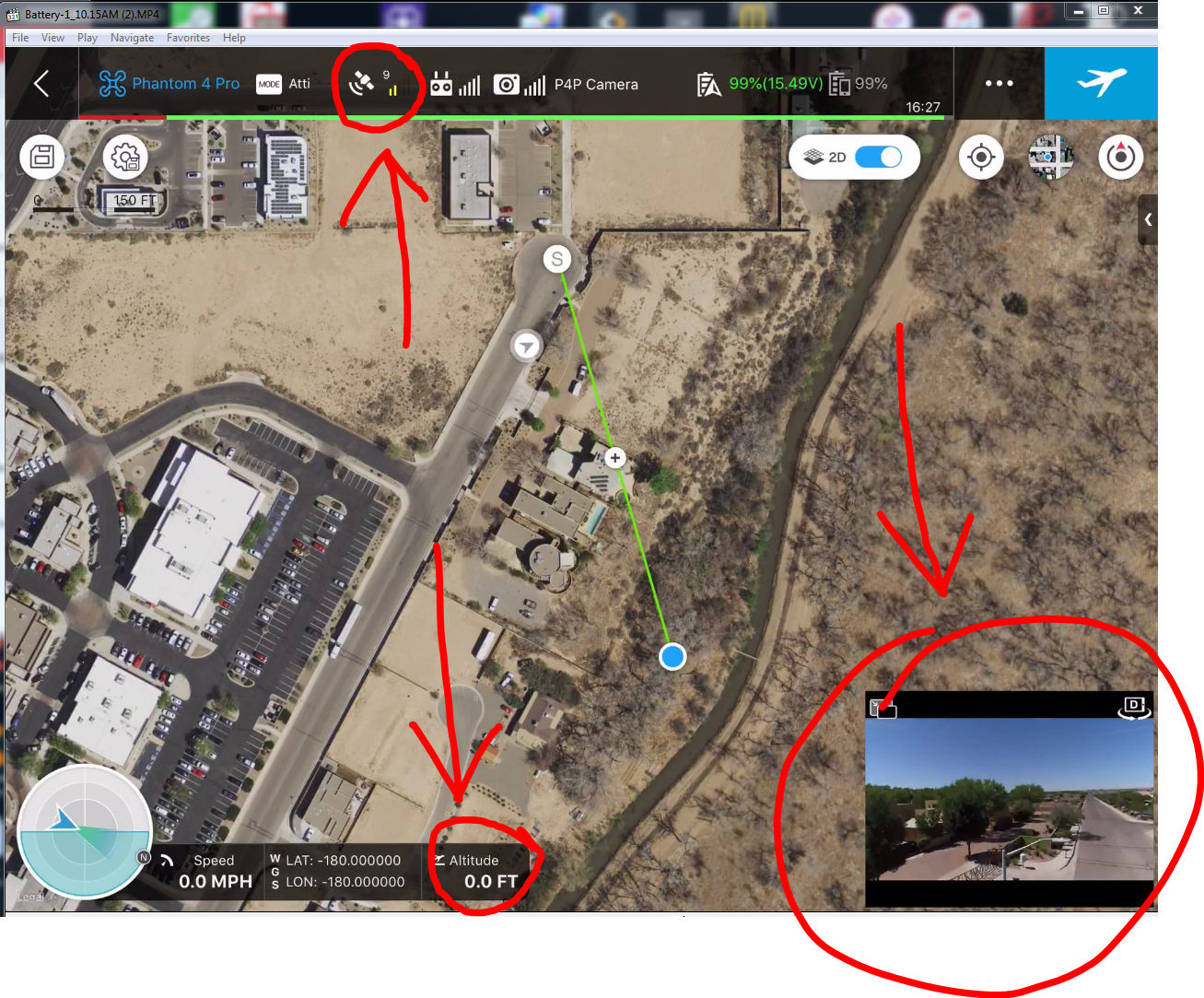

The manual is lying. Just last Sunday I was in a hurry to get in the air and I took off with zero satellites and then just floored it to get to 400'. Of course the P4P acquired satellites on the way up. But I'm sure I exceeded 26 feet with only two bars. Here's a screen shot. Note the camera view shows I'm higher than the street light. But because I just barely acquired those satellites, you can see mph and altitude is being reported as zero:
112180
Here you can see that I have enough telemetry to get altitude data (47.2 ft), but still just 2 bars.
112181
That said, I never use VPS (have had it turned off since day 1), so maybe that has something to do with it.

Which app is the screenshot from?

GS Pro.

You had 9 sats ... so you were good to go. Albuquerque is pretty wide open and from the looks of things the area you're in has little to no significant vegetation so I'm sure you had lots of them quickly. :sunglasses:
You had 9 sats ...
When I first started the motors I had zero. But, yes, I acquired 9 satellites rather quickly. I have taken off with less. I'll have to get video of that.
Yessir. Those launch points are chosen on purpose.
