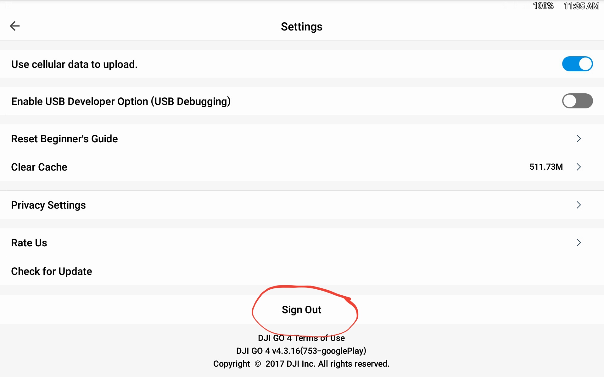

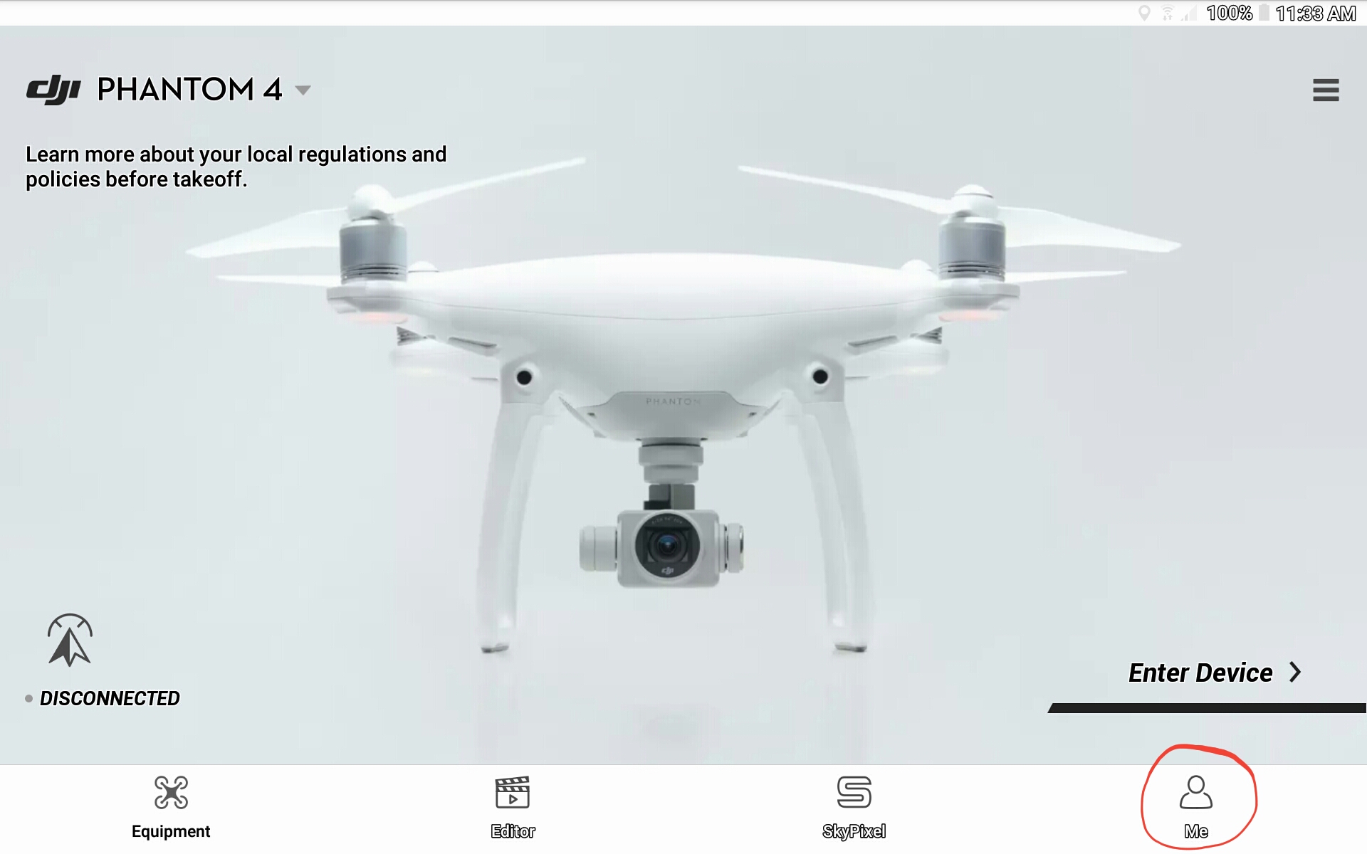

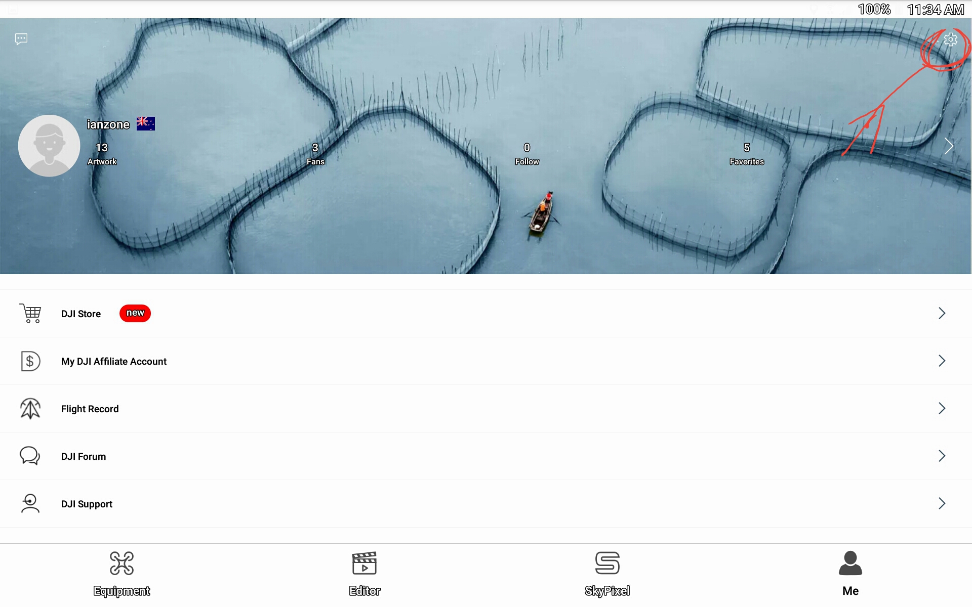

Where do I go to log in and out? I really have only used this for photo and video and have never actually connected it to my computer. Do I go to DJI web site? Thanks
once you do this next time app opens you be asked to log in,,example email address

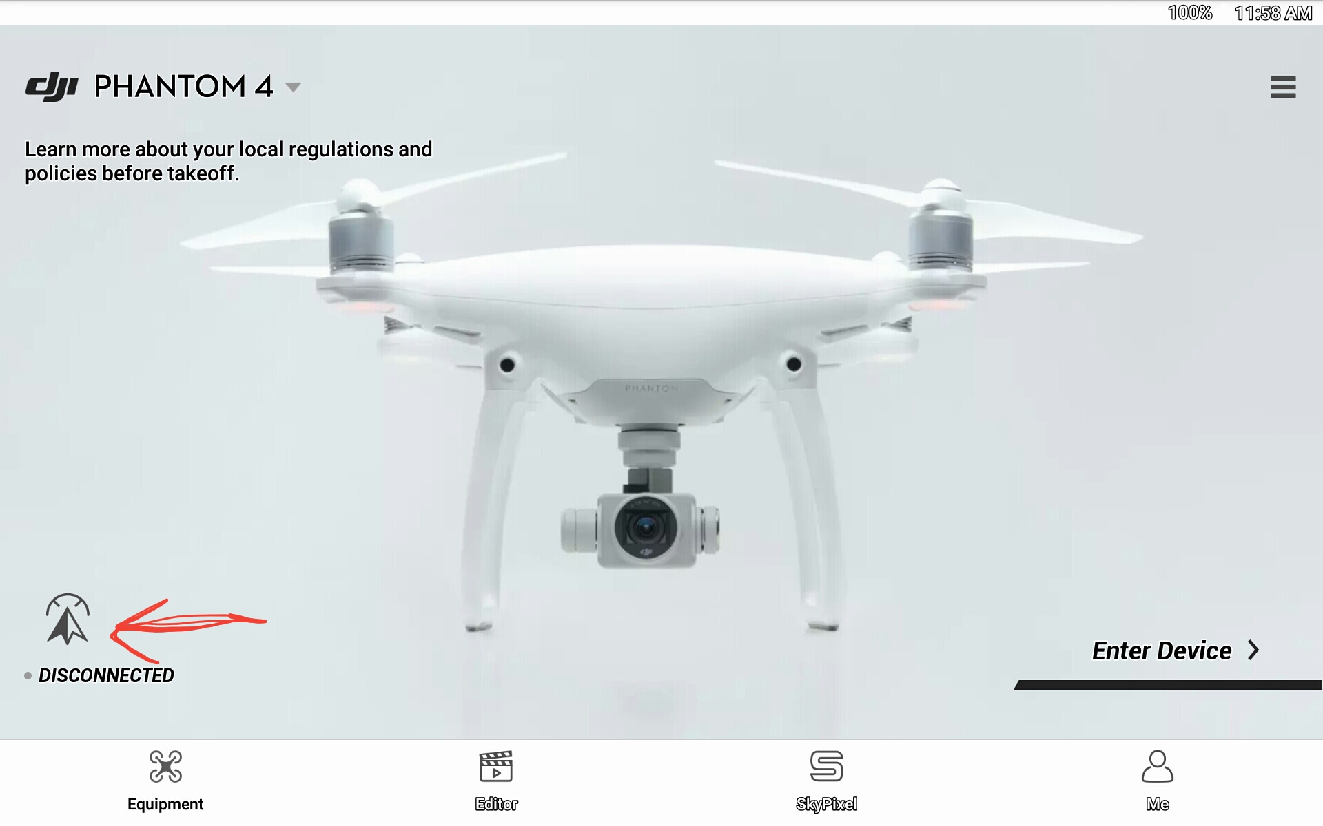

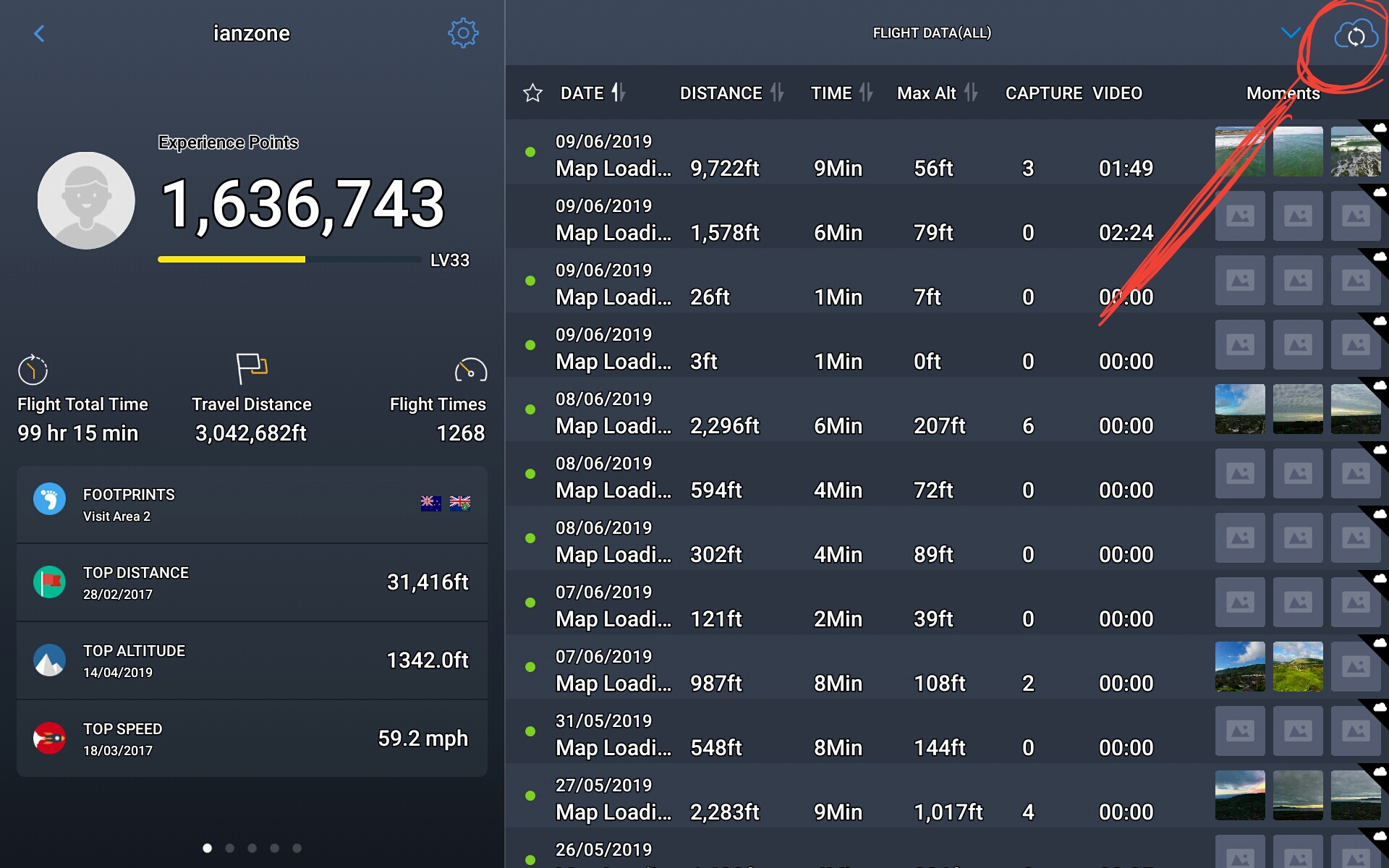

Do you sync your flights with the cloud, that way all flights come to your device,,did you activate this drone when new with your details
I don't know if it syncs with the cloud. Its been years since I bought it and I remember having to set it up but don't remember what I did. I went in and logged in and back out but nothing changed.
OK if you click on that clould it will sync your flights to that device,,it won't do if you don't do it
