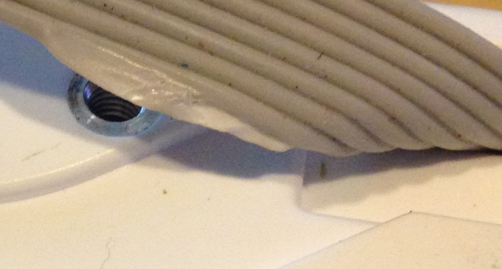

I removed the Gimbal mounting plate, and then found the root of my problem!
Likely a manufacturing defect from day 1 that has grown and worsened from the various hard landings. There is a shallow channel in the bottom of the P3 that the cable runs along, and then through a cutout on the plate, During factory assembly, the one strand of this ribbon cable was pinched between the plate, and the body of the P3. PROBLEM FOUND!
