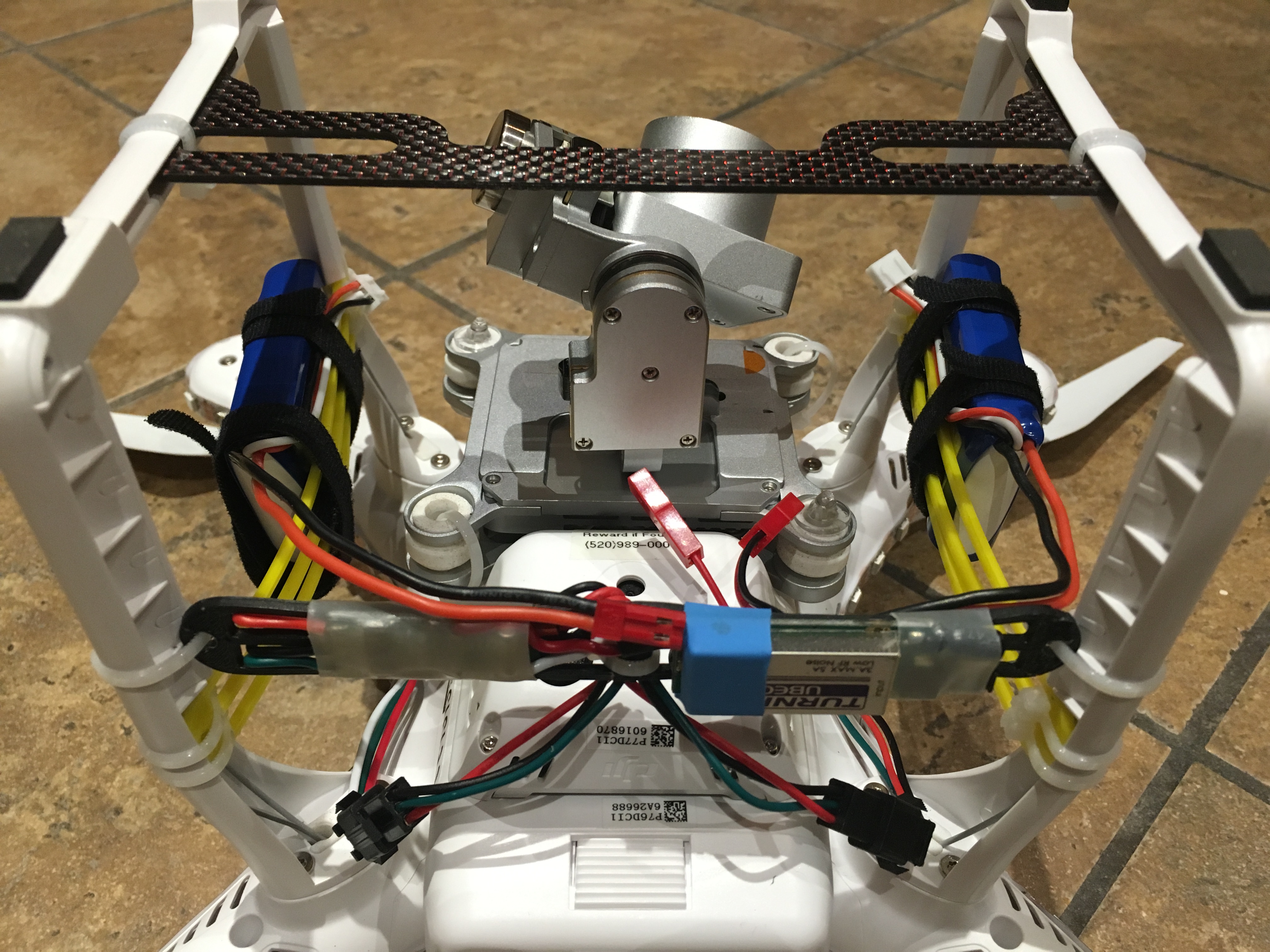

This was a DIY project. This photo is the first prototype, I then cleaned it up and lost a lot of weight by soldering everything directly.
Used WS2812B addressable LED strip along with a mini controller from eBay.
1~5m 5V WS2812B WS2812 5050 RGB 60 LEDs/m Pixel Full Color addressable LED strip
LED Symphony Controller For WS2812B WS2812 LED Strip Light & 14Key Remote 5V
I split it up into four sections and soldered the connections such that the pattern was symmetrical from any direction.
They are powered by a small LiPo battery and power converter for the 5V. I used two batteries to maintain balance, but one is enough power.
https://www.amazon.com/gp/product/B0072AEHIC/ref=oh_aui_detailpage_o06_s00?ie=UTF8&psc=1
Amazon.com: New Turnigy UBEC w/ Noise Reduction 3A 5/6V switching BEC 2s 3s 4s 5s 23v US: Toys & Games
I originally ordered this LED strip on Amazon because it is unusually narrow which would have worked better on the rounded Phantom body.
Amazon.com : 2m Ws2812b 60leds/m 5v Narrowest Led Strip 5.5mm Width White Pcb 2811ic Inside 5050led Ip30 Ws2812 Led Strips : Patio, Lawn & Garden
But turned out it is a Chinese seller and shipping time was almost 6 weeks! I needed them for an event two weeks away so ended up with the "standard" sized strip. Haven't taken the time to try the narrow version yet since they finally arrived.
