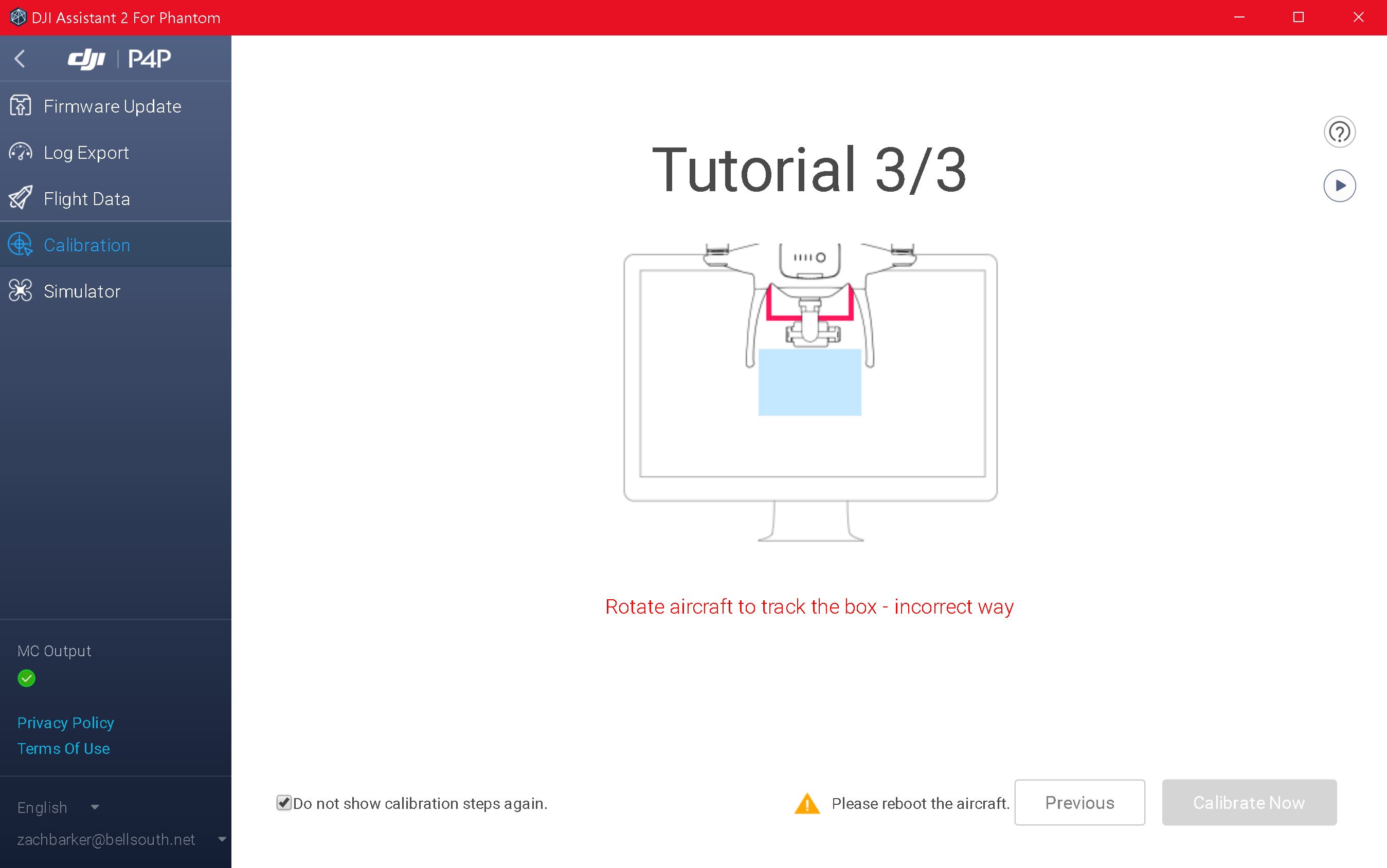

"Please reboot Aircraft"

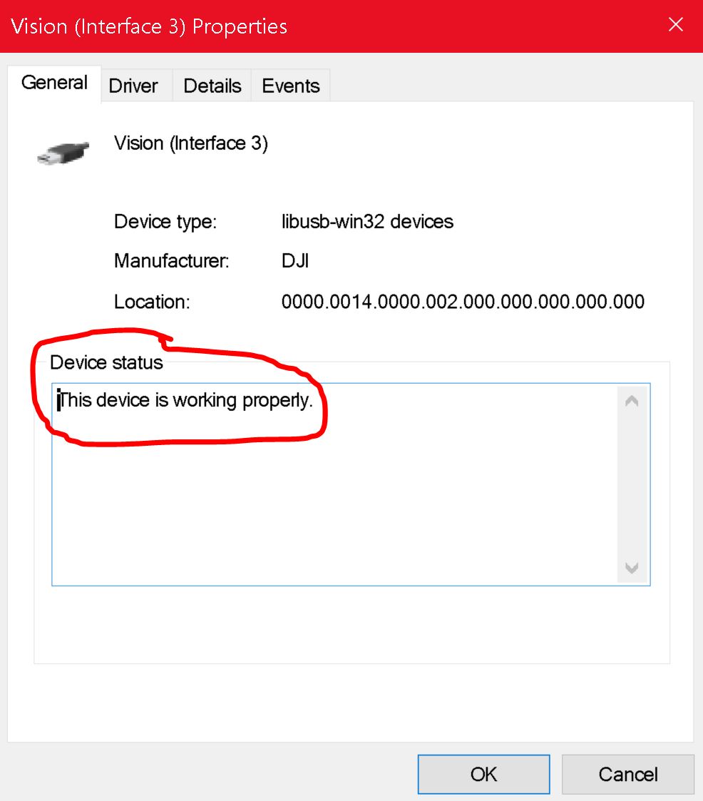

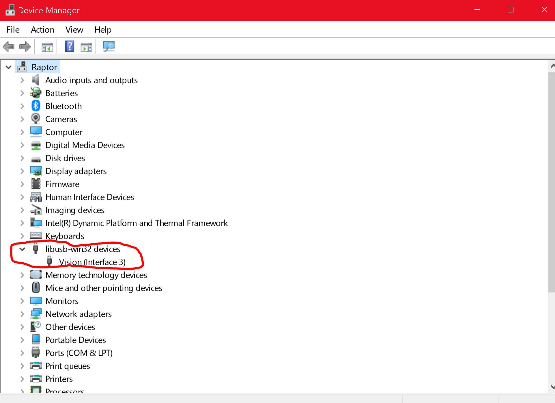

Trying to do calibration in the DJI assistant 2. Every time I go to start the calibration the button turns grey and I get a message beside it saying "please reboot aircraft". I've tried rebooting my PC to disable driver sig enforcement, no luck. I even tried looking at what I believe is the driver "vision interface 3" disable it enable it, reinstall it, still not able to. If someone is willing to help me I'm willing to do like TeamViewer or discord call so I can share my screen to get some help. Doesn't hurt to get someone else's view. I'm stumped currently at what else to do.

Yes I'm trying to calibrate the vision sensors. I clicked skip the step because I was tired of going through the steps trying to troubleshoot.

Yeah, the calibration but will not turn blue :(
Hmm Im using the latest version of A2 for the phantom V2.0.10
I've read of a few having luck with the greyed out button by lowering their screen resolution first. Also, have you tried calibration on another computer (and/or another monitor) with Assistant 2 installed?

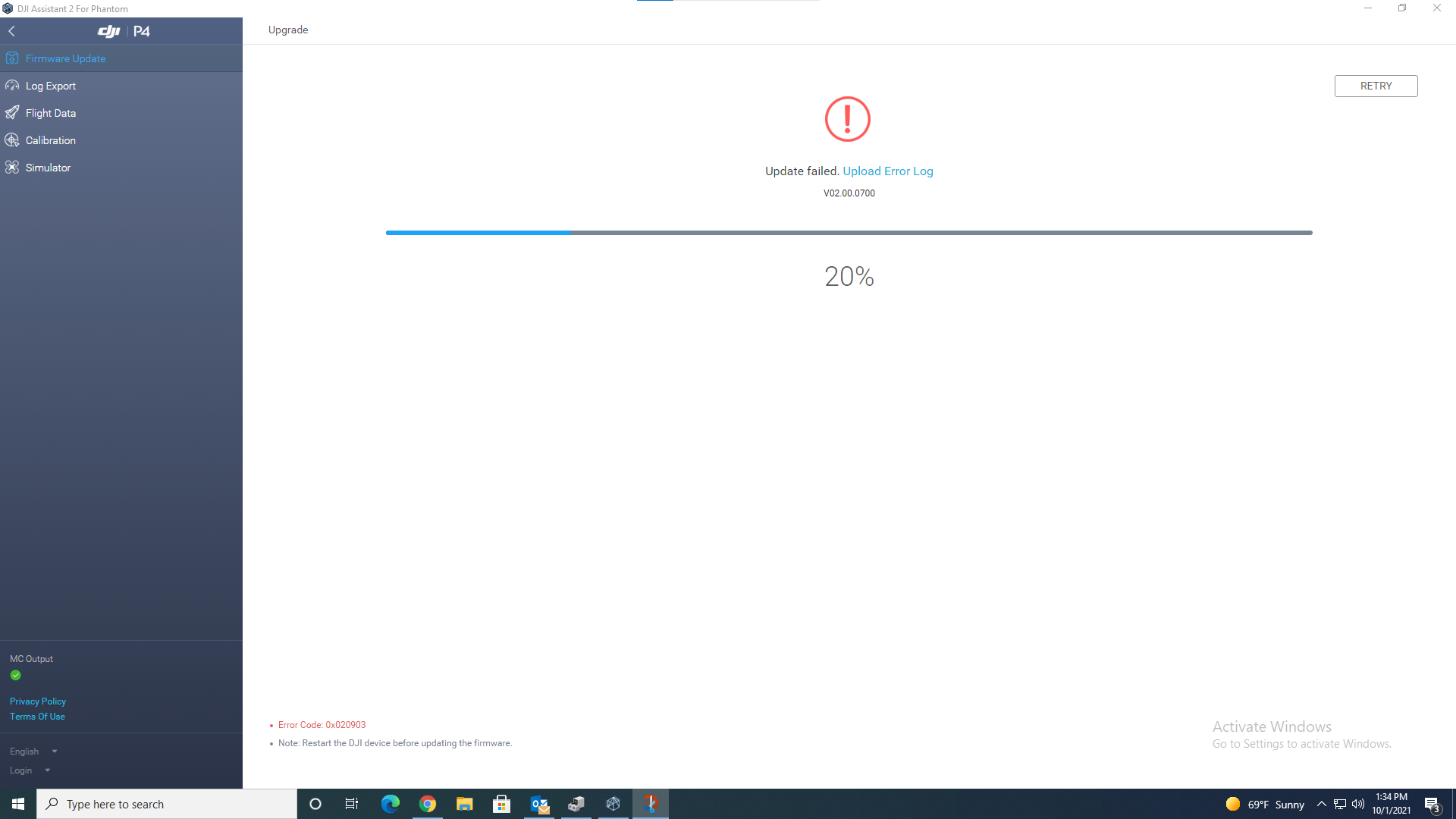

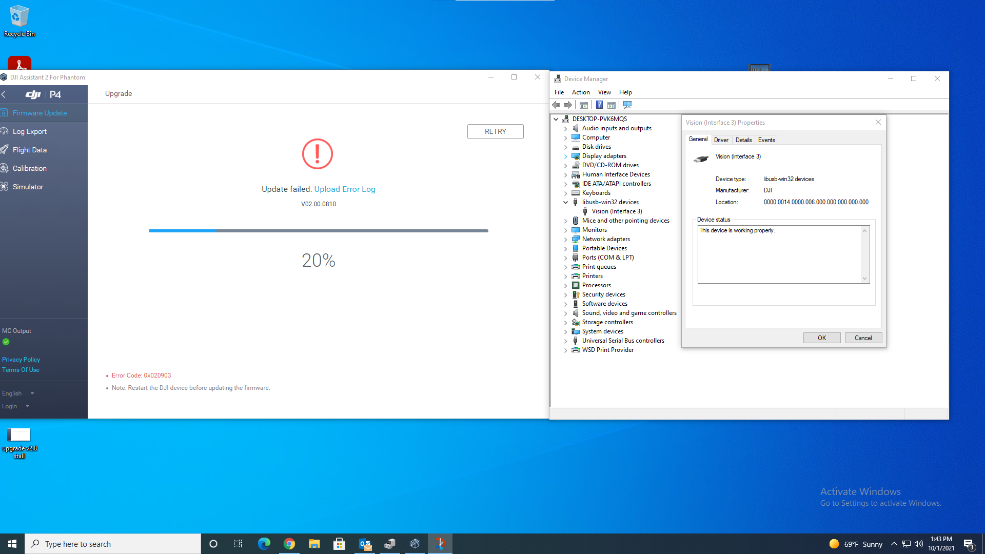

Ugg this is still an issue for my Phantom 4 advance. Tried IOS and WIN10 multiple monitors. I always get the please reboot aircraft, never to the screen with the dots on them.

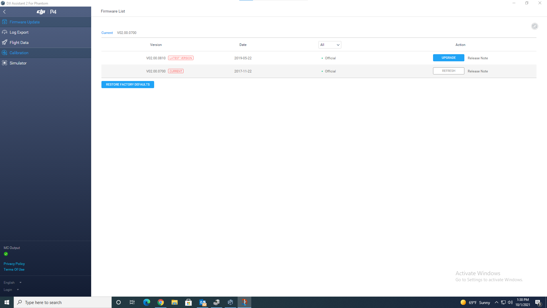

Current version is V2.00.0700 when I try to update to V2.00.0810 or refresh it will download the package and transmit the package. but when it go to up 20% and then stalls out. I can hear the aircraft disconnect and reconnect via the the device manager tone. Cant even do a factory reset
