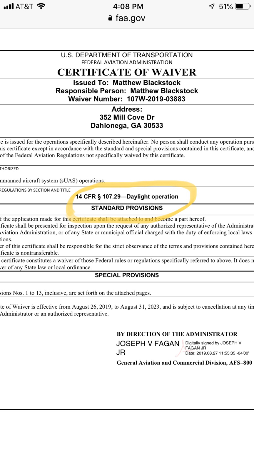

I am kind of lost here. Can someone please explain why the FAA is asking questions about night operations for a daylight operation waiver? I do like The Real Rob’s reply under “Don’t give up.” It never states that any of this has been done, only that it will be done for night operations, and since the OP is asking for a waiver for a “Daylight Operation”, well…. ?
It's easy. Quit trying to do it all from scratch. The FAA has published what they need.
See https://www.faa.gov/uas/resources/p...52_responses/media/107_29_for_section_352.pdf .
Copy, add, change to suit only finer details, like position light colors. Attach your training material / 20-question multiple choice written exam document (if needed, search the site for previous persons test or PM me for it). Poof, you've got a waiver.
All flights must occur between 30-min before sunup and 30-min after sundown, which includes daylight hours; i.e., between sunup and sundown. Any flight outside of those times; i.e, during darkness, requires a waiver of the rule requiring that all flights occur only during the window of time previously described. The waiver must be granted by the FAA.
The Op is asking for a waiver of the rule requiring him to fly only during the window of time previously described.
The Op should consider taking this training course for night flying and waivers: Night Operations Online Training Course for the Night Waiver
I have not taken the course but based on the course description, it looks like it will help you understand the issues the FAA is concerned about and say the right things in your waiver application.
@fbrickphoto, it's confusing but when someone is getting a night waiver, it's in reference to the Daylight Operation 107.29 section of the Part 107 law. Basically, you're only allowed to fly during the day and the waiver is requesting for that restriction to be waived. I agree, it's confusing and probably not the best choice of wording.
It’s a Daylight Operations Waiver which lets you fly at night.
