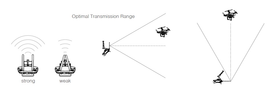

At first be sure the antenna are correctly orientated like this:

I am having this issue too and your diagram looks interesting. I will give it a shot.

Diagram is not mine, user manual page 27.

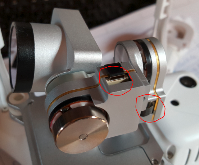

You should check the ribbon cable all its way for damage.
Also check if each of the connection point is correctly and fully inserted.

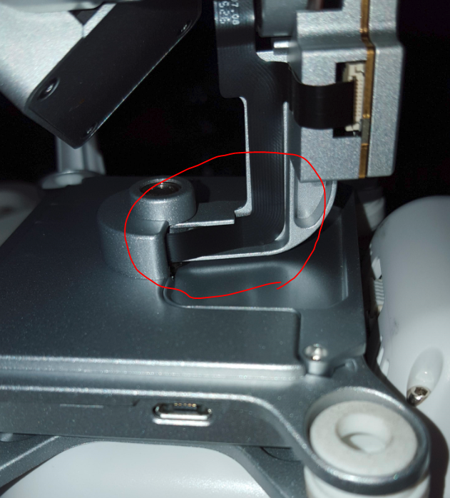

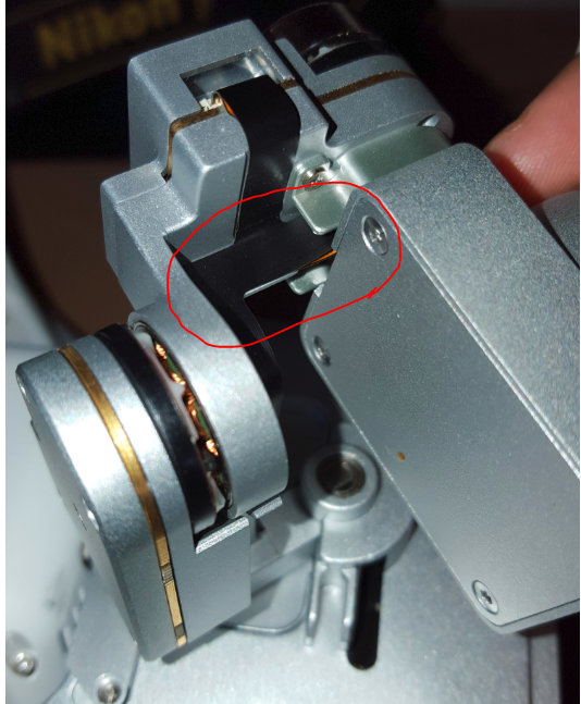

Check that there is no place the ribbon cable is too tight if the camera is moving in any direction (with P3 powered down). There are 2 critical areas:
Some phantom are just mounted with not enough space for the ribbon cable to properly adapt to the camera movements.
