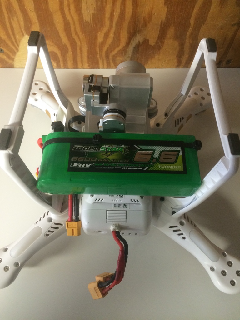

Hey db, hows the 6.6 compare to the 5.2??
P3S w/ multistar 6.6. 39:20
5.2. 37:12
P3P. 6.6. 34:30
5.2. 32:00
The multistar 6.6 is TOO HEAVY for the either a/c it takes off fine, it hovers fine, it flies fine! But if you brake too fast, it struggles too stabilize & seems like it wants to do a backflip! Then when you get to 10% and try to make it back to yer feet it struggles and is hard to control , ending w/ (2) poor landings so far!
The 5.2 is KING! No probs![emoji41]
