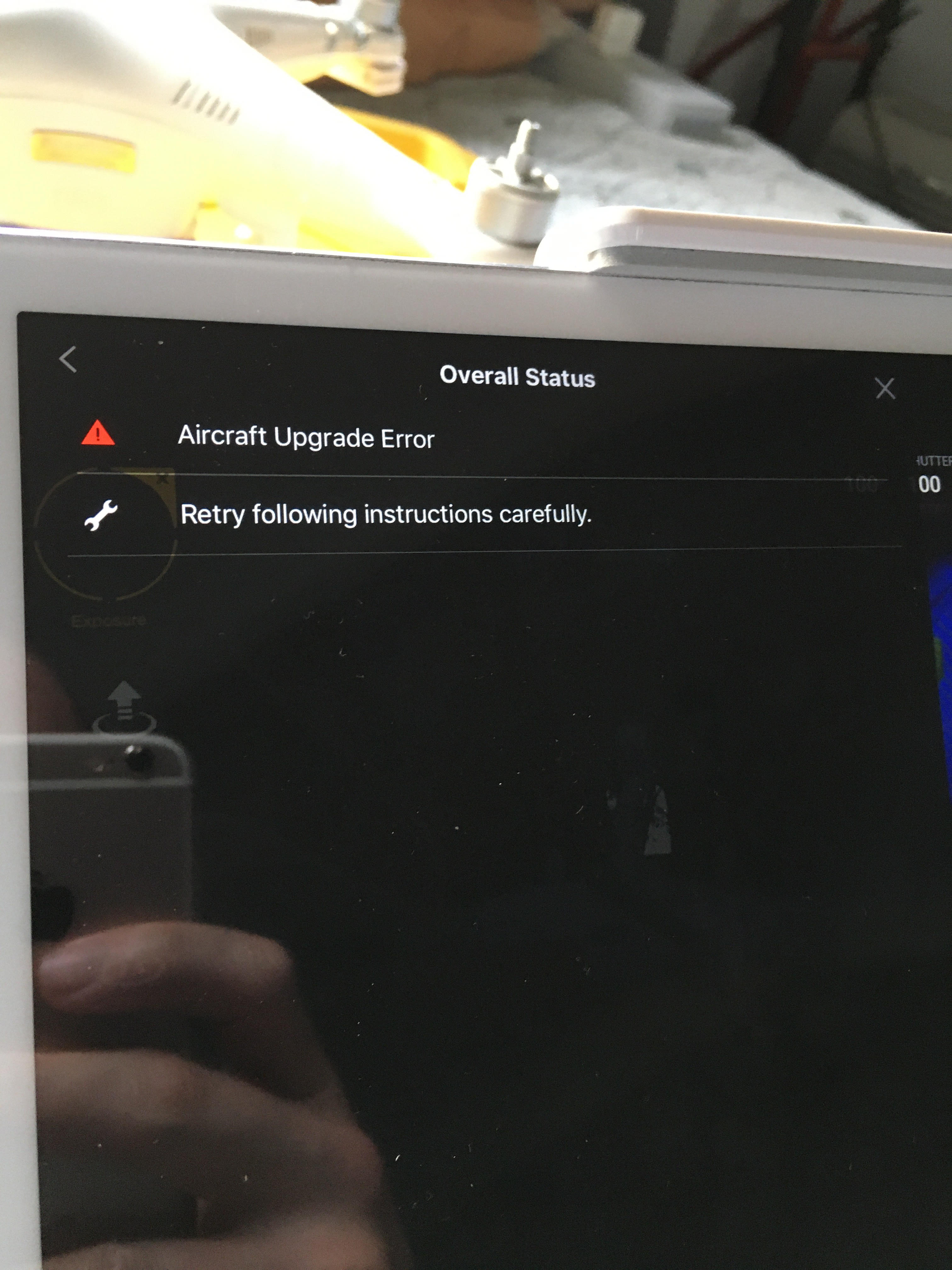

Hello,
Found the latest firmware 1.11 and tried updating, now I keep getting constant fails...I've tried formatting the card, different sd card, multiple times, still beeping.
My ipad shows the firmware to be updated, but the drone is constantly beeping...
Any help would be greatly appreciated

You have several modules that are not detected. First thing I’d try would be; format the card again then put a debug file on it then the original firmware version you had on it, 1.10.90, and try that update. Probably won’t work but worth a try.

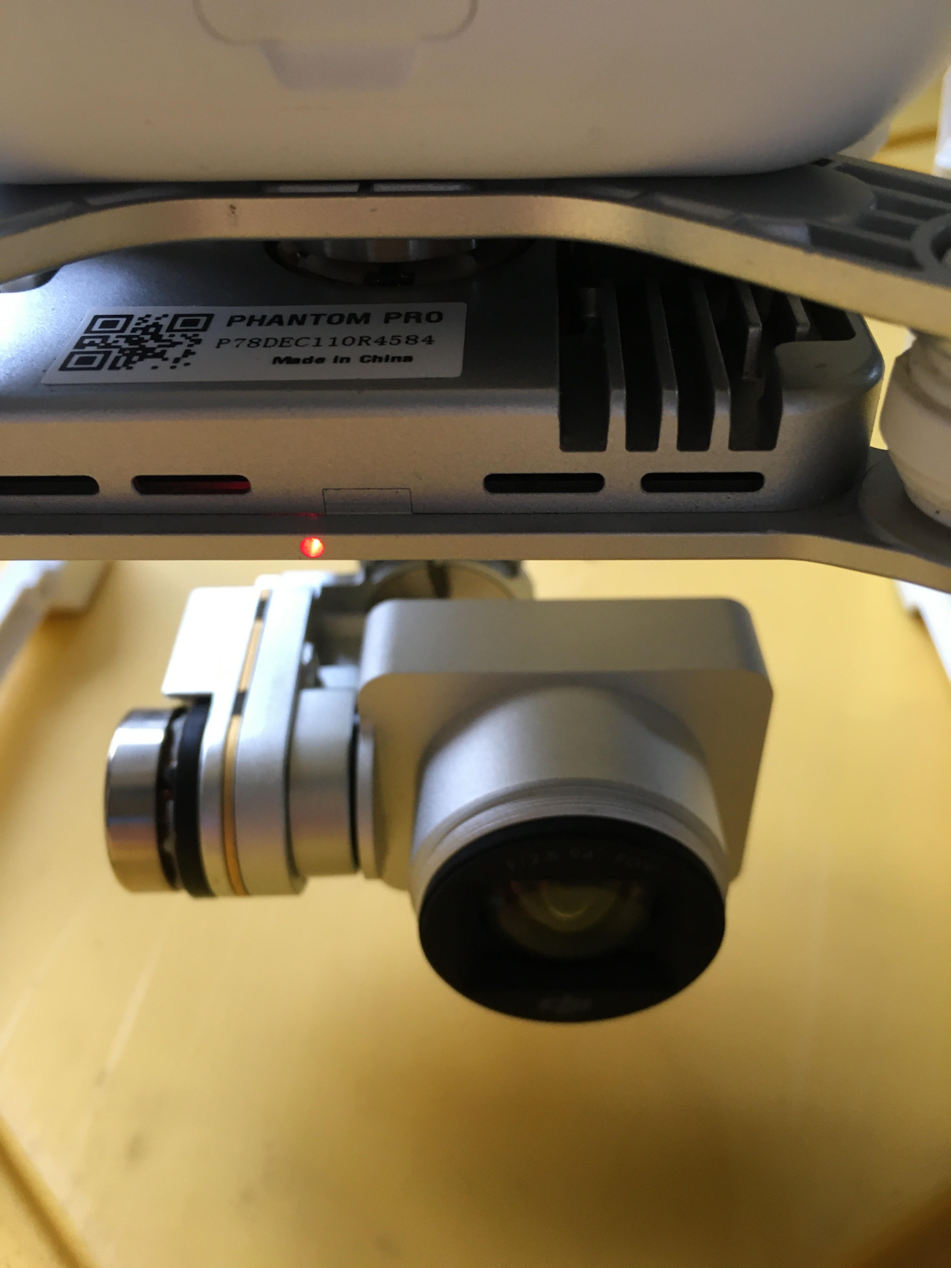

When you start the update, does the gimbal light do the green-red green-red at all? What sounds come from the gimbal?

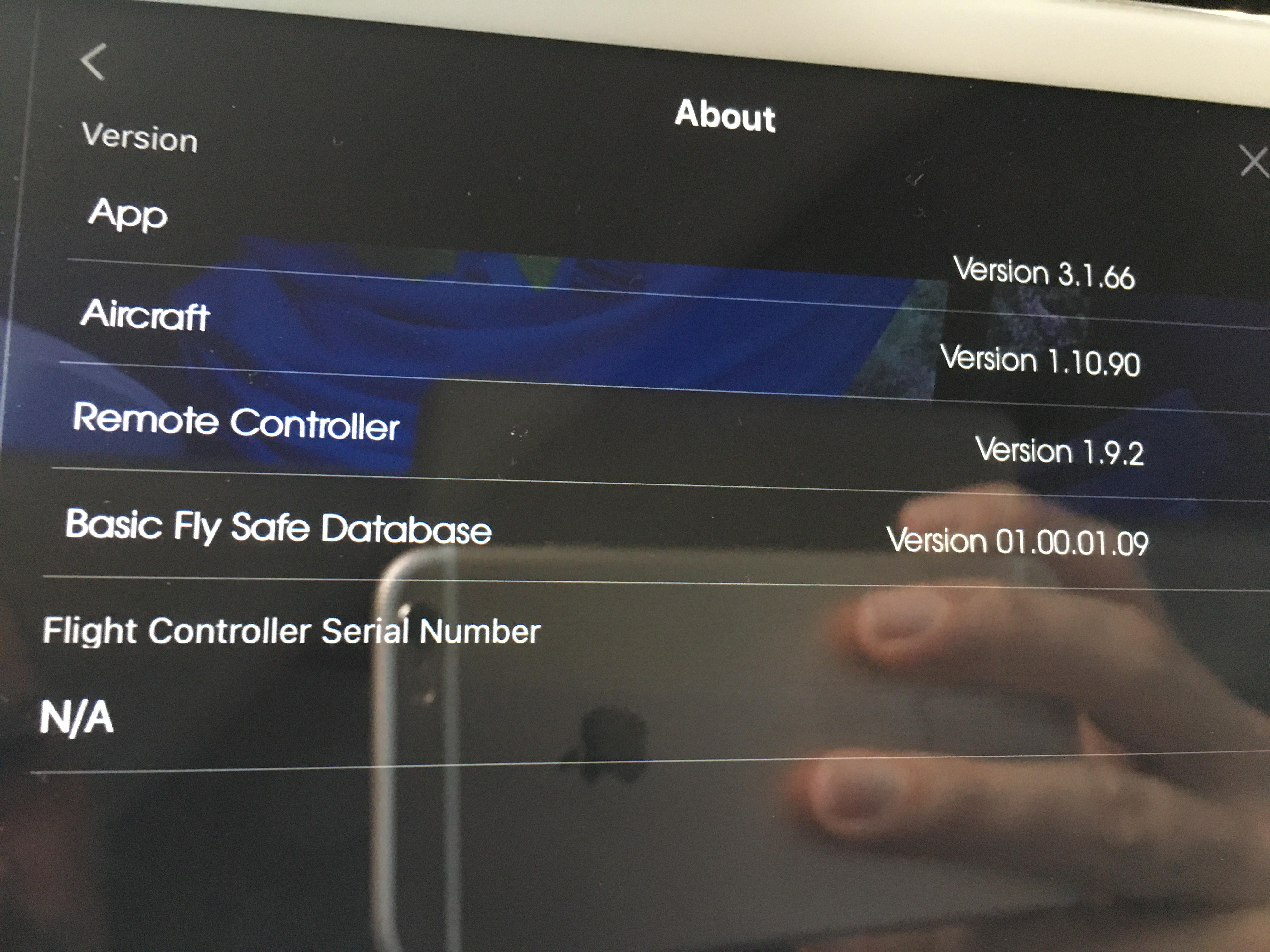

According to the results log it states the failed firmware version as the 1.11.0020, which is what you said also. DJI made that firmware version to where you are not supposed to be able to downgrade the firmware versions. Although the update failed, it has updated some of the modules.
DJI also has an unofficial firmware version to repair the P3P’s that version 1.11.0020 created an ESC error. It’s called 1.11.0030. It was specifically for ESC error repair. I don’t know if it would be beneficial for your situation or not. I attached the file for it if you decide to try it.
Other than that, you may have to replace the motherboard.
When I start the update yes does the green to red blink for about 2minutes, then goes to red, gimbal definitely makes noises like the normal low beep noise...then when it hits red the gimbal has a long constant beep and wants to stay straight, if i move it it goes back to straight position.

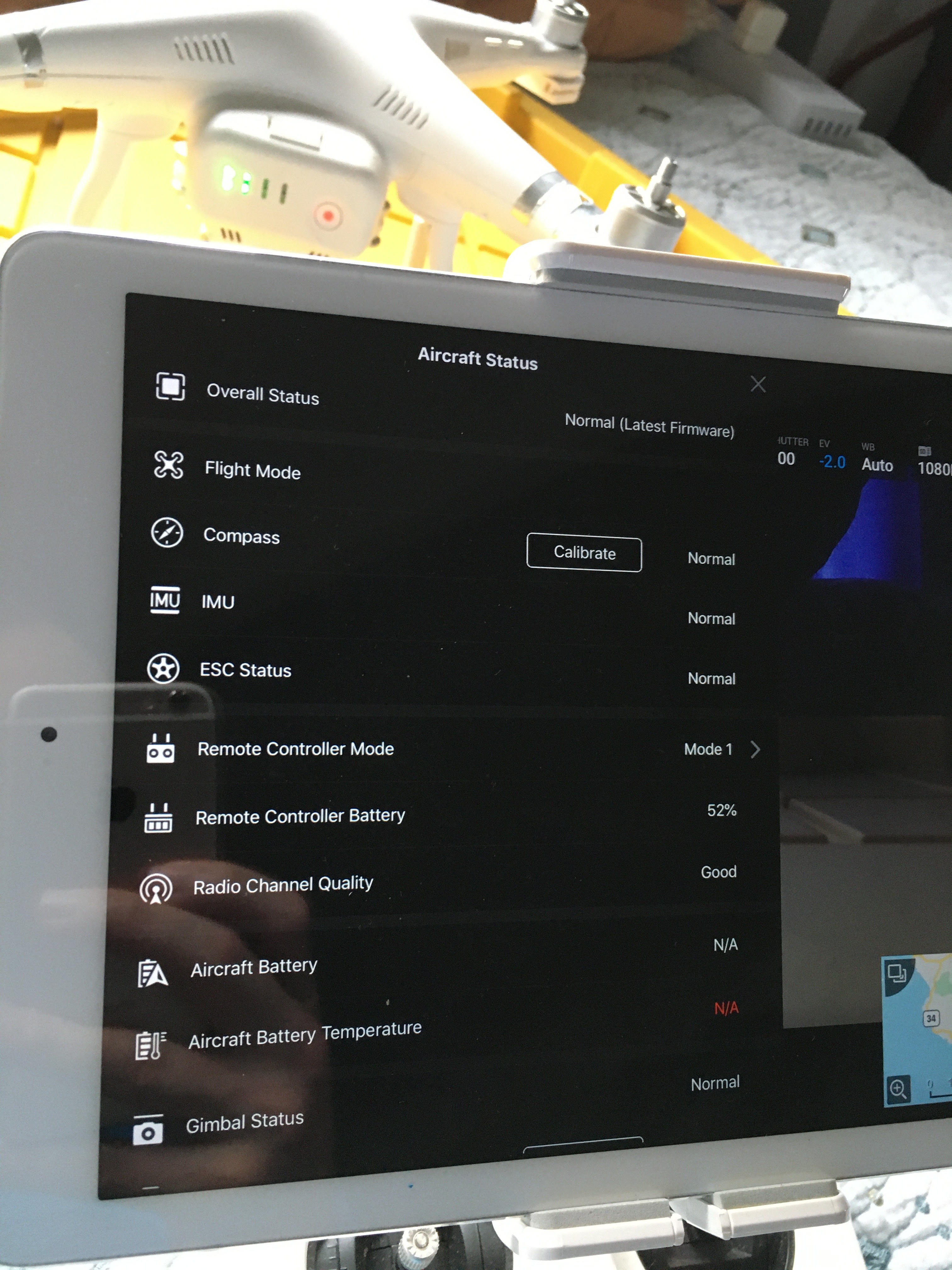

So many modules not detected including the VPS and all ESCs. Are there any cables disconnected inside or out?

That’s what confuses me. Although it was crashed, you have flown it numerous times since then. But,,, I wouldn’t rule out anything now. Did you check the grey ribbon cable going to the OFDM/VPS module? Is it plugged in completely and making good contact? And the grey one from the drone to the camera,, check also to be sure that each grey wire is fully inserted into the white connector.
