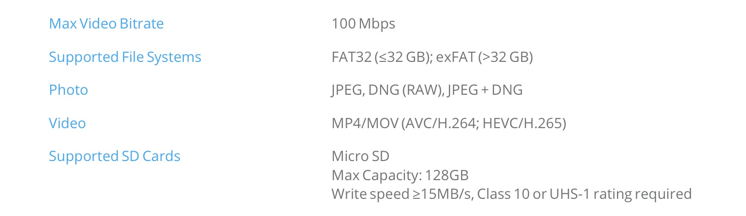

Agreed. However, as others have pointed out above, formatting in the computer can cause problems if people don't know what they are doing, especially if they try to apply a FAT32 format to a 64GB card. There are also issues associated with formatting in Mac computers. I also have a Sandisk Extreme Pro 64GB card that was formatted in a Linux computer, which was then deliberately reformatted without an error message in my P4P. The video also "recorded" without any error message, but was later unrecoverable. So, the Phantom's "dislike" of the card as formatted, even after reformatting in the aircraft, was not communicated, and the video was lost because the card was previously formatted in a computer. YMMV.
DJI’s acquisition of a minority stake in Hasselblad Group is the best thing that could have happened for those interested in DJI as an aerial platform going forward. Hasselblad has always been the Rolls Royce of cameras and lenses. I look forward to this acquisition trickling down to even better cameras and lenses in the prosumer end of the product line, like a potential P5, which has unfortunately already been discontinued. :p
That's a good feature, didn't know that. I believe the craft only formats in one format. Do we know which one? I would assume P4P only offers FAT32 when formatting a card for legacy support.
The card is formatted in the aircraft with the correct format based upon the card size inserted.
Maybe the DJI format failed. A successful format would write over previous tables. If that format failed to complete properly in the craft, you would likely have issues. DJI not liking the previous format is far fetched IMO, as it's irrelevant when it writes over the previous. It's more likely a glitch in the DJI formatting, which can happen at any time on any card with any platform. This is one of the reasons I don't always reformat, it's a little higher risk of something messing up. I simply delete the video files upon transfer to my computer, and use the previous format that worked. But that shouldn't be done too many times, as performance can be impaired if simply deleting video files is done too often, versus reformatting which is optimal.
Does exFAT even work on DJI products? They mention it (DJI marketing B.S. perhaps?), but I still only get 4GB video files where exFAT was supposed to get rid of the FAT32 4GB limit? Maybe it works with the SSD cards in the Inspire 2 but I don't know. The drop of a few frames in FAT32 always bugs me if the file rolls over.
The 4gig limitation isnt file system related. Many cameras have the same restriction, including the popular GH4 and GoPro models.
There are NO frame drops on the P4P using exFAT when the file rolls over. :D
I only cited that incident to respond to Meta4's statements, "Neither have I heard of anyone else having problems because they formatted outside the Phantom. If the Phantom didn't like the card as formatted, it's going to tell you and you can format again in the Phantom anyway.."
It can and has caused problems for me. I'll never do it again. No need to. Quick formatting in the aircraft over the last format in the aircraft works perfectly every time over the last 3 years with over two dozen DJI aircraft . Formatting anywhere else has the potential to lead to problems, as I learned the hard way. :cool:
