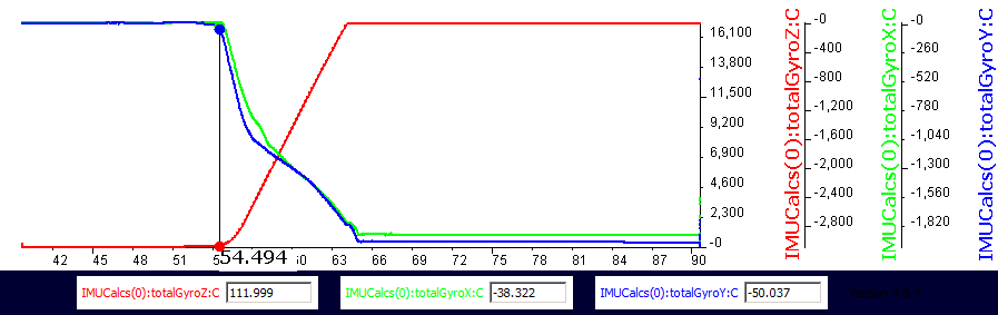

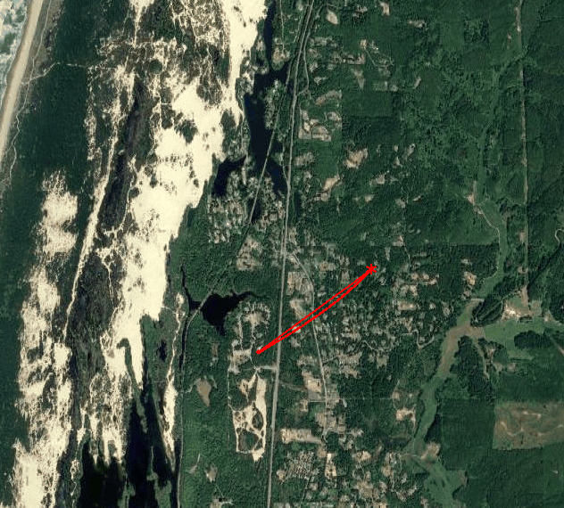

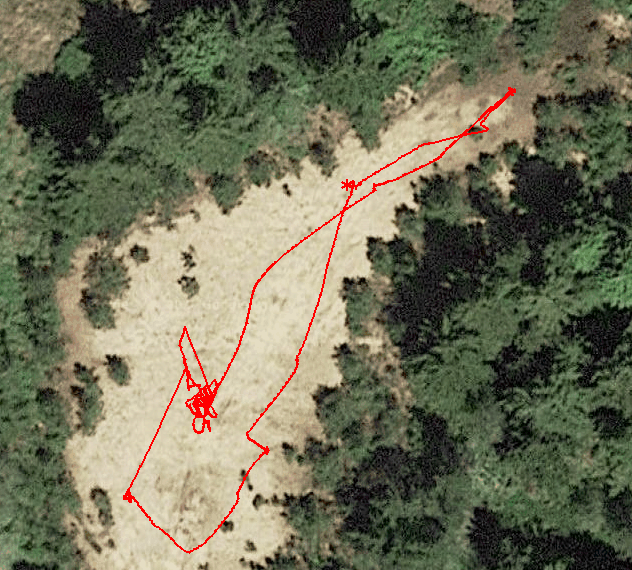

FLY029 didn't have the kind of event you described. It took place at 2020-3-10 18:47:31 GMT. Here is the overview
FLY130 appears to have lost the left front prop. The flight took place at 2020-3-10 19:2:54 GMT here

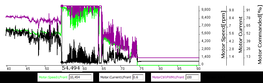

At 54 secs the left Front was commanded at 100%, sped up and reduced it's current draw.
In addition, the P4P started to tumble forward, rolling CCW and yawing CW - all consistent with loss of propulsion on the leftFront.

Thank you for the summary, Bud. Consistent with the limited info I could view in the Tlog and the pilot's report from the incident. I wish there was a more apparent indicator, like excessive vibration or heat from one of the motors.

Motor data could possibly give some indication of a pending blocked motor or problem with the ESC. I've seen others suppose this is possible. But, I'm unaware of anyone actually doing this.
This is definitely a broken or departed prop. I'm guessing that if there is any measurable change in vibration it's already too late. Only possibility is to catch the problem in pre-flight.
