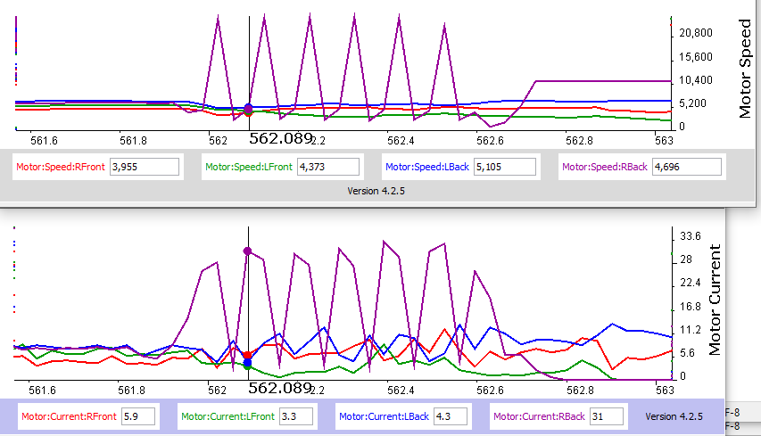

I looked at this some. It appears that there was a loss of propulsion in the right back corner. But, it's not your typical motor blocked or broken prop scenario.

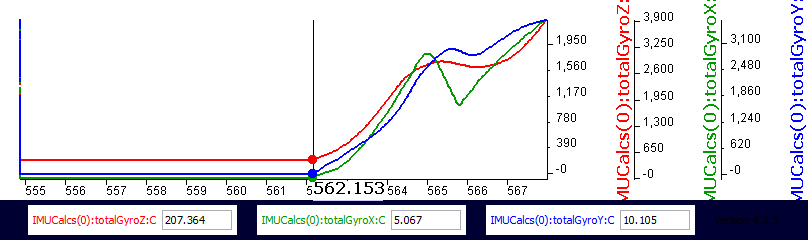

At 562 secs the P4 starts to tumble CW yaw, CW roll and pitching backwards end over end. These are all consistent with right back propulsion loss.
If this were a broken or lost prop the current would decrease and speed would increase. If it were a stuck motor the current would increase and the speed would decrease. Instead both appear to oscillate at about 10 Hz.

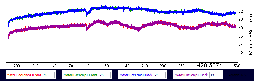

I'm going to speculate that the cause is a HW problem, possibly the ESC. Supporting this is the fact that ESC temps for the left motors was about 20°C higher than the front two.
I checked a couple of other P4 .DATs which shows ESC temps being within 3°C.

ESC seems reasonable only that L front is also pretty warm..
