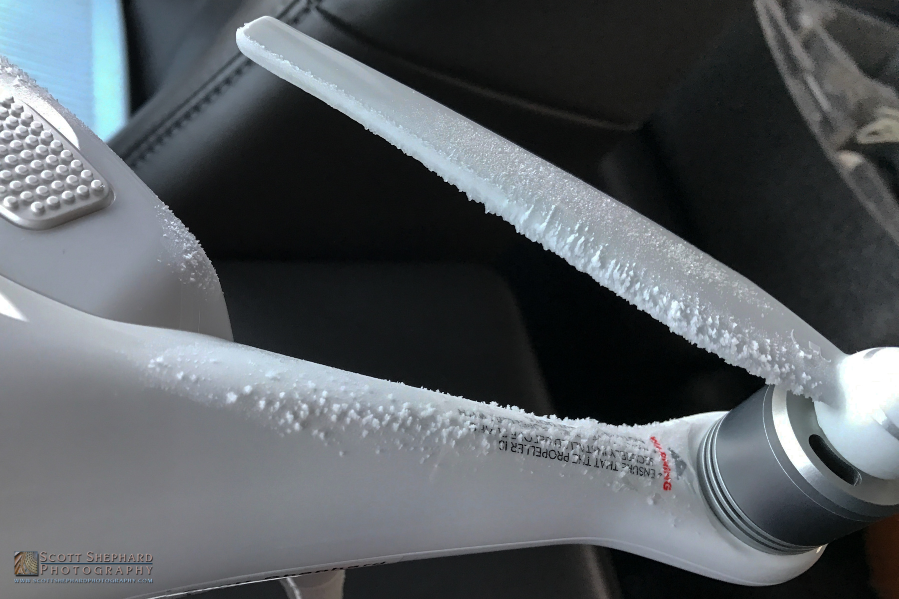

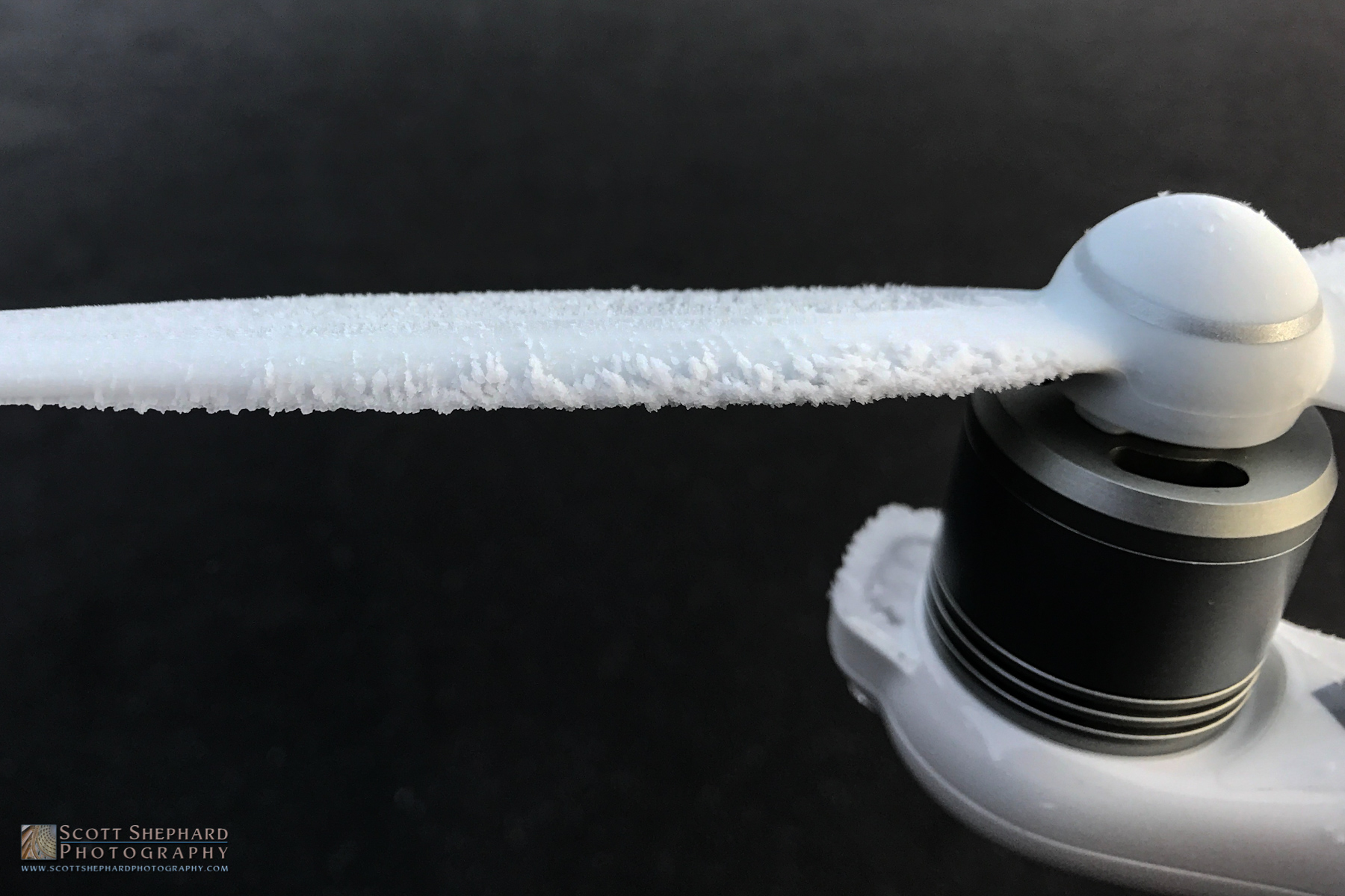

I was out in the country flying this morning. It was +2° F and there was ground fog. This particular flight only reached an altitude of about 75 feet and lasted 3 or 4 minutes. When the drone landed, I noticed that there were ice crystals on the body and props. I didn't sense any change in behavior as I was landing it though because I'm new to all of this, I'm not sure what a difference in handling would look and feel like. Here's the video clip I filmed as I was taking off (speed doubled). For the rest of the morning, every time I flew, I needed to de-ice. Has anyone else seen this?
And a couple photos of the ice crystals

You were very lucky. Any more Ice and you may have lost your quad.

Ice on the props changes the airflow of the propeller resulting in a loss of lift and crash. Ice on the body will primarily add weight to your craft as well as disturb the airflow in flight. You got lucky this time, many a full size aircraft has crashed due to icing - google it.

The fact that you have Fog , shows Dew point was reached at that temperature in the atmosphere around you & the air was saturated with water or Humidity . bringing a warm aircraft into this environment , not to mention its movement ( prop speed ), will cause Ice to form .

Rime ice.
Any general aviation pilot who has experienced rime ice will tell you that the impacts of rime ice on performance along with the speed in which it can accumulate is frightening.
