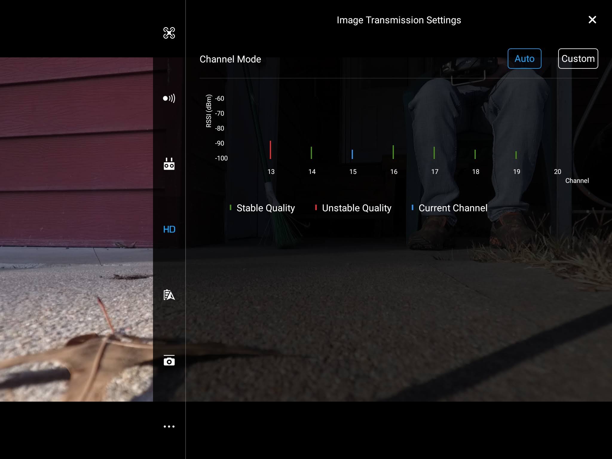

What's it doin in your transmission channels while this happen,,do a test just recording on ground and selec t a custom channel on manual see if it comes ok,auto preselected channels might be working hard for some reason,, could even try airplane mode to stop things working on your device,,,,presume this been ok till now,,anything newly updated or changed

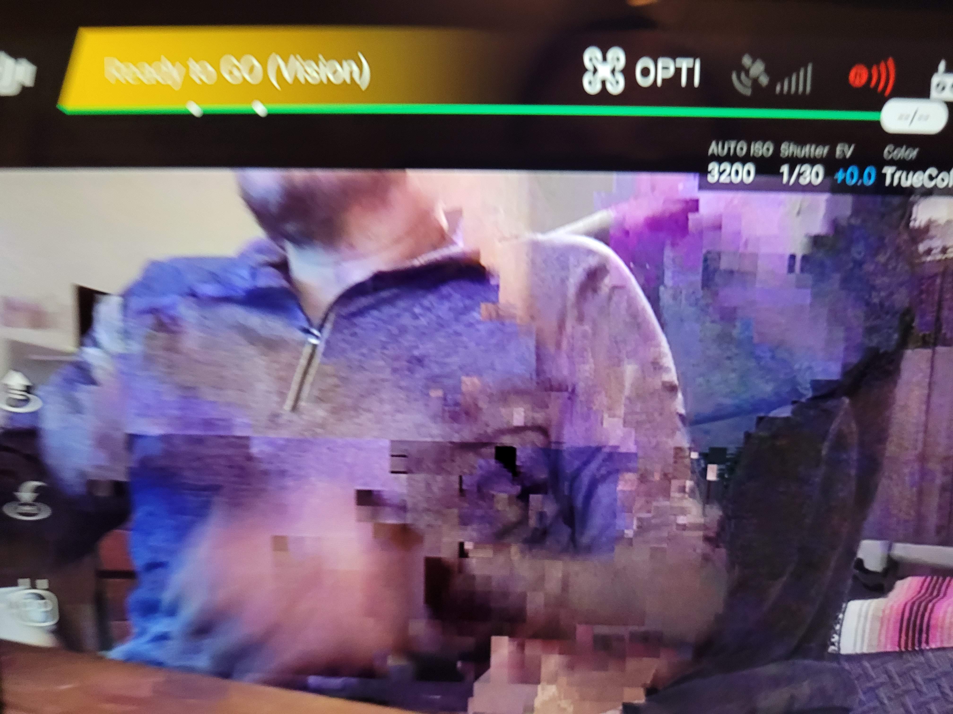

A screen shot of your HD screen would certainly help.

Ok here is a pic of what the screen looks like only while recording, whether a 1000ft away or right beside the controller, tried 3 different cards, and they work fine in my inspire and phantom 3, so dont really think its the cards. And all the recorded video looks great.
If i fly around without recording everything seems fine.

Here it is
Sort of looks ok to me on custom,does screen change at all with manual channel change,,,that blocking in your picture almost like recording speed ,have you tryed changing FPS (frames per second) ,like 1080 at 30fps for example

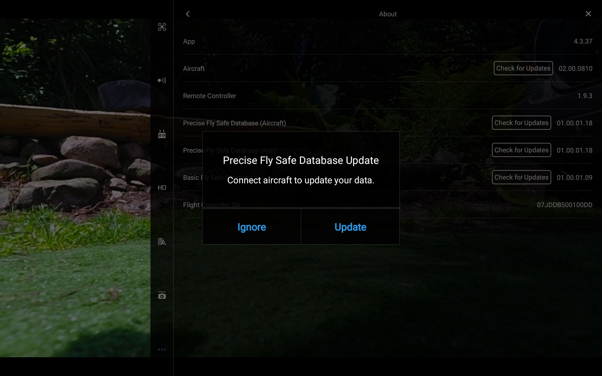

Also in your settings is a word ABOUT ,, with all powered on your can check your firmware installed here,just click on it if not find it yet,,depending on firmware it should look like this,,,and dont be shy to reply,I not bite lol
