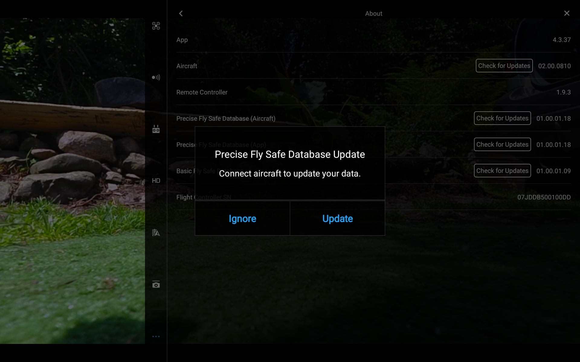

Also in your settings is a word ABOUT ,, with all powered on your can check your firmware installed here,just click on it if not find it yet,,depending on firmware it should look like this,,,and dont be shy to reply,I not bite lolView attachment 121052
Just looked and it has the same numbers your does. Oh and i tried ill different resolution settings, doesnt seem to change anything. Wish i could use the assistant app to refresh the firmware.
Here it is
Well your on latest firmware so dont try refresh it cause might not fix and give you firmware nightmares,,,,I have never used anything like such,,all done with my tablet,,I have never been able to load the assistant so I never used,,,I dont think its firmware causing it,,tryed the format of sd card when it in drone ?only deletes everything but sometime cures stupid issues,,all cam ribbons look nice and plugged in good,still seems simple fix by the way it's working,,,,even try delete app and reinstall it,,I'm still pondering on this cause it annoys me
