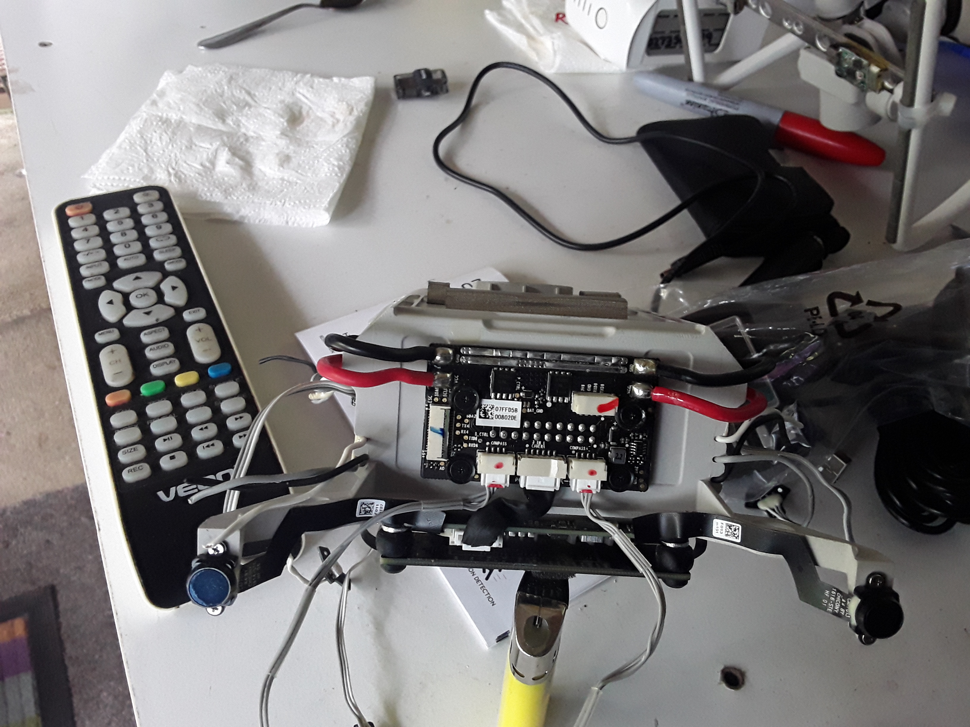

No you not pester me,,no expert on avionics either or electronics,,I'm thinking you could try replacing the red and black wires with some new wire to start with before replacement of power module.is that where your problem located with multimeter,,,I do have this part if you cant find a local one,,give those red and black wires good wiggle around and magnifying glass on board to check for burns or visible unusual marking
No you not pester me,,no expert on avionics either or electronics,,I'm thinking you could try replacing the red and black wires with some new wire to start with before replacement of power module.is that where your problem located with multimeter,,,I do have this part if you cant find a local one,,give those red and black wires good wiggle around and magnifying glass on board to check for burns or visible unusual markingView attachment 114965
I'll reflow the solder and check with a multimeter for any breaks on the power leads. I believe some where on that board is where the issue is. Just very odd that the board has to be supplied power for a few minutes before sending the power to the main board and flight controller.
I tested this by unhooking all the ribbon cables except the 3in1 wire from the power board to the 3in1 and I still received power after a few minutes.
I respect the test by plugging in all the ribbon cables but leaving the 3 in 1 power wire disconnected and I got power to the imu and esc after a few minutes.
This is what to lead me to believe it's either the board or like you said the wires on the board.
