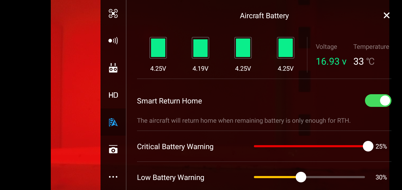

You can check batt health with 5 sec press on battery power button,,,if 4 lights come up batt cell have good health,3 and 2 lights battery tires or something going on with it,,,,you could give it a imu calibration and a gimble calibration to see if it help

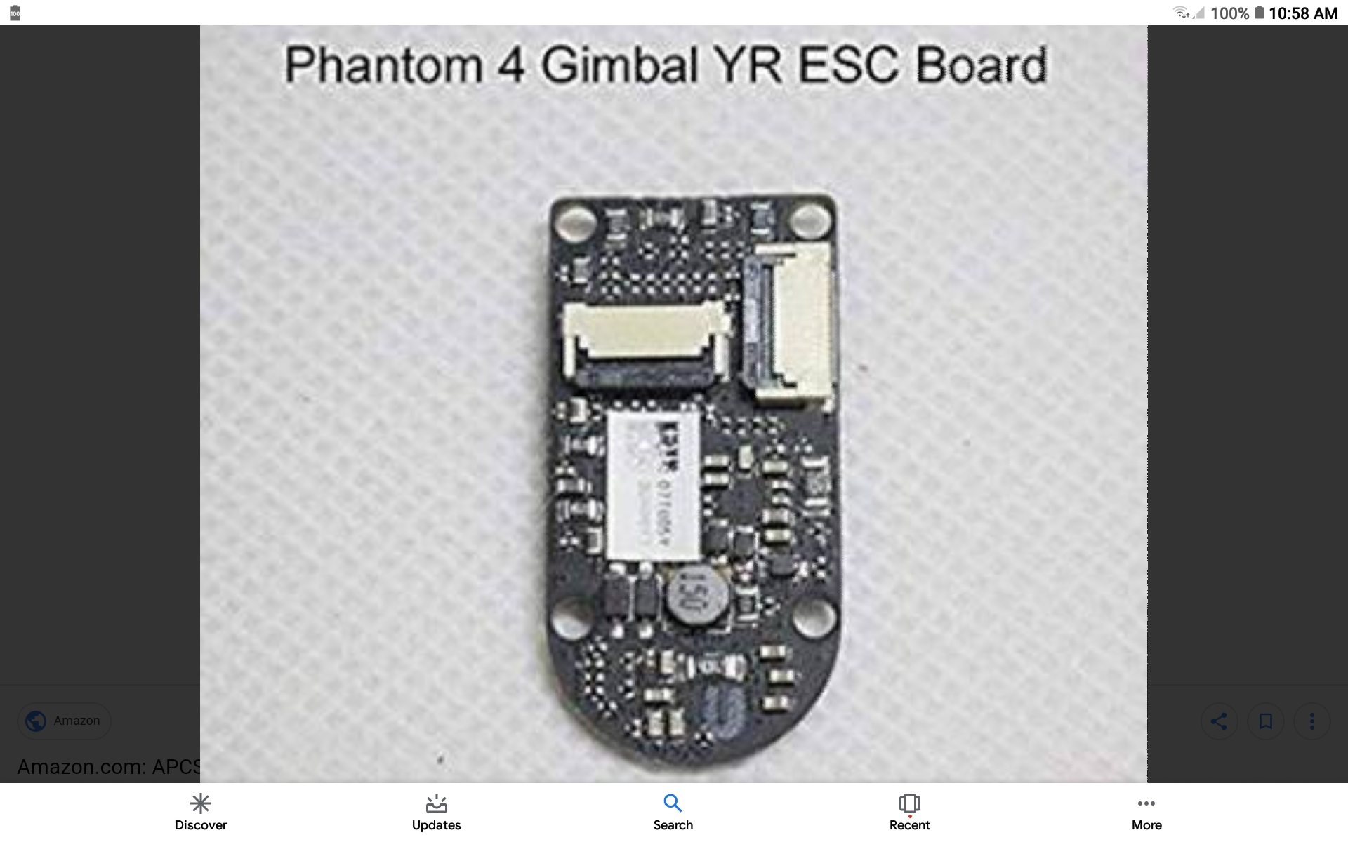

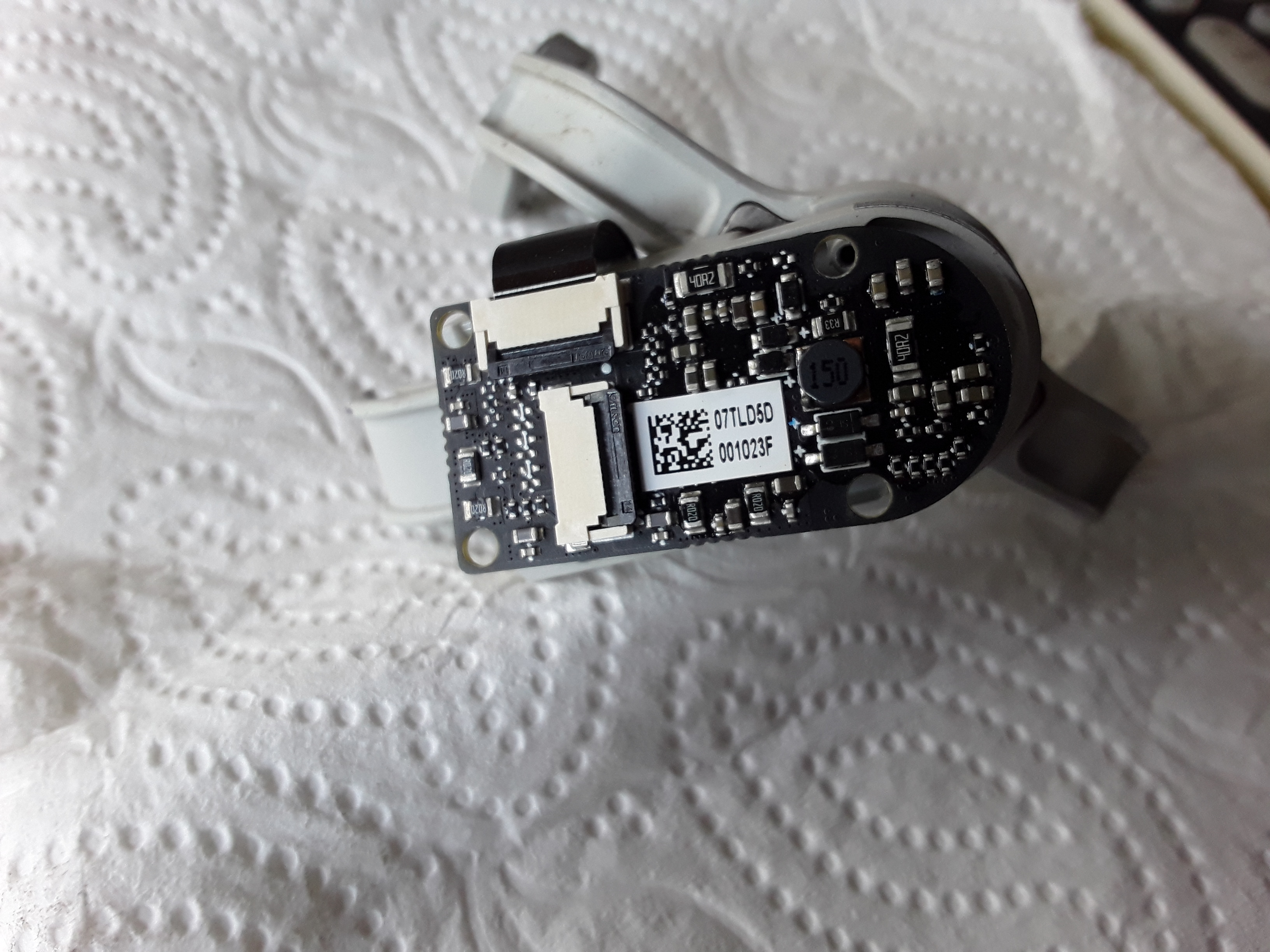

Ok I'm trying to eliminate things in my head,,why did ribbons get changed,,is this because of the gimble dance and esc start up delay,,,no crashes ay,,if just happen like out of the blue it could be esc board on the gimble has gone bad,,,have you checked this for burning smell or defections,,,I been searching on this and hard to find anything without replacement of bits
What's your location ,,I do have a spare ecs gimble board but me to ship from here take ages depending where you are,,,,no charge for this I do it for free to get you sorted again,,but check local first ,you might find one close to you so no waiting for parts to arrive

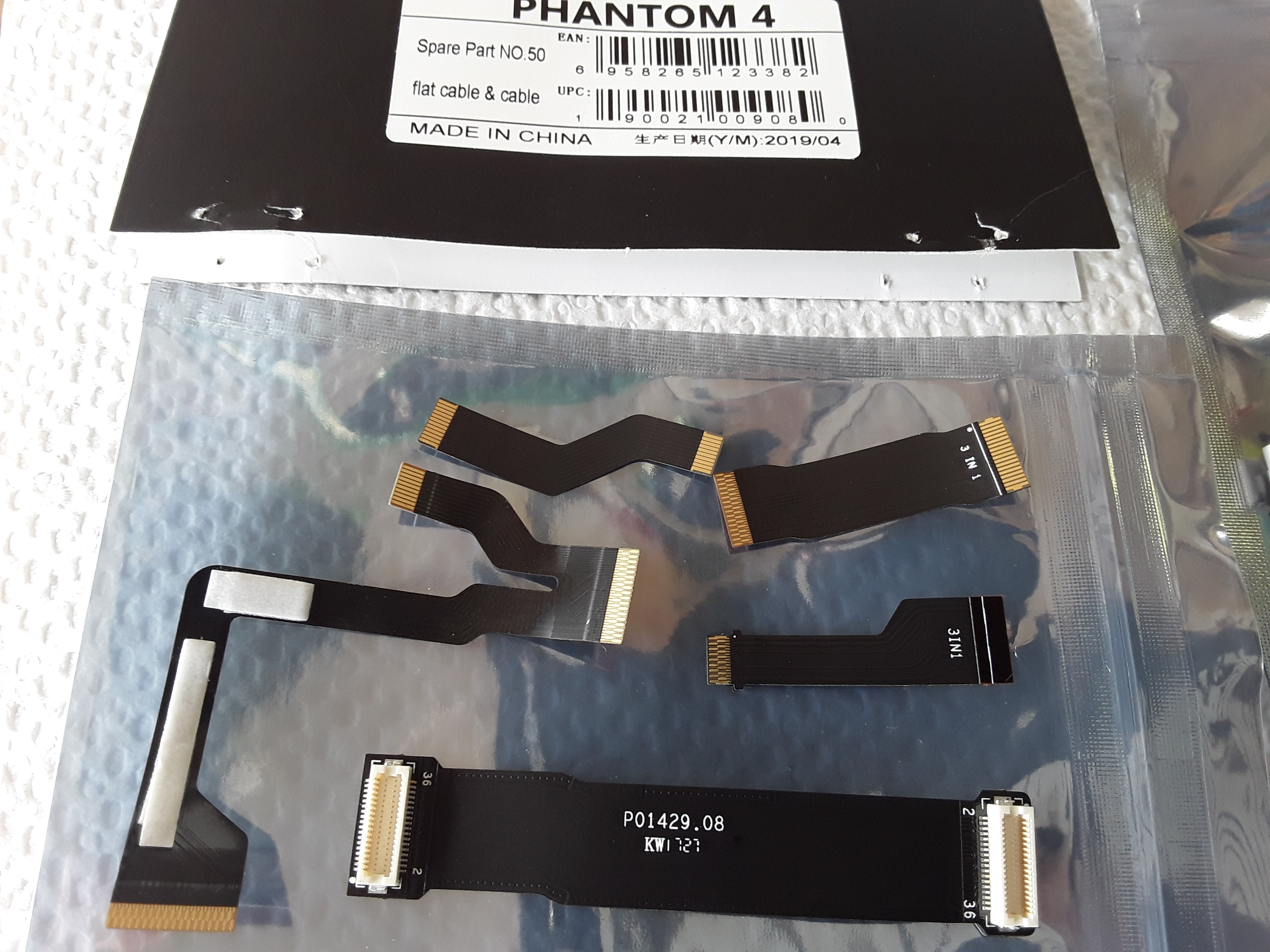

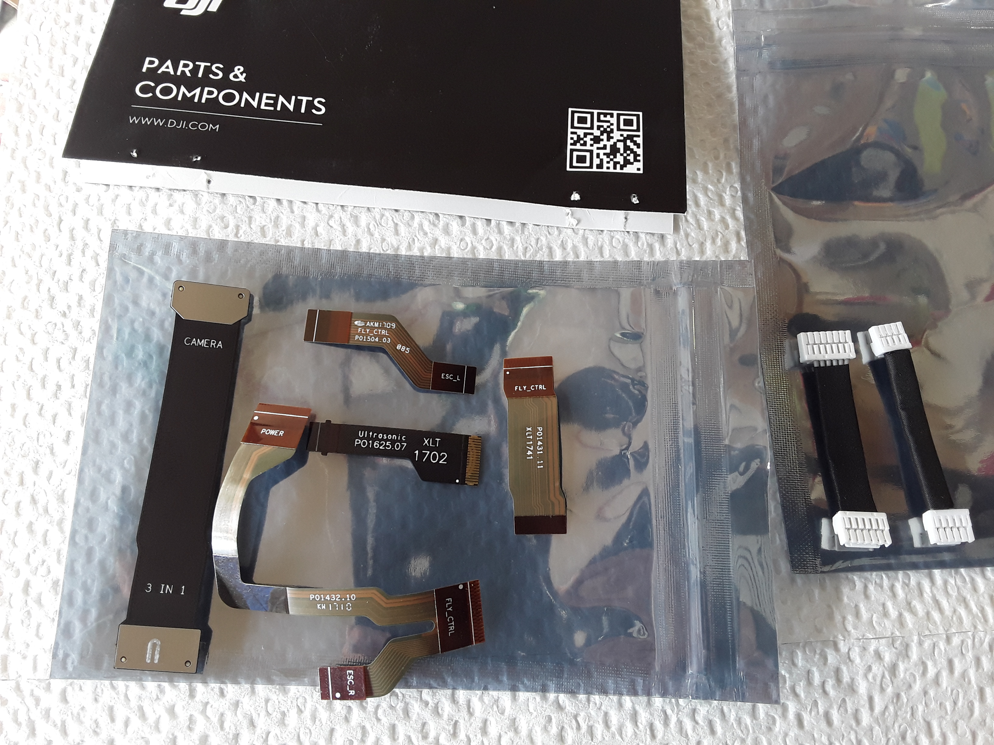

It's always bit hard getting these bargains could be anything but your flying so that good,,its not major,,I dig my ribbon set out and take picture so you can compare if your set of ribbons,,as said before some cheap sets just wont work properly and could be causing this,
Ok that good then ,,I be looking at that esc board,,you can only try ,,put it on list of things to get,,,I don't think they expensive,but if get stuck on one just tell out and PM your shipping address and I post mine to you but that take at least 10 days tracked at no charge,me has few spares lying around,,pretty safe I shipped bits all over the world,good fun and happy to help if get stuck:)
