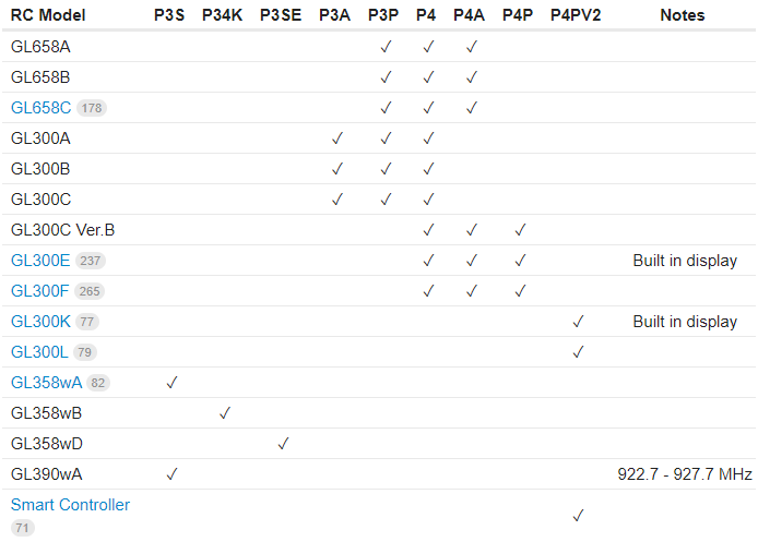

That's why I maintain that list of compatible remote controllers. I don't want to see other people accidentally buy something that's not compatible.
FWIW, I own both the P4P and GL300C Ver.B remote controller. I know from experience that it's definitely compatible.
Thank you. That is my lesson for the day. Which models came with the ver.b? P4A?
Thanks again. Glad you guys are here to step in and correct me. I seem to learn better that way, but it’s not helpful when I give incorrect information. Can’t believe I missed that. The only ver.b I had went with a 4A I sold.
Stuck my foot in my mouth on that one.

Msinger, your list of compatibile controllers for the P4v2 includes the smart controller
Is it out of beta?
I didn't know it was ever in beta.
Is it out of beta?
As far as I know, the last public release was v01.00.0530 in April. The beta version released in June (v01.00.0565) is the one which added support for the P4Pv2 to the SMART controller. That is when I added the SMART controller to my Controller Compatibility Chart with a note about the RC needing v01.00.0565 or later to work with a P4Pv2.
If something has changed to what I noted above, please let me know so that I can edit my Controller Compatibility Chart. Thanks. :)
