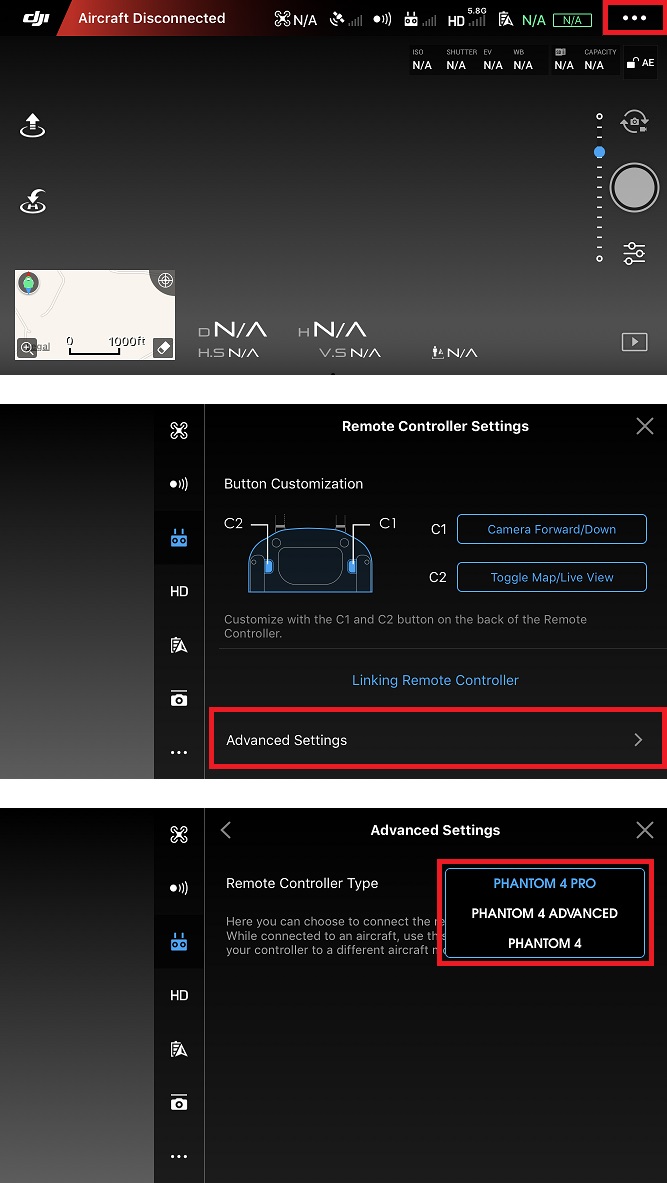

Did you try linking your P4P remote controller and P4P+ remote controller to your P4A? Both linked okay for me.
Make sure you change the Remote Controller Type in the following section of DJI GO before attempting to link the remote controller to your P4A:
You know, I read something similar to that, without the screenshots, and thought they were just referring to the drone selection on the first page! Wish I knew of this before I returned that GL300F!
No wonder I didn't see it - it wasn't there on the IOS version....unless it appears only after linking is started, but I also hit 'link' with no drone present, and still don't see it. It seems I only choose the model on the opening page. Well, SECOND page if you consider the goldfish page the opening page....and thanks for reply!

I admit to being a newbie, but I've seen a lot of forums. I'm afraid a lot of people are blowing smoke. DJI informed me that the Phantom 4 A requires a GL300C Version B. Those screenshots look photoshopped - the only place you can choose the model is on the opening page of the software. Not trying to stir s*** here - just the facts. I've tried 2 different controllers that folks have said will work with the P4A. No. Doesn't work. The P4A seems to be a bit of a bastard child - a decent drone, but requires particular accessories in many cases. So there is no controller to use other than the GL300C ver b. Just accept it. If you want more range, mod your controller and kiss your warranty goodby. Do it right, don't screw it up, and it won't be a problem. I've gotten to 14,880 ft, and I'm looking to do better. The battery should be the main range limiting factor after my next mod. I'm in the Ohio Valley and working with varied terrain, although I'm on high ground. Notice something from my old CB radio days - signals seem to like traveling over water - I'm getting my best range by going down river, even though it's not a straight line. Love the experimenting and looking forward to getting a set of amps.

The GL300E and GL300F are the only remote controllers that will work for me. They both definitely work (I own both and have linked them).
If you're using them with a Phantom 4 Advanced, I'd like to know how you linked them.
Yes, I'm linking my P4P and P4P+ remote controllers to my P4A.
Follow these steps:
1) Power on the remote controller and change the "Remote Controller Type" setting to "Phantom 4 Advanced" in DJI GO (see my screenshot above).
2) Power off the remote controller and power it back on.
3) Link the remote controller to the P4A (like you link any P4 remote controller).
