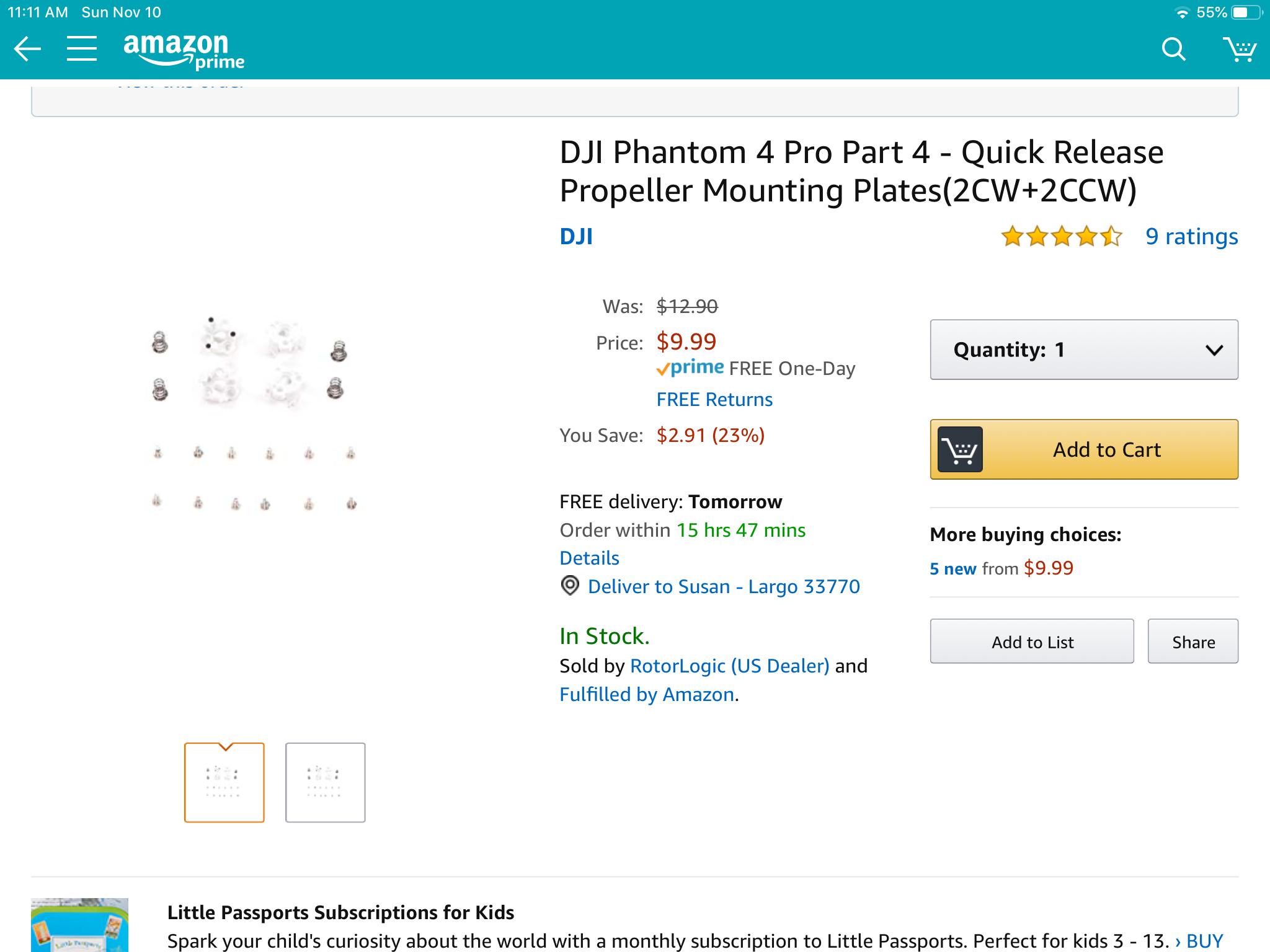

The prop hubs should be changed if they don’t have the coil spring style hubs already on the motors. No coil spring, no good. Here’s the link to what you should have. There could be another source besides this one, if someone else knows, please respond.
