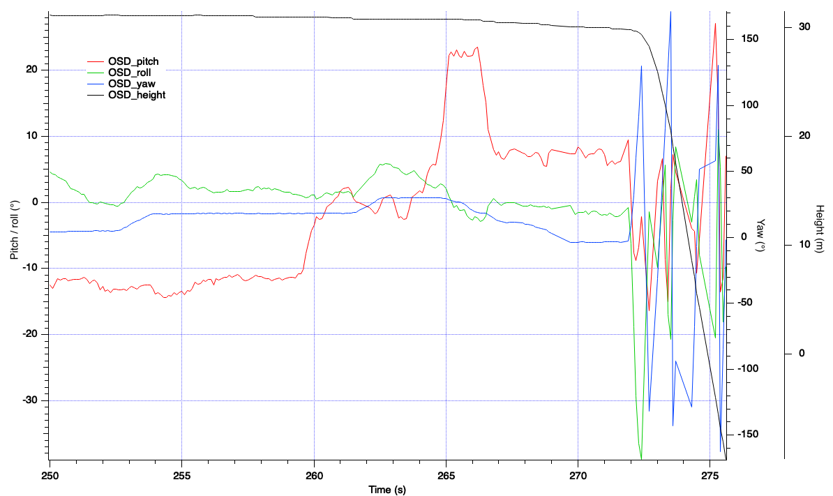

It looks like it lost a prop or suffered motor failure:
112654
The mobile device DAT file or the aircraft DAT file (when you recover it) - FLY104.DAT - will show exactly what happened.

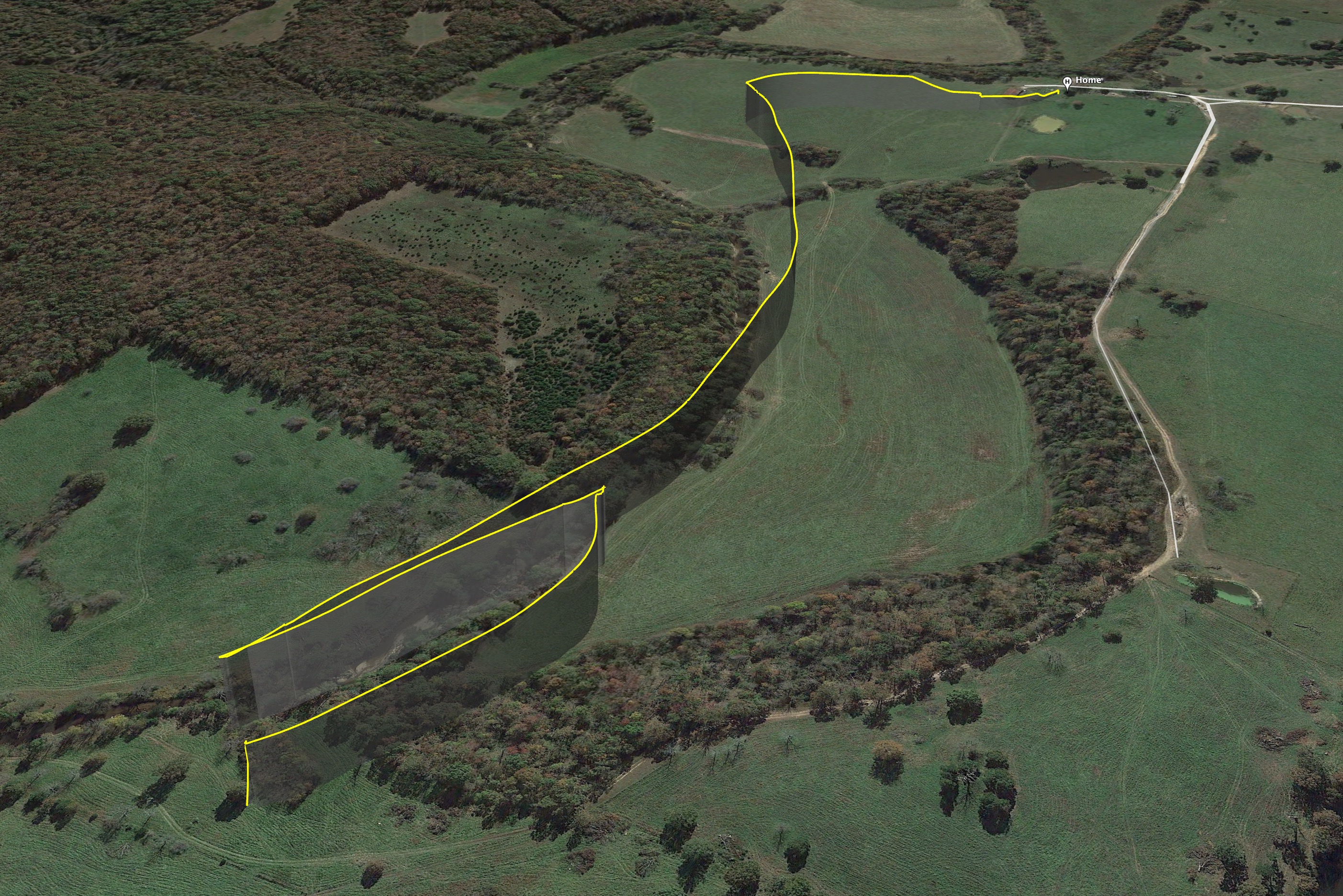

As for where it ended up - that's in the log:
112655
112656

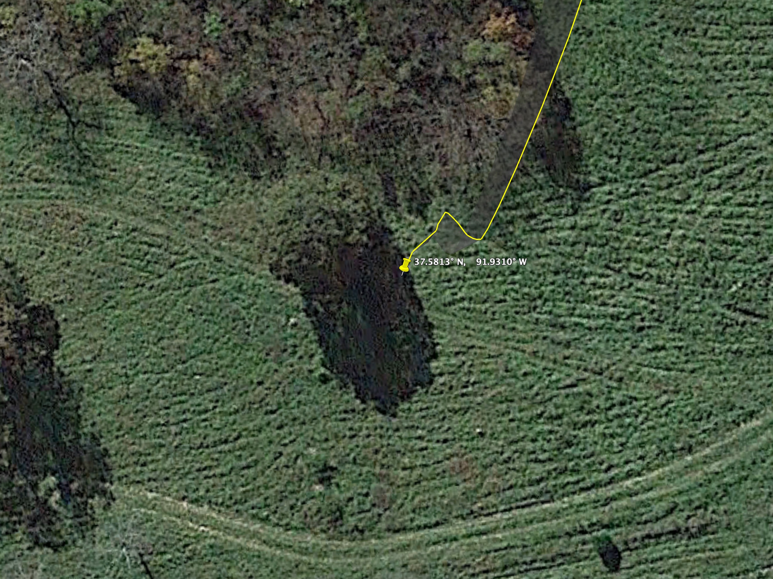

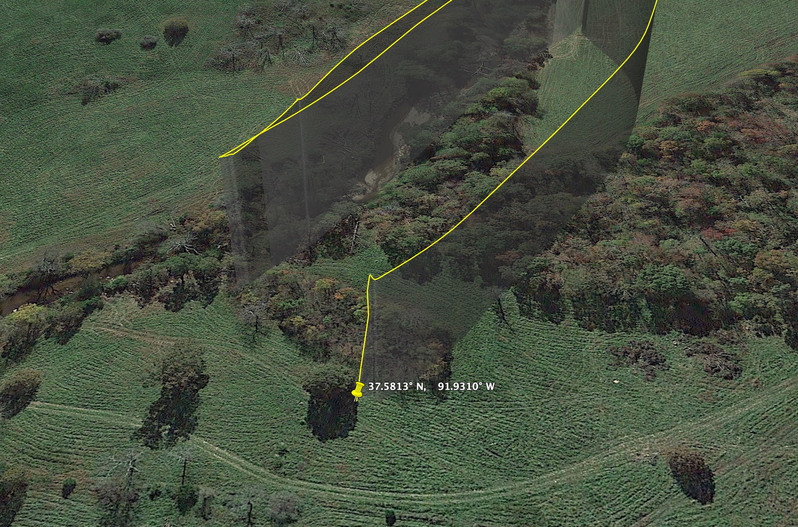

if I read that chart correctly it’s on the ground, correct? We’ve been back in this area and have seen nothing. What is the typical radius we should expand our search?
It's going to be within 10 meters of those coordinates. It might be in that tree.

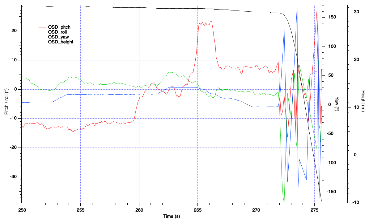

The above chart shows the black line ending at a height of “0”.... that doesn’t mean on the ground?
Not necessarily so. You have to take the altitude with a "grain of salt". It can be off somewhat.
It's not quite that simple. Firstly, you are looking at the wrong axis - the final recorded height is -9.7 meters as shown on the second RH axis. But that's above the takeoff elevation, which was 356 meters AMSL according to the Google Earth DEM. The ground elevation where it landed is 350 meters AMSL, so the expected height reading on the ground there would be -6 meters. The -9.7 meters value is within expected error margins and does suggest ground level, but I would not assume that, especially after a crash landing.
