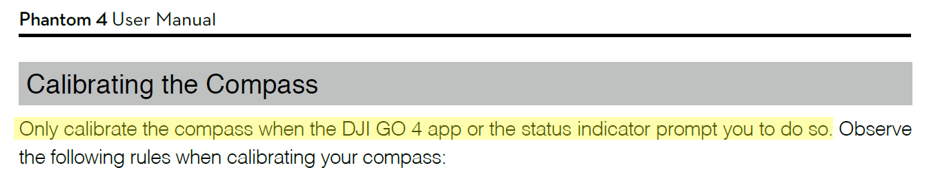

FYI: Compass calibration is not needed most flights= nonissue

I have changed positions 800 miles and had no reason to calibrate. You do not have to do a compass calibration unless the app says that you have to. I always check though.

so am I and most of the people that know on this forum. There are many conflicting statements from DJI and that's a fact.
Good luck with that. I am going with the guys that worked at DJI and they said to do it.
Obviously whomever you spoke with never read the P4 manual.
I trust the folks here way better than DJI
That's the problem with the DJI advice - it keeps changing, both in the manuals for the various aircraft and advice given by their employees. And while they certainly ought to know how their aircraft are programmed and operate better than any of us, the "calibrate when you change location" strategy has no apparent foundation in basic physics. That has led most of us to conclude that it's either not really about location per se, or, especially in view of their conflicting advice, that it's a miscommunication/misunderstanding between their engineering department and some of the technical support/manual writing departments.
