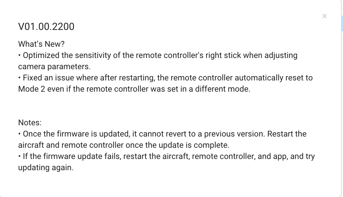

Hopefully, this is the fix. There has just been released a firmware fix
I'm doing it now
Awesome! When did this firmware become available? I did all updates before my flight and it was the worst it ever performed. I will do new update today hopefully it works. Thanks for sharing.
Yes... the firmware update only just got released yesterday. The wheel camera adjustments are now fixed.
I have not had a fly as yet, but I took some pictures inside. All good
Did the update, all good here
