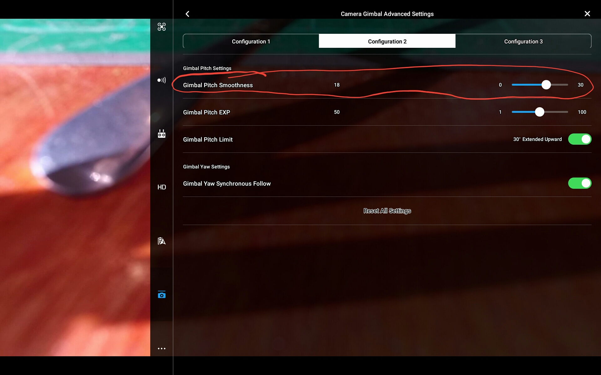

See if any changein gimble wheel speed helps it slow down buffer
See if any changein gimble wheel speed helps it not jumpView attachment 104084
Hmm. Worth a try.
Although none of my other settings changed that I noticed.
WB, custom style settings, etc. on camera.
But I didn’t check the advanced settings like for Gimbal & such.
When I get home I will look.
Thx
UPDATE- The Gimbal Pitch smoothness has nothing to do with my issue.
I have that set very low for smooth Up/Down panning on Left finger wheel. Works fine.
It's the Right side finger wheel - and I just figured out whats happening.
The click stops are jumping more than a stop for each click.
Whether its for Shutter, aperture or ISO, it makes a huge sum on the "clicks" - but if I rotate the wheel slowly I can see the 1/3 stop increments change.
But it's imprecise and could jump while shooting or trying to get specific settings between frames.
Does anyone know if a controller can be fixed if the adjustment wheels are slipping like this - or does that mean that part is broken irreparably?
