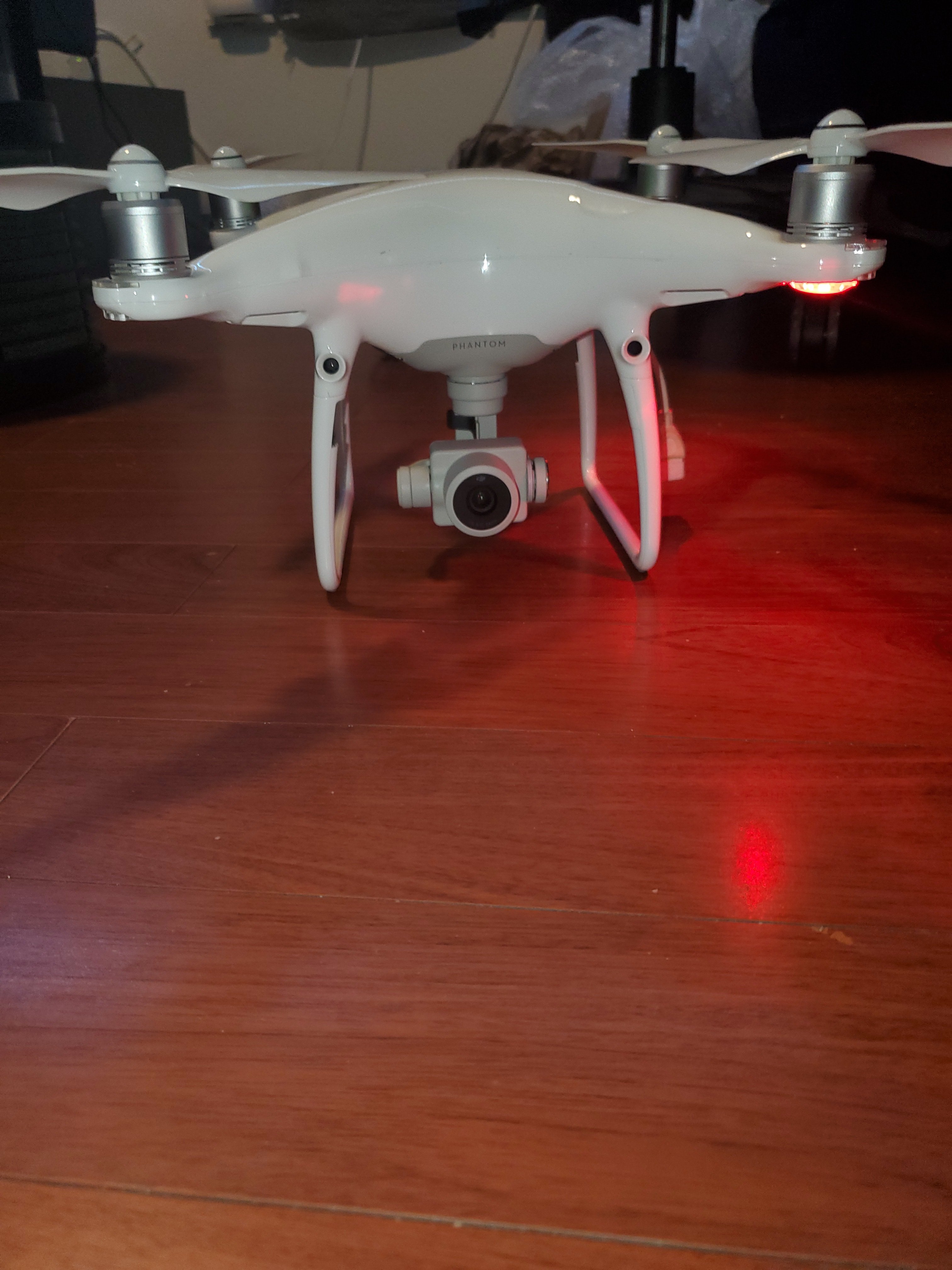

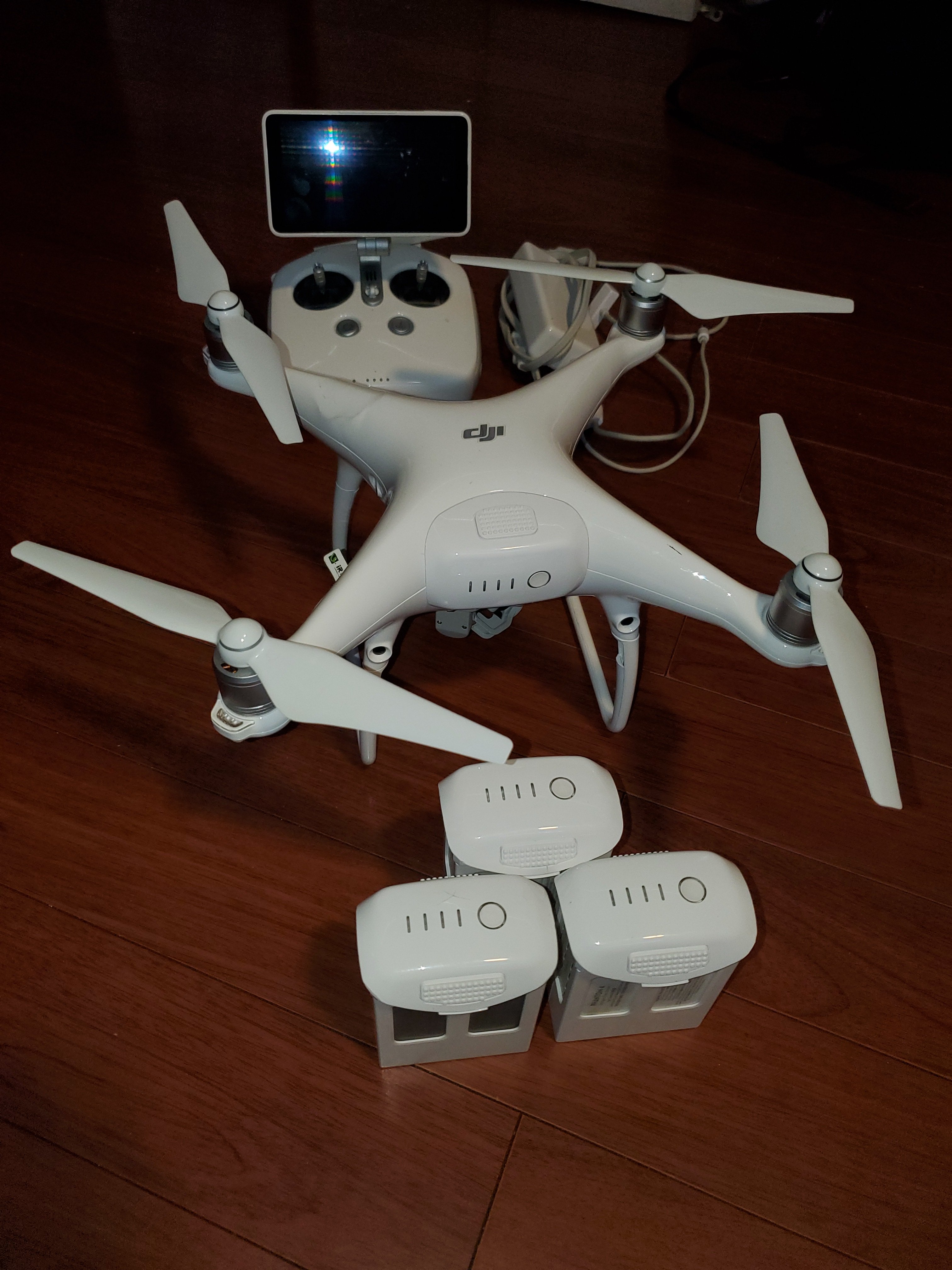

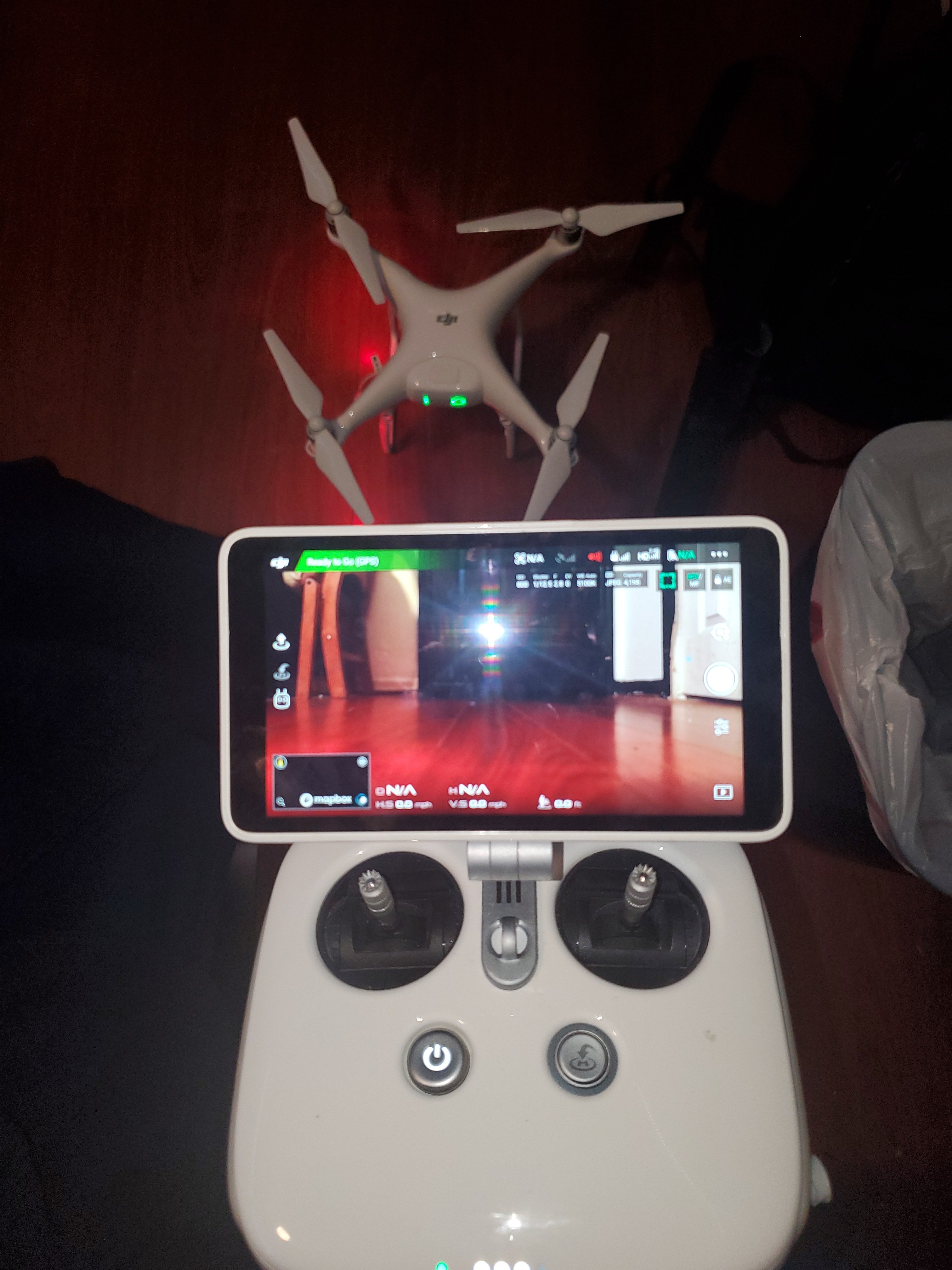

Hello, I was gifted a crash Phantom 4 pro V 2.0 When I turn the drone it self on a red and green light flashes for a few sec and then 2 solid red lights at the same time its beeping continuously. the original owner let the camera hit something and broke off. I replaced the camera it showed up on the remote normal and it seems to respond ok but I tried a Firmware update and it errors out at 34% DJI told me send it in but I would rather fix it my self any ideas I would greatly appreciate it (Remote firmware update normal)

I did the firmware update on both control and drone the control completed put the drone stop at 34%

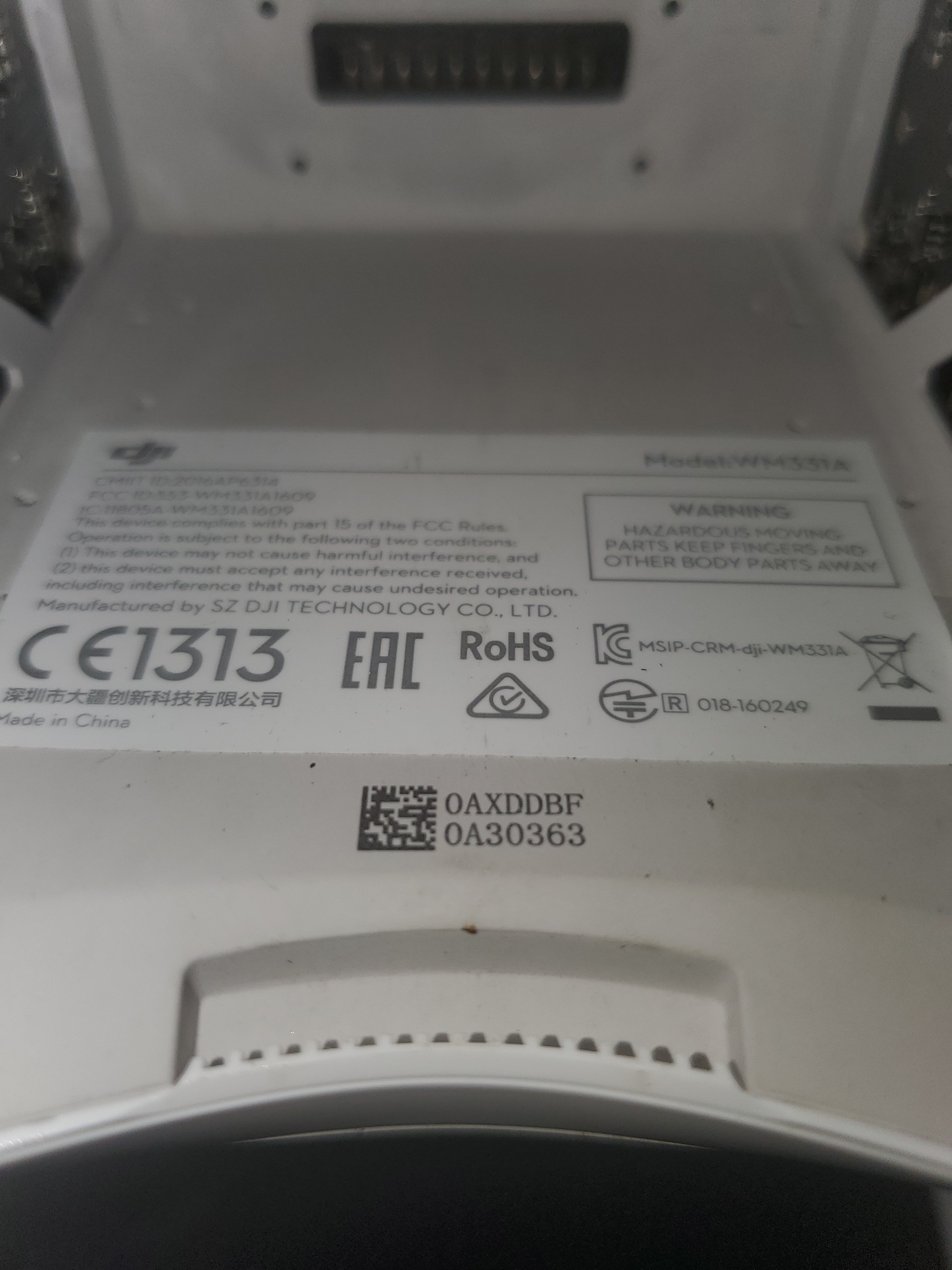

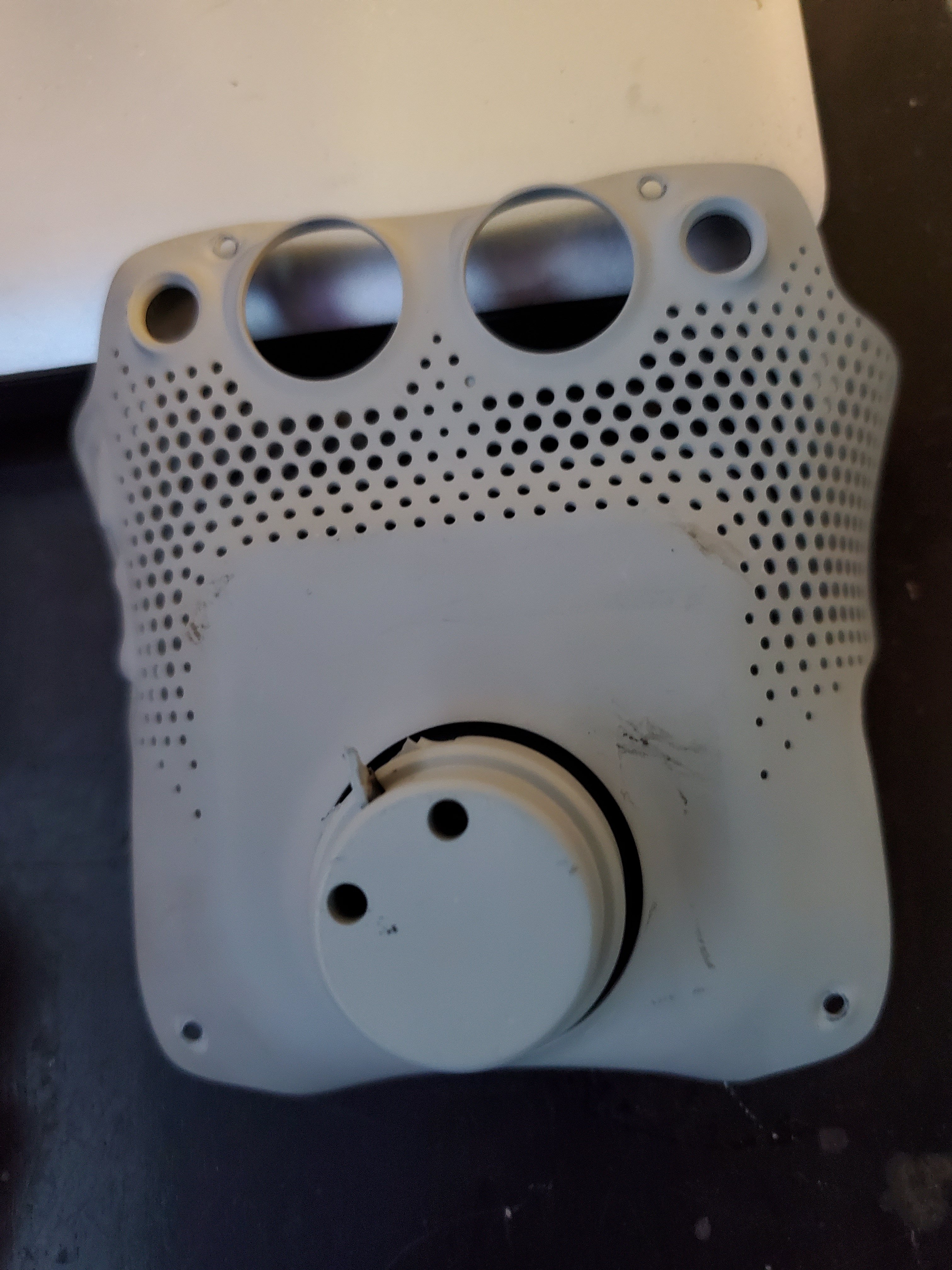

You have a phantom4 pro plus V1. Should read GL300 E on the controller. Based on these pictures, this aircraft took a very hard hit.
It is possible that some form of repair will resolve the issue that you’re having, but probably will need more than what you can provide. Do you have the rest of the original camera?
@illistmike80 - As noted, it’s not a V2. WM331A is the model number for the P4P. I believe the V2 is WM331S if I recall correctly.
