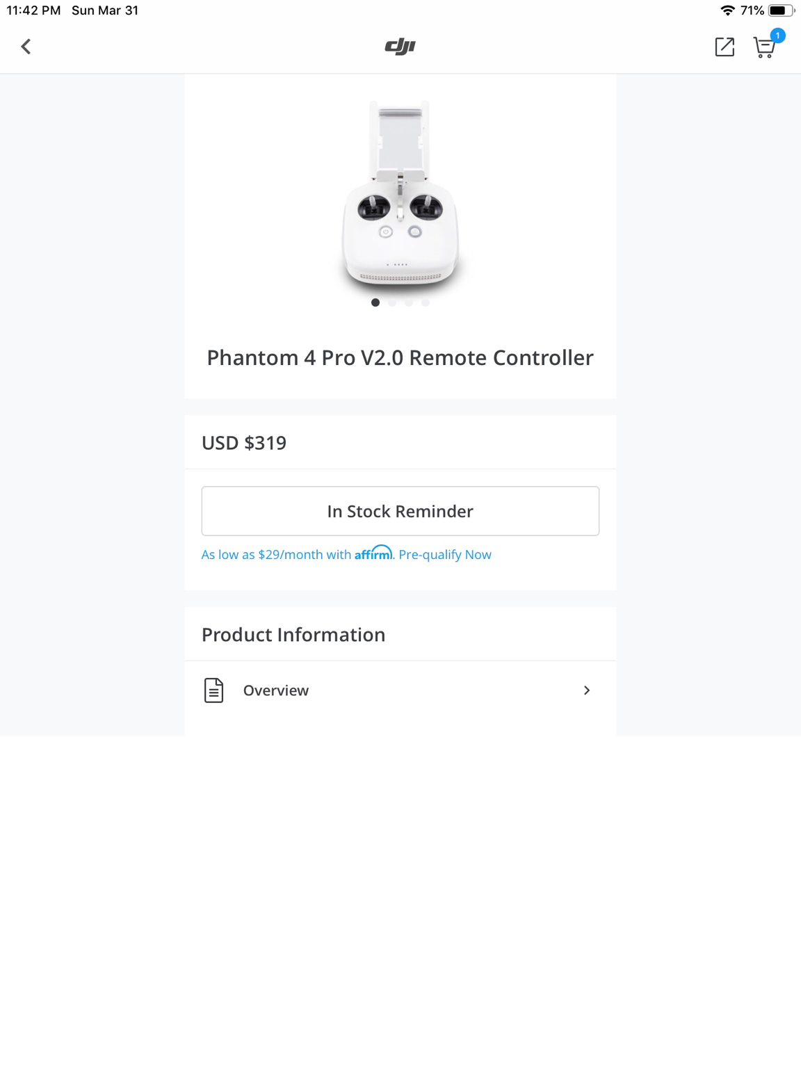

This is a common question from owners of the Plus controller (v1 or v2). Since the version of Android on the controller does not support the Play store, it is not something that will generally be "fixed" across the board for all 3rd party apps. If you need to install many 3rd party apps, it would be easier to obtain the regular Pro controller and use it with the tablet of your choice.
You can obtain the Pro controller and switch between the two controllers as you see fit. That is what I do with my Phantom 4 Pro. Pairing the controller I need for a specific flight only takes a few seconds and is very simple to do.

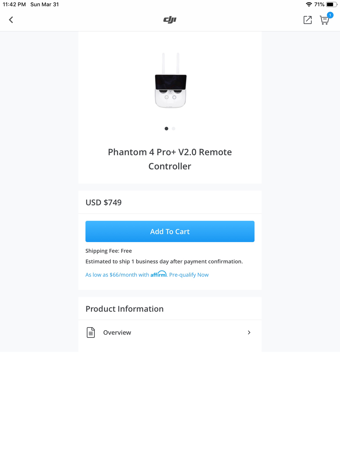

I'm sure you're right and I agree everything you said, the only problem is that GL300L cost a lot of money! :-)
And, another thing... in Italy you must register your drone also with the RC code, switching remote means that you've to register new from scratch :-(
