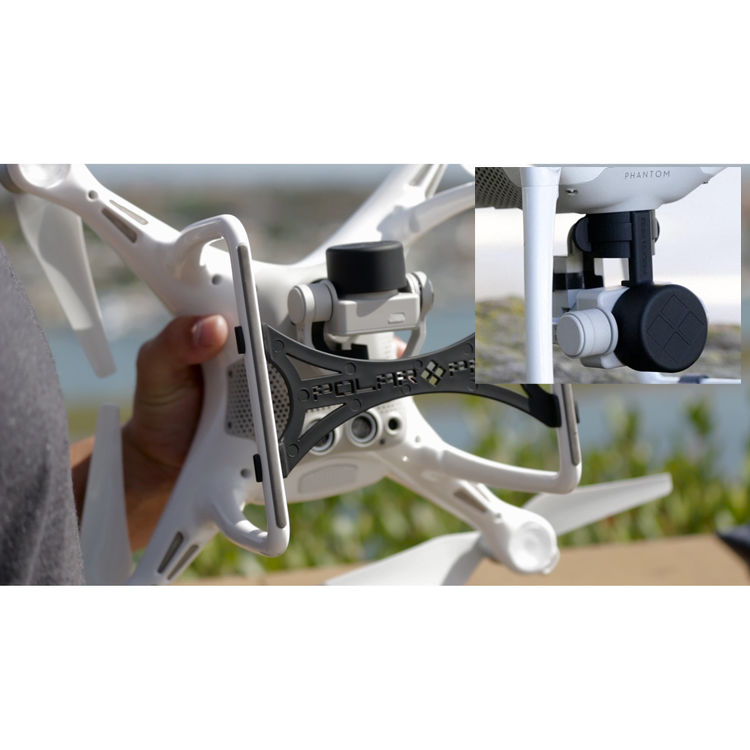

I will try this. We have a gimble guard for transport.
A guard for transport? Are you sure you don't mean a gimble lock? And agreed with @Meta4 on his suggestions as well. If it is a gimbal guard, that might fix the issue if it is not settings related.
He was talking about flying with a fixed plate below the VPS sensors - not the kind you put on after flying.

Upper Right....Gimbal Lock with Lens Cover
Larger Image...Gimbal Guard
Just for reference example
No fixed plate sorry. New to all of this. Thanks for all the help
