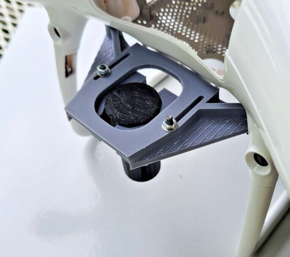

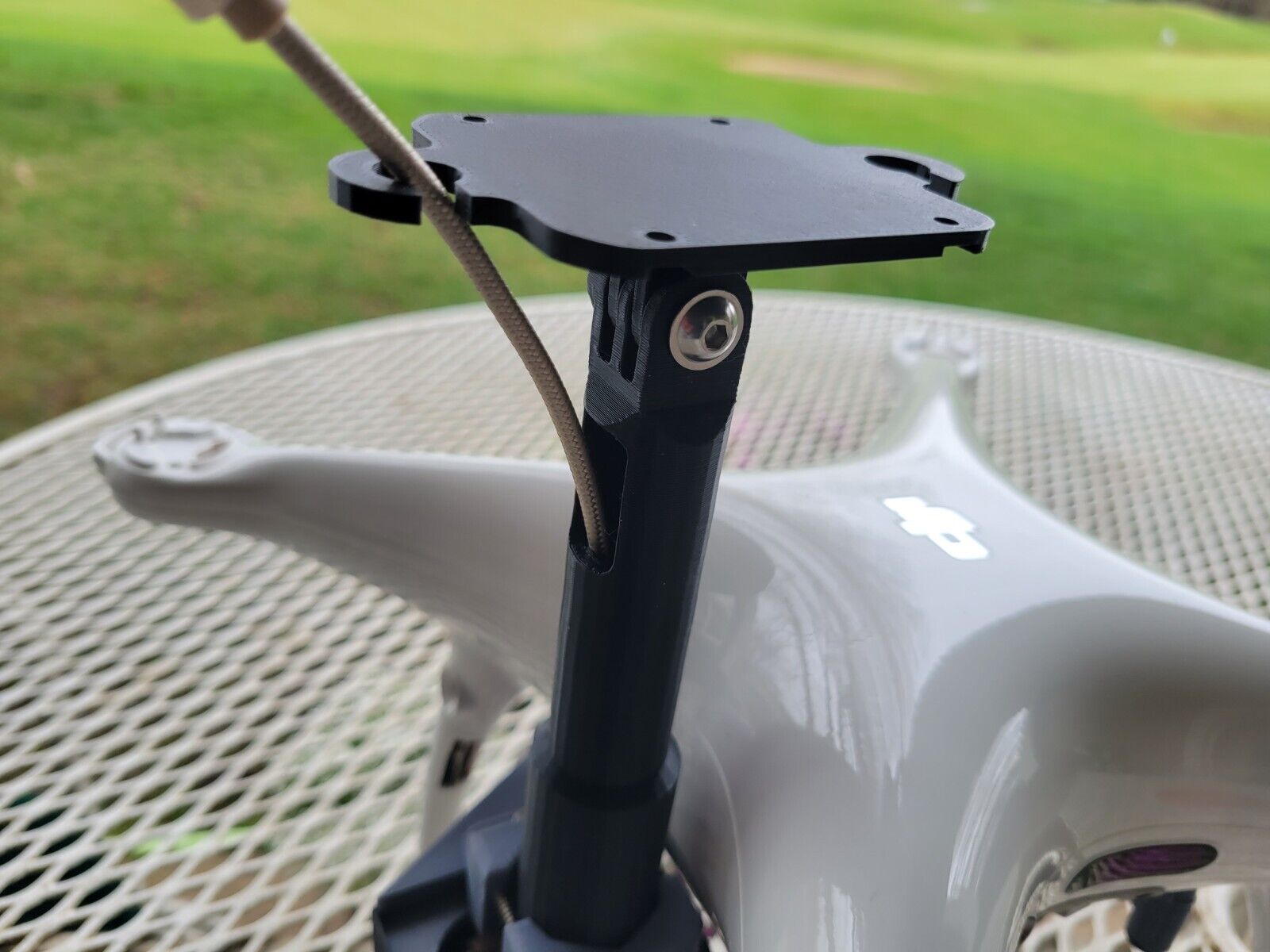

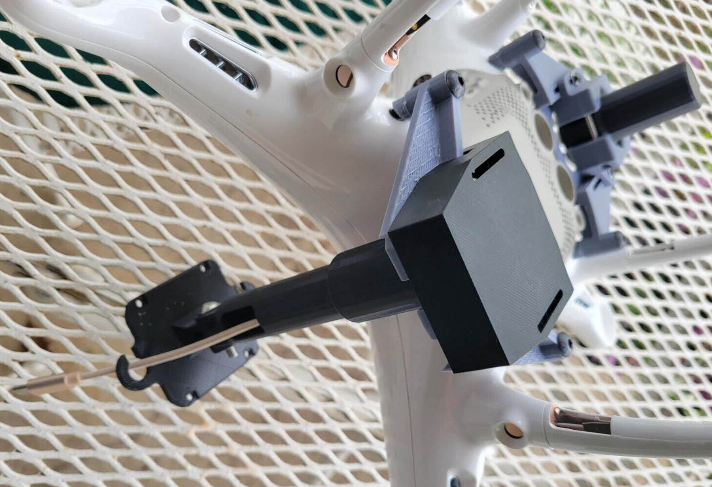

I have designed and made various P4 mounting systems over the past 6 years. Most are available on our site. If interested our ads are in the Mavic forum.
