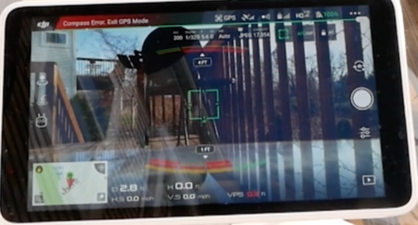

The problem is not with the drone, that is acting perfectly as to the magnetic Field.
What I call the True Magnetic Field will knock out the GPS mode and put it into atti mode and that is exactly what is happening.
So sending the drone back is not the answer, as you may do even worse on the next one.
I made this video showing how a real Magnetic field effects the drone and you can see the error message that I get as it kicks me out of GPS and into atti mode .
So the question is what you can you do.
We had a few clients that have Doubled up the Phantom Rain Wet Suit to try and protect the drone but I am not sure of the results , I would think it would not be enough to make a real difference but than again , you just need a few more feet.
Something to consider not as FIX but it will most likely get you a little closer to the tower before the Magnetic Field is to strong and knocks you out again.
Here is the Video I made showing exactly what is happening with your drone, it is a Demonstration . for some reason people kept asking why would I do that ? UGH
Im using the 509 firmware so the error message is more clear.
Watch how fast that Flash Error Message comes up:
Compass Error : Exit GPS mode
