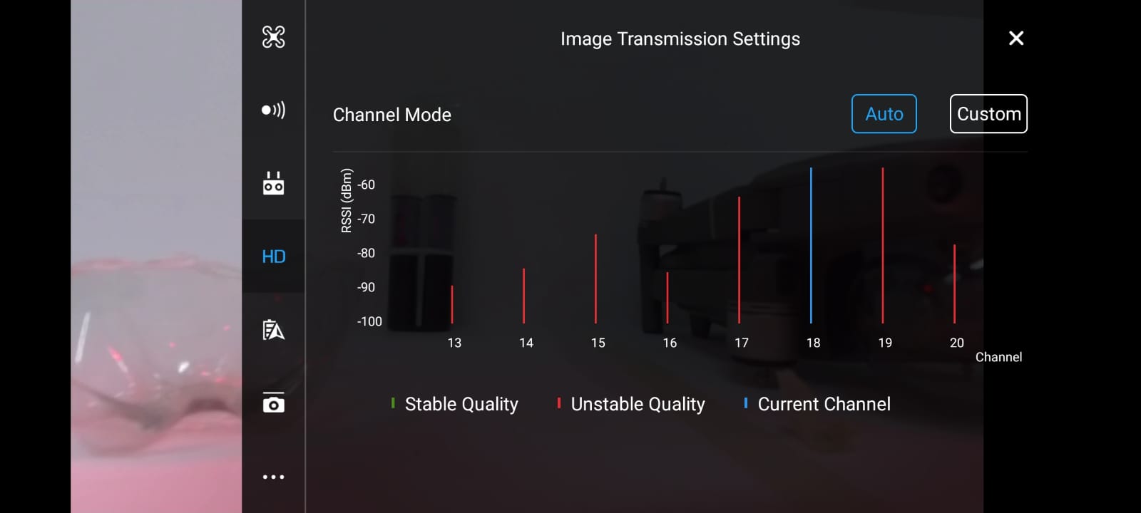

the version of my drone cant switch between 2.4Ghz and 5.8 GHz, only has 2.4GHz frecuency. all the channels shows unstable quality whether close or far away. thanks for your reply.

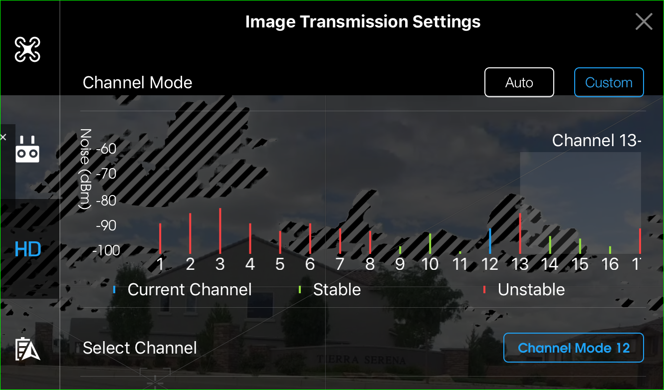

What does the RF interference in your area look like? WiFi has grown in popularity over the years. I find the original 8 channels is not enough and Auto Switching channels is nearly worthless. In some areas, finding a clear channel can be difficult. Regardless of how rural the area, I always make sure that I'm on a clear channel.
For this particular site, channel 12 was the clearest of the 32 channels.

Update. After searching on internet and don´t find an answers to my problem i dicided to try alternative solutions, i tried a specular surface signal booster but didnt work. other was cover the anthenas of the RC with aluminum, for my surprise worked very well. the signal before cover the anthenas was poor all the time, after the aluminum the signal improved. I haven't flown the drone yet so i cant say its a permanent solution, even so its impressive that it works.
If anyone knows why it works it would be very helpful to understand the problem.
here's the evidence.
So you didn't read the comments in your own thread when the answers and suggestions were handed to you on a silver platter???
And your "experiment" is highly flawed. All you did was attenuate the signal, which is clearly shown in the histogram that you clearly don't understand. An actual flight would flush this out.
