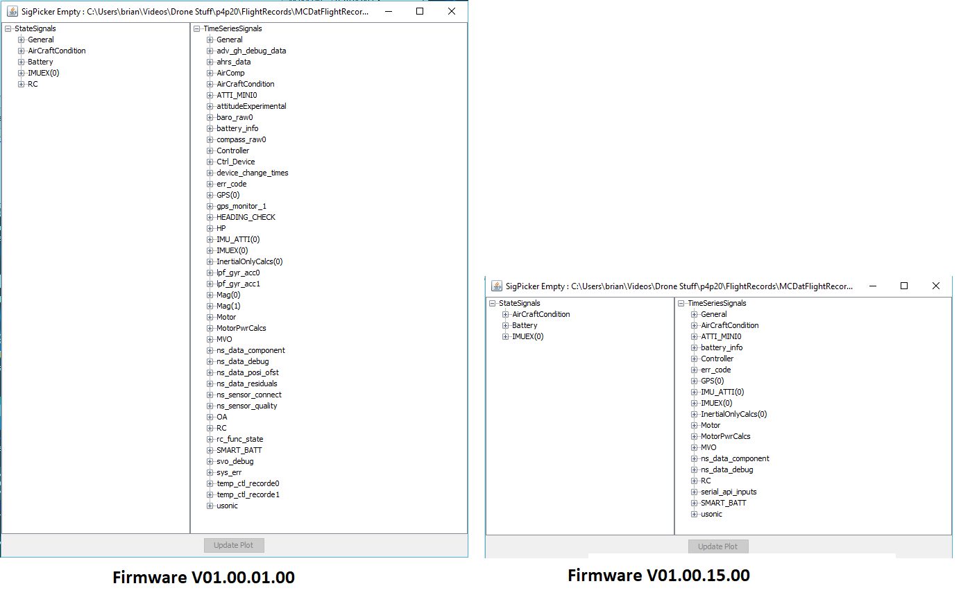

Hey @BudWalker and @sar104 ,
I noticed after the firmware update that many of the signals are missing from the log:
What do you log wizards make of this? Is DJI removing stuff they don't want us to see?

FLY044.DAT is too short and doesn't contain an instance of several record types. It also isn't long enough to contain several RecDefs. Try it with a larger .DAT from the latest FW.

I've been looking a little more. I hadn't seen that, although FLY044 is (very) small, the battery on time is 625 secs. You're right, there is a lot of stuff not being recorded with the new FW.
EDIT: In fact FLY044 looks like a .DAT that was retrieved from the tablet, not the P4P

Yes, these are all tablet files. I normally use them instead of the larger drone files unless I need something really detailed. All of the logs I have posted here in the past few months have been tablet DAT files.
This morning I flew another flight that was longer than FLY044 but still short because I had to go to work.
2018-06-27_07-10-32_FLY046.DAT
This one has the same missing data fields. In the past firmware, I could fly very short flights and still have all the normal data fields. I think they definitely removed some fields.
I will look into the drone files this evening to see if they also have been crippled.

So, FLY032 is a tablet .DAT? It's 70 MB. It looks like a .DAT that was retrieved from the P4P, not a tablet .DAT.
FLY044 has the fields that would be expected in the tablet .DAT.
If you want something that has more data, like FLY032, you'll need to use the P4P .DAT.

Yes,
All of the logs I have posted here are Tablet DAT files including FLY032. It was the oldest one on my tablet last night (prior firmware). The tablet seems to only keep the last 11 flight DAT files.
That is why I noticed the change when what I have normally seen available was not there after the firmware update.
I am convinced they removed the data fields from the tablet DAT files.
