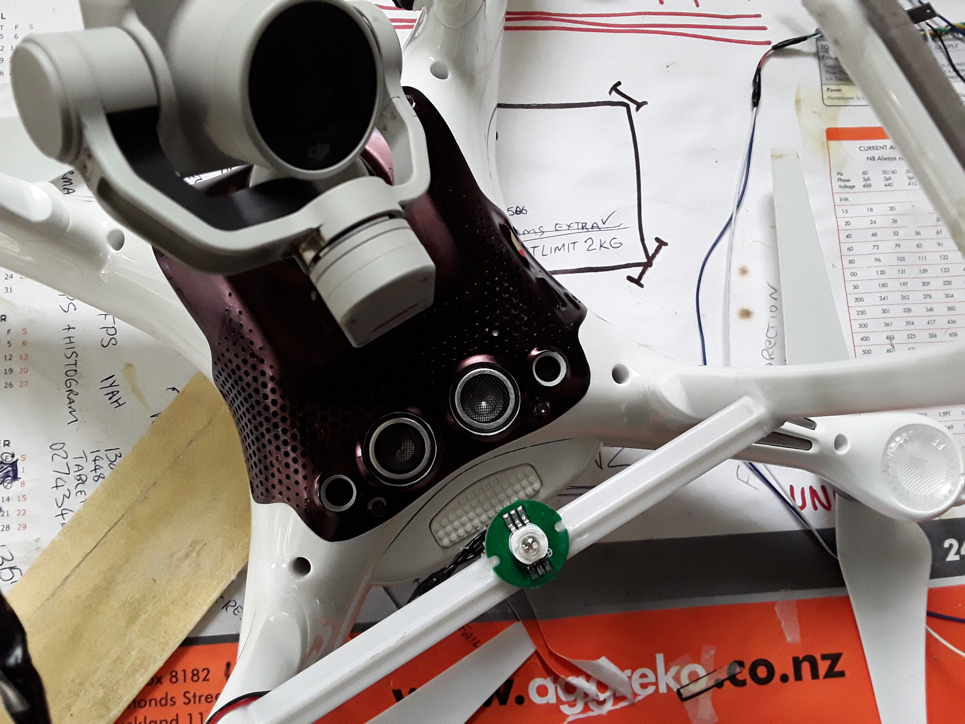

Noted. Quick question though, the VPS are the two small circles on towards the outer edge of the bottom correct? I don't believe I ever took off any plastic covers from them but I don't see any and the hole is too small to fit a finger in
1493766547679-1713532345.jpg outer edge ones are cameras,can't remember name,,front called monocular scans forward (OA),,speaker type give off sonar waves ,,,I think that right,Yeh other cameras scans down
Yes that's them, apart from ensuring they are not covered in dirt or similar debris, the only thing you can do is to recalibrate the sensors using the dji assistant tool. As @ianzone said, just launch and fire it up. The ground beneath may affect the VPS sensors and cause it to move around if it is featureless.
