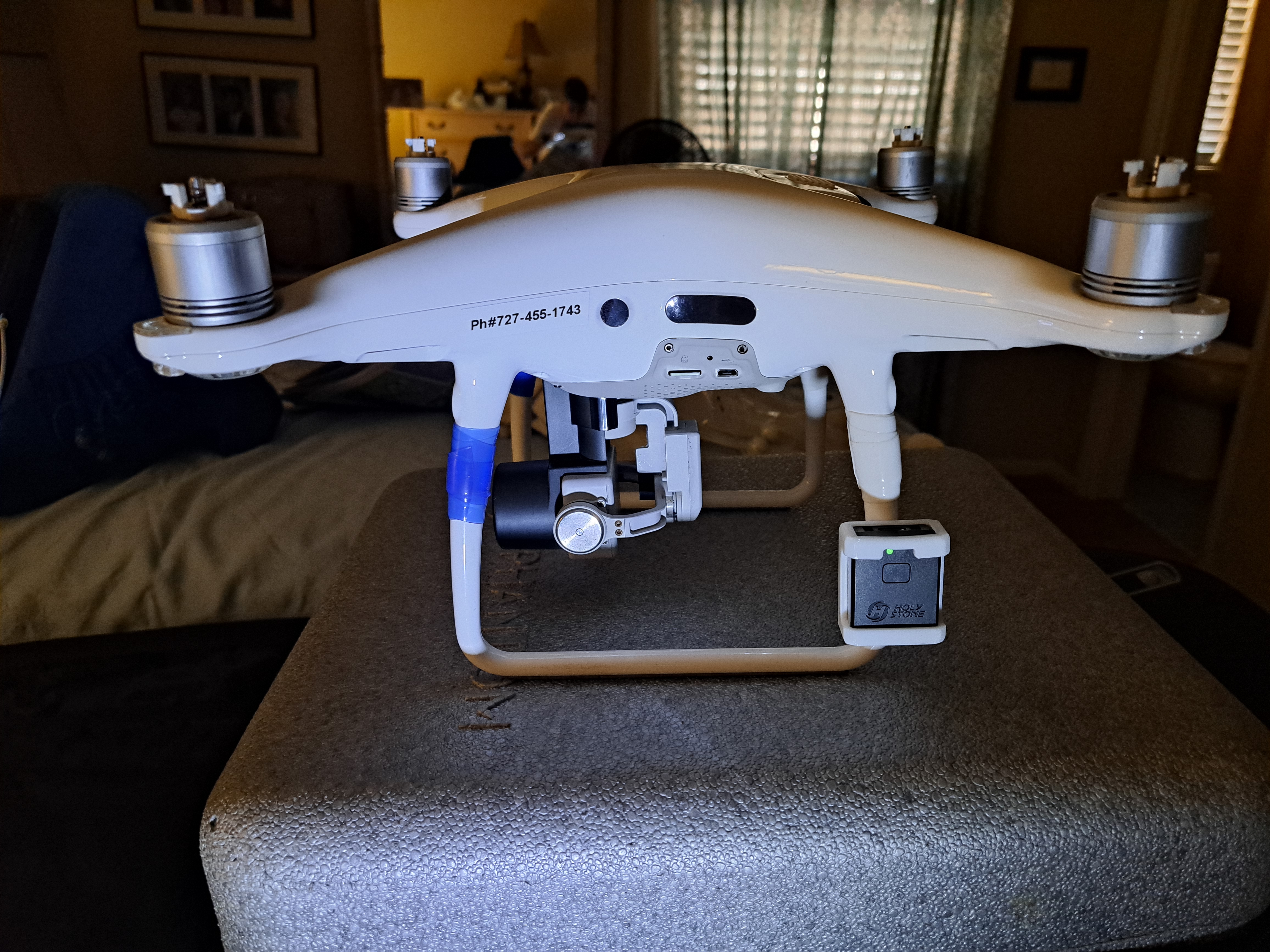

I was instructed to install my mount on lower rear legs and have no interference. Another posted a mount location between rear legs with a 3D printed mount shown. If your GPS works with no RID attached, your RID unit seems to be at fault.

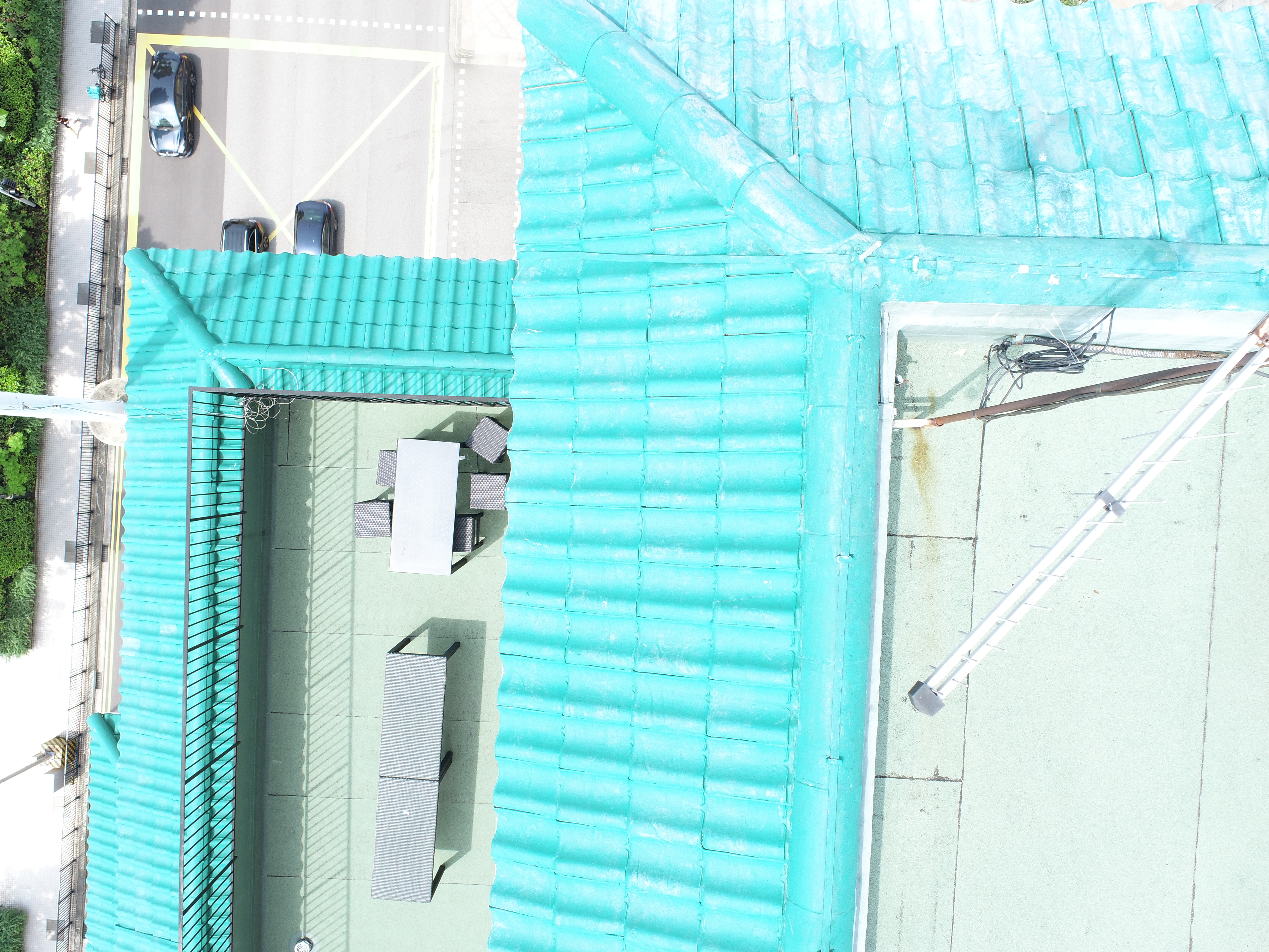

Thank you for the analysis. I have flown the Phantom both at the Marina Barrage and West Coast and have had no issues with GPS. In the last picture I find some antennas on the roof not accessible from the terrace. I am checking if any high-power broadcasting is interfering with the GPS.
