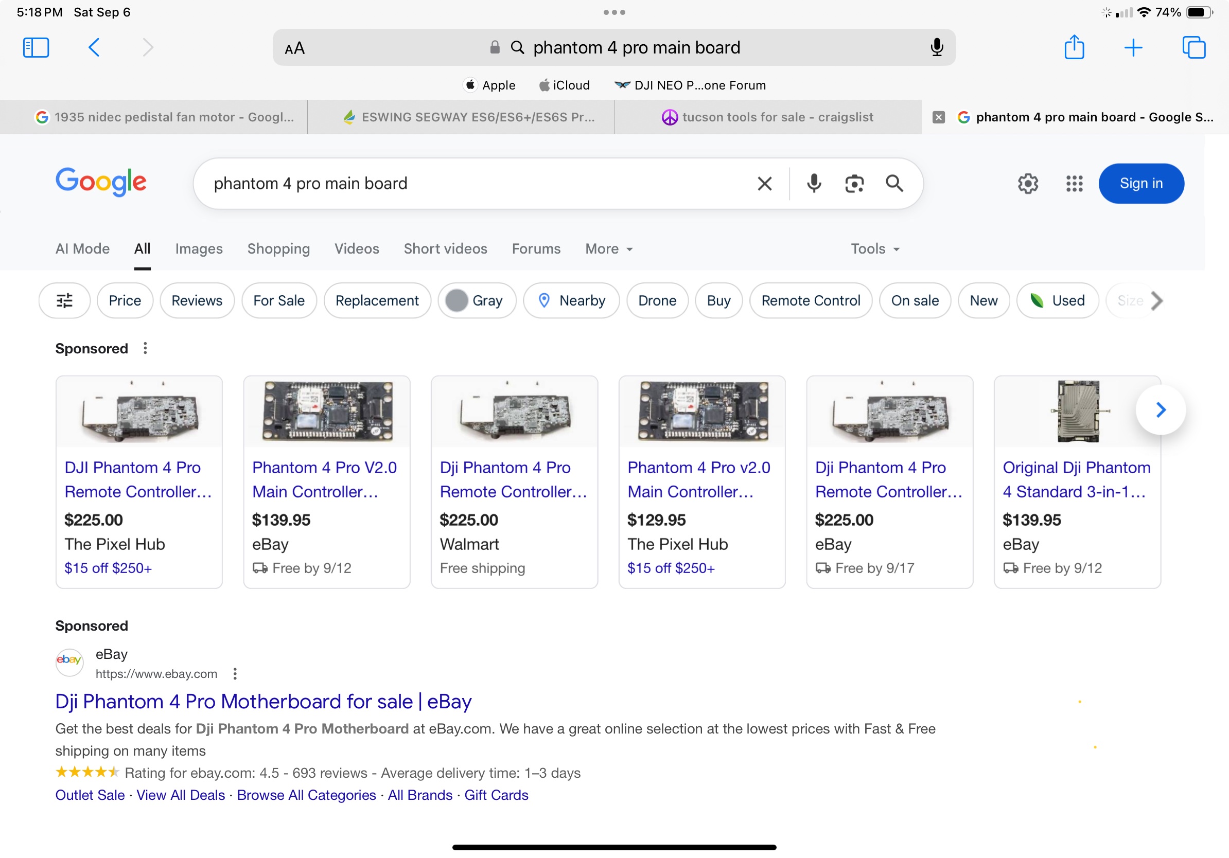

what search for what parts?
Depending on what part(s) you are trying to find(main board), just go to your search engine and type in Phantom 4 Pro _ _ _ _ _ _?
An example would be for a Phantom 4 Pro main board, this is what may come up.
