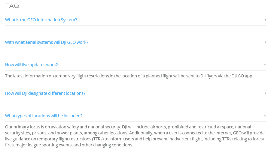

fberna, Do you think the info on DJI's site is wrong?

No one ever disagreed. The question that was asked is how does GEO use TFRs since it very clearly does work real time. So you didn't really answer the question.
It was explained to me that the TFRs are via the GO app when connected to internet. The app will send commands to the bird based on TFRs. In other words, no data is changed on the bird. But if you are in a temp no fly zone the GO app will send commands such as will not take off or forced landing etc.

You actually know more and better than the DJI folks who explained to me how the their system work, stating clearly that there are NO TFR loaded on the fly through DJI GO.
BTW, this would make the TFR system totally useless, as you can fly your drone with a wide range of other apps -Litchi, Altizure, Pilot Map and many other- without even starting DJI GO.
That's why, according to the DJI guy I was talking to for unlocking my airport red zone, the data is staying in the drone, so that any other software -which can "talk" to the drone via DJI API/sdk- must read the file and cannot get you in the air while inside a NFZ.
Apps which cannot use the unlock system, so when DJI unlock a red zone you are not able to use any mapping software to command the drone.

I think you are wrong. TFRs are regularly updated via GO (per DJI's web site). It's simple, GO checks the internet for app and TRF updates whenever it has access. Next time you connect to the bird it updates the data on the bird thus all apps using the API have access.
Why is this concept so hard to grasp?
Couldn't be any clearer to me. No update no geofencing file amendment. And the geofencing database fail resides in the drone, not in the app.
Why do you keep saying that when it's explained on the DJI website. Are they wrong?
At app is just used a conduit to pass the data over.
I have been saying that from the very beginning, but others argue that it is done in a transparent mode, while flying, without update, which according to DJI is not happening.
