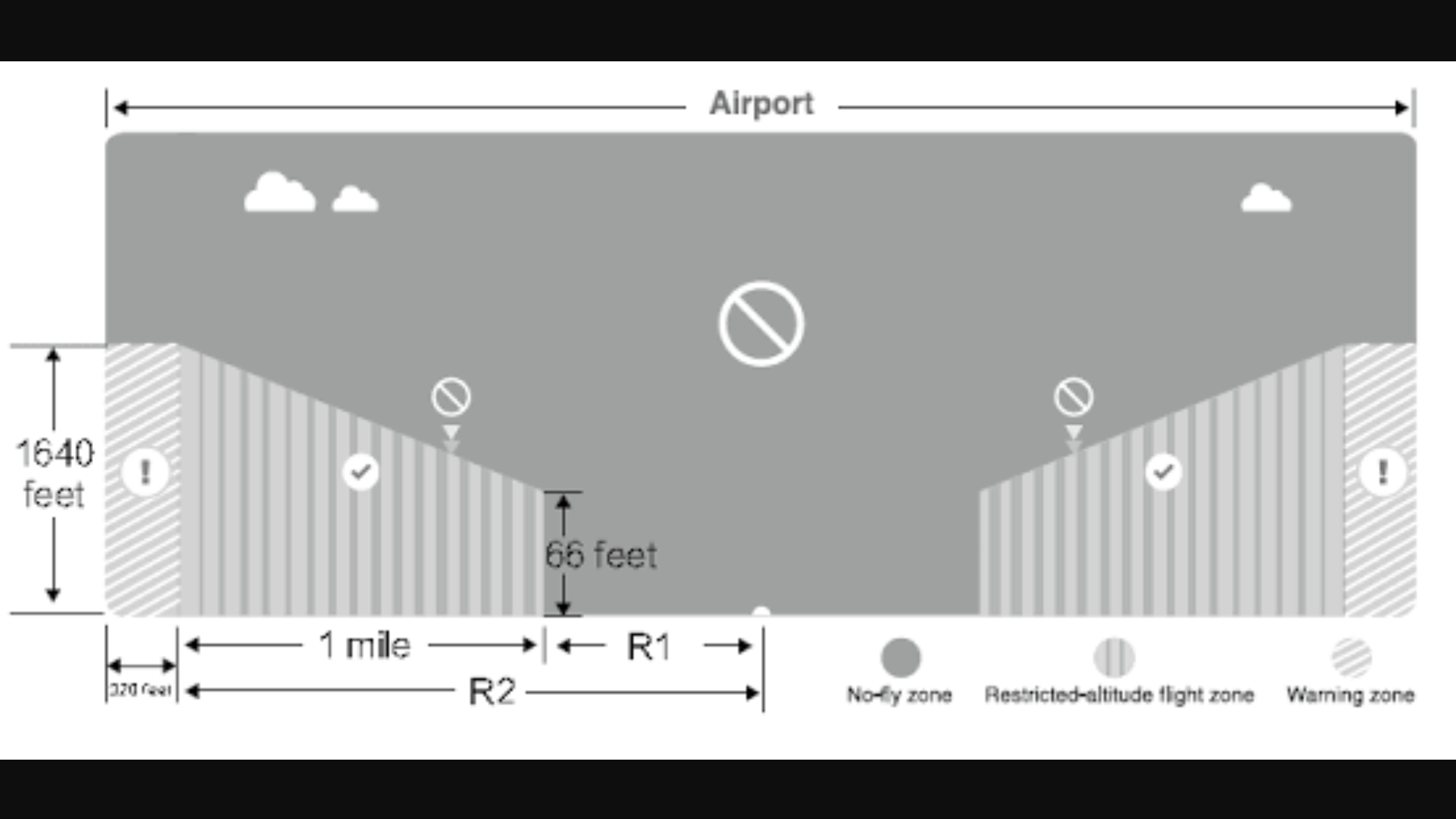

DJI specifically mentions an "airport limit" and time entered (also saying your AC was at 380+ feet).

If the AC is performing a RTH and hits what the software reports as an NFZ autoland is the only option. It isn't programmed to fly around or backtrack.
So if your certain it's not a NFZ you should ask DJI to consider whether a bug in their software contributed to your loss and ask them to help. They have stated their position, it was a NFZ associated with an airport.

This is the location DJI are saying he entered the NFZ 41.7916906 -88.0248892. I can't find anything anywhere near there other than a hospital helipad about a mile north. One would think they should be able to tell him exactly what NFZ he was in even it was a TFR.

There can be, but that one isn't according to DJI GEO. I'd show them the coordinates on the DJI geo map and show them there are no restricted zones where you were.

The information about auto landing in a NFZ can be found in the user manual.
