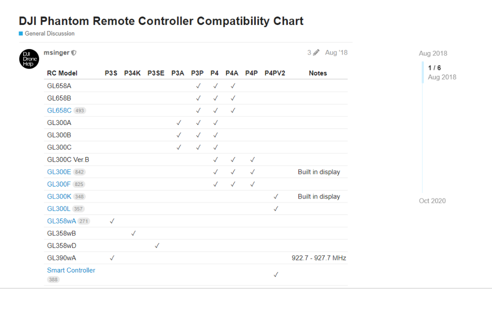

Ya that is what I was guessing too. I found the compatibility list and was just wondering if there were other options out there. Have had this charging issue for 2 years now and heating it is starting to not work.My guess would be no. Different radio frequency. From the compatibility list that I’ve seen, I don’t see any references of a working solution.

I would have to confirm when I get home but according to DJI website the A,B and C are all compatible with the P4 standard.The one on eBay is for an A. What model is yours?
That's a terrible idea lol....Does anyone know if a phantom 2 vision+ remote will work with the phantom 4? I have a phantom 4 and issues with the remote and thought I would buy this phantom 2 vision+ complete with the FPV not working and use it for parts.
