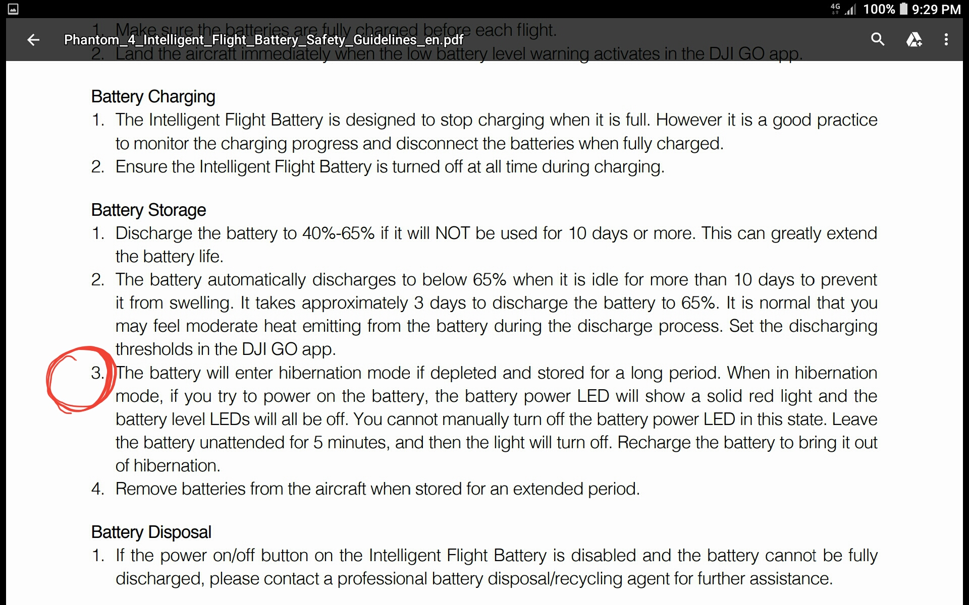

Have never used the charger but,the battery's might have entered hibernation mode,??? ,I don't think they would over charge cause they shut off when charged but bit of a fire risk to leave lipo battery on charger,,I presume it was off

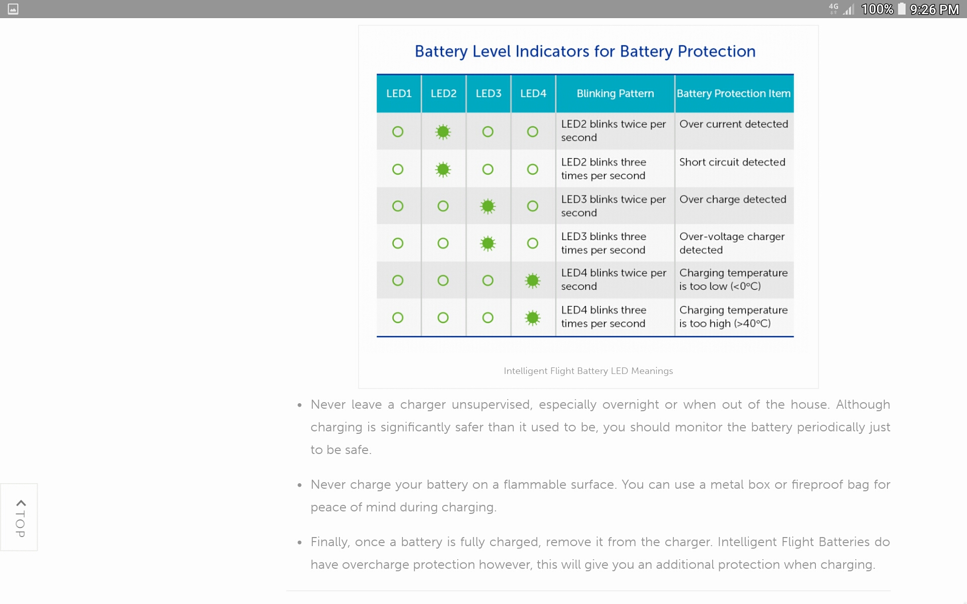

Here's a light chart aswellView attachment 100434

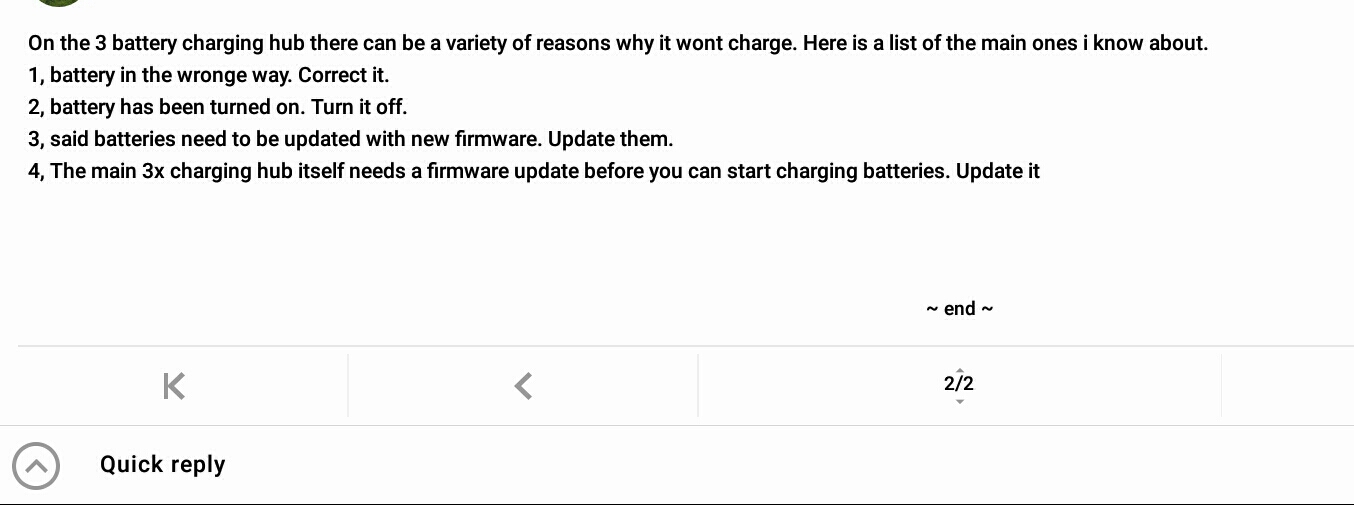

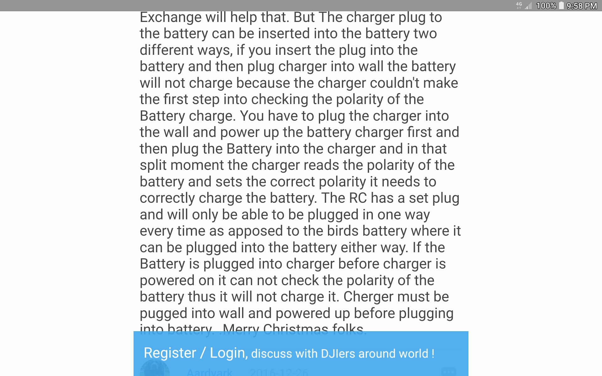

Well you not alone but couldn't find any on battery hub like you describe, do you have a original charger you can try ? Did find this post,someone posted for a idea,some take battery apart,(risky)just odd how the 3 did same thing,could contact dji and see what they say to do,I be looking so if I find better fix I post it
