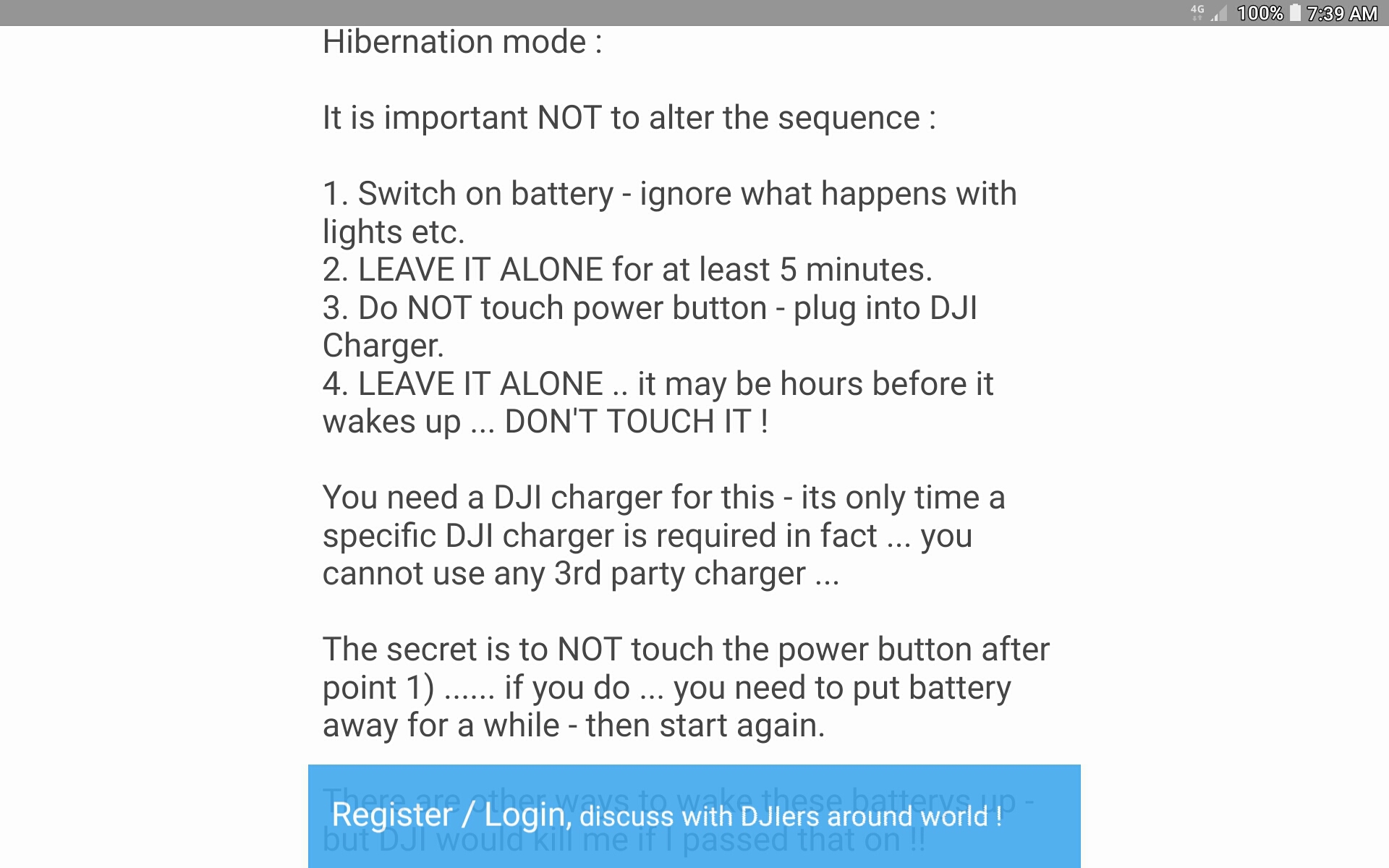

Has anyone had this problem??
I have a phantom 4 pro that I've used for about maybe 2 hours. Today after a year of sitting in the box I went to charge the battery for flight and none of the lights on the battery turned on. I know the power plug is good because I charged the remote controller. I left the battery plugged in for few hours and still nothing. Any tips would be appreciated. Thanks.
