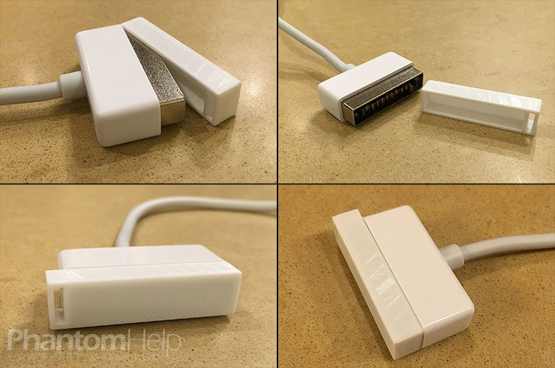

I just printed them in glow in the dark ABS , the rectangular cover is just a tad longer than it needs to be, the width is good. is that what you mean? or did the width not work?
Exactly. Anyway to fix that? Thank you so much
Yep , btw thank you for testing for me :) I scaled the x axis down by 2 % and it worked great, I'll fix and shoot the file to you when I get home
no problem....i also tried scaling x-axis down 2%, but still doesn't fit.....it's probably the way the dremel software scales things......I'll be patiently awaiting the updated file =)
Still doesn't work for me :(
whats wrong with it specifically? is it the length or depth? this worked perfectly for me with glow in the dark ABS, I switched out my filament to some older stuff i had laying around without the calibration settings written on the spool that gave me a bit of hassle getting right. in that case i had to scale the whole thing down 3 % and increase the extrusion multiplier since i was too lazy to figure out the exact settings.
