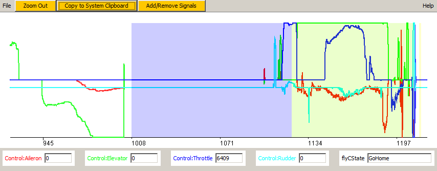

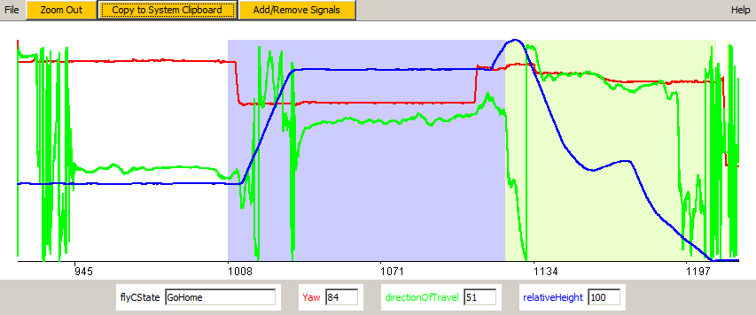

  3. BudWalker
    Jun 24, 2015
    963
    295
    Santa Margarita, Ca
    This is a really interesting incident. It would appear that when RTH was in effect the P3 was trying to dead reckon back to the home point. I.e., it didn't do any course correcting as is normally done.
    At 1007 the waypoint mission initiated a RTH(displayed as the area with the light blue background). The P3 started to climb to it's RTH altitude (blue line). It turned to a heading of 84 degrees (red line), the direction of the home point. However, the directionOfTravel settled in to 55 degrees. The problem is that directionOfTravel remained at 55 degrees until the pilot took over and started providing stick input at 1108.

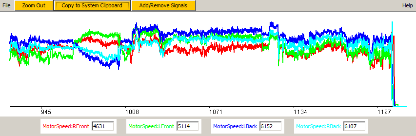

    The question I have is why didn't the P3 determine that the directionOfTravel needed to change to 83 degrees and make the necessary motorSpeed changes.
    The pilot was able to steer the P3 back home. It's not like there was too much wind and it couldn't achieve the requisite motorSpeeds. The P3 didn't even turn into the wind it just kept on the same 84 degree heading while being blown off to a directionOfTravel of 55 degrees.
    Meta4 likes this.

    Thanks BudWalker for spending the time to look at my flight data and providing your analysis comments.
    I had just accepted the DJI official response that the problem in my RTH was caused solely by the wind / low battery as being the final reason, especially after seeing the wind speed data on the HealthyDrones site.
    I was so relieved to have taken over in time (just) to have got my drone back over the headland, and ultimately within only 20 feet of me.
    Today I carried out a full physical inspection of the P3P, checked the tightness of all the screws, did an IMU calibration, gimbal calibration, compass calibration, fitted a brand new set of props and did a dozen automatic take offs and landings plus some automatic RTH flights whilst being in the safety of the field behind my home. The P3P handled perfectly and I (hopefully) have got away without causing any damage. Admittedly the panic landing was quite soft and slow in the long grass, much better than if I had landed it on the surrounding granite rocks or hard pathways. It was only the one prop that first entered the long grass that stalled a single motor, and my CSC in under a second seems to have worked OK.
    Your comment about the P3P not trying to correct its heading during the RTH stage of the flight was inline with my initial gut feel about the incident. I had imagined that the drone would have used whatever momentum it had to try to head back home, even if that resulted in it basically standing still fighting a headwind but trying to fly in a straight line back home, or course adjusting during the RTH to always try to head back home. Instead it seemed content to fly more or less in a straight line out past the headland, at least until I took back over the control.
    I know I made many mistakes in this flight, including letting the power get so low before the "Go Home" kick in whilst still 2200 feet out to sea, and relying on the "Go Home" for too long before taking over was amongst them.
    I wasn't looking to blame the drone, but to try to understand more about why the drone maintained the constant trajectory during the "Go Home" stage without any course correction, compass and GPS were good both at take off and during the flight, out on the headland and across the bay must have been fairly free from wifi interference, it is only the section of flight where I sweep in along the coast road near the houses that I get some signal strength issues, presumably in part from so many of those homes having wifi.
    If "Go Home" can sometimes (rarely) happen without there being any course correction, it might contribute to some users fly-away experiences and not everyone would be so lucky as I was to get their drone back safely. I will certainly be more wary of the automatic RTH in future.
