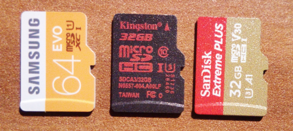

I have a Sandisk Extreme PLUS Card, I made a comparative test with an other U3 card, and with an U1 card.
Members of test was:
Samsung 64 GB sd card with U1 certification (which garantees 10MByte/sec data speed)
Kingstone 32GB sd card with U3 certification (which garantees 30MByte/sec data speed) and Class10 certification wich is equialent to U1
Sandisk Extreme PLUS 32 GB card vith U3 and V30 cerifications (which garantees 30MByte/sec data speed)

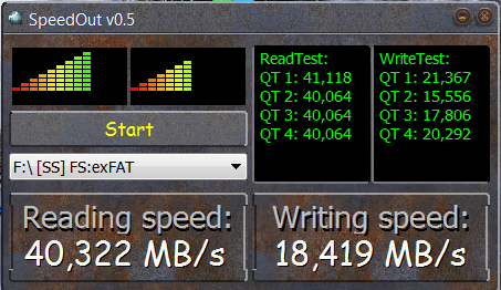

Samsung U1 card :
Both values, 40MB reading speed, and 18 MB write speed is far over the expectation of U1 standard. (10MByte/sec)
But in my experience this card is to slow to record 4K video in same situations (fast changing, very detailed image)

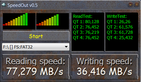

Kingston U3 card:
Both values, 77MB reading speed, and 36 MB write speed is over the expectation of U3 standard. (30MByte/sec)

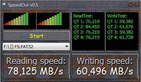

Sandisk Extrem PLUS U3 card
Both values, 78MB reading speed, and 60 MB write speed is far over the expectation of U3 standard, it is on the limit of V60 certification.
In my experience this card is excelent for recording 4K videos in any situation.
