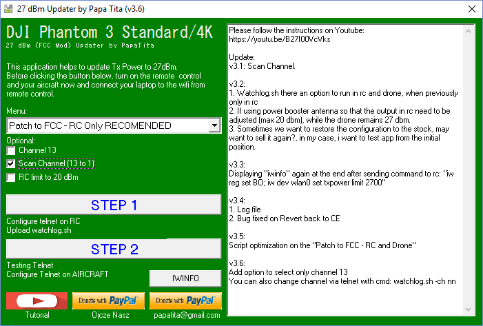

how to change 27db to e.g. 24db ?
- if mod is installed via djiupdate.exe, revert to stock
- then edit the watchlog.sh that is included in the zip file
via notepad++ and replace everey 2700 with 2400
- use djiupdate to apply the mod
would that be working and be a safe way ?
you simply change the line 11 and run the application
Reactions: ych and petermeter

tested the update tool with the recommended option,
2nd step gave an connection error despite correct reboots,
had to activate telnet on drone manually by copying the
modified djiled.sh from remote to drone with filezilla in acsii mode,
was then able to complete the second step in the tool,
iwinfo via android phone during flight returned for both rc and bird
"27dbm etc" and stayed so,
the range was a bit better +30 percent or so,
maybe because of wifi e-smog,
my question is now, is it possible that iwinfo shows 27 (maximum)
but in reality for some reason it does not increase the real transmit power enough?
set to "fixed" would be too unhealthy for the hardware..
fw is 1.6.8, stock antennas, no previous attempts of scriptmodding
thanks

Ok. Tried this mod and run into a problem, perhaps someone can help?
1. Switched on drone and Rc
2. Connected to drone wifi from my laptop
3. Run the updater mod and selected RC update only recommended
4. Clicked Step 1
5. Message displayed telling me to restart both drone and Rc which I did
6. Reconnected laptop to drone wifi
7. clicked option 2
At this point I got a message advising unable to telnet to RC (not exact words)
Tried several times, but no connection. Had to close program and hoped it hadn't bricked the RC, it hadn't everything went back to original configuration (phew)
Any idea why the update program could not secure a telnet connection on step 2?
Thanks
