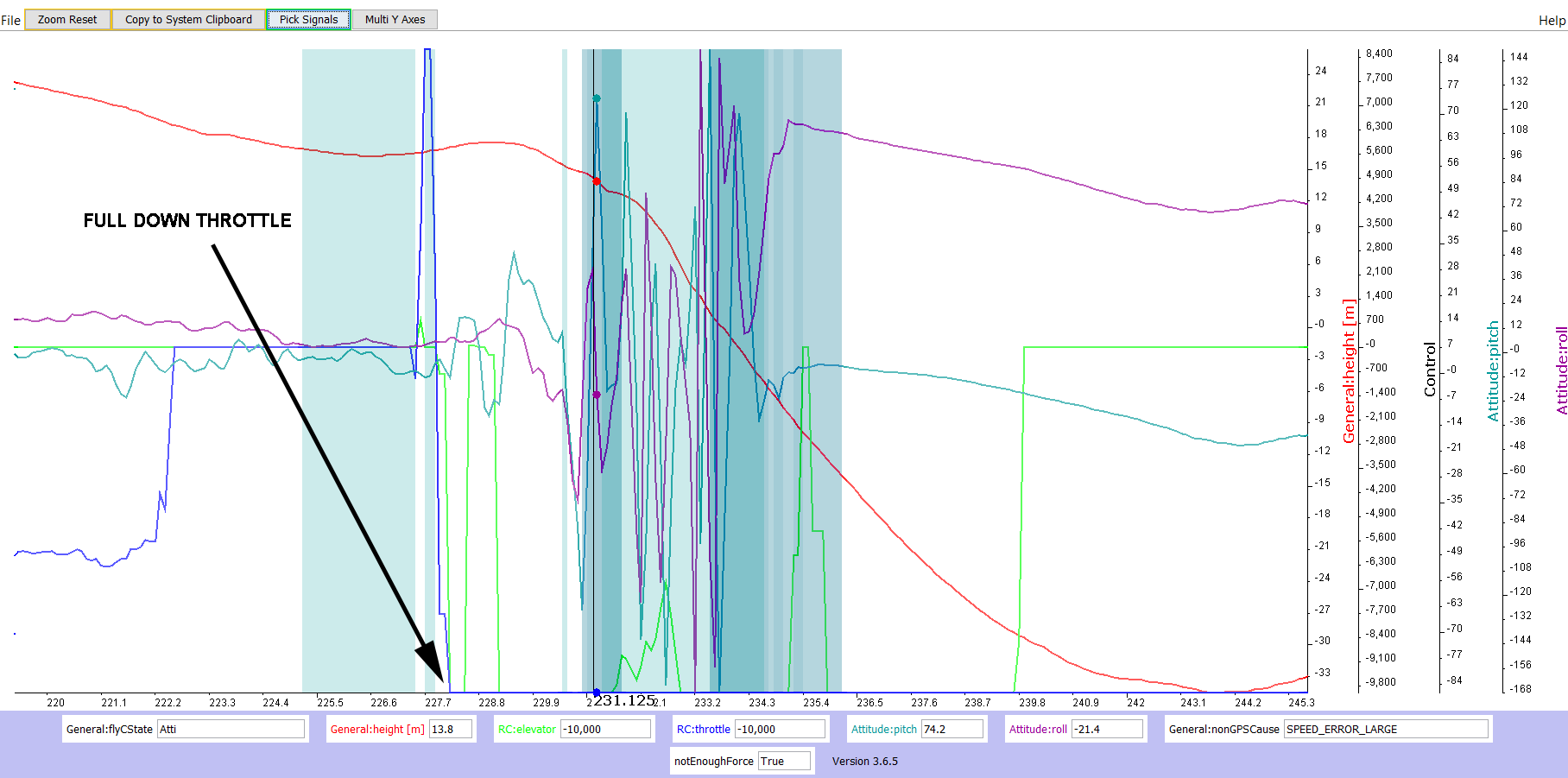

@RodPad .....If this is indeed a compass issue, we will need the aircraft .dat for the MAG data. I will say, however there may be 2 issues here. The compass and possibly an ESC problem. But again, that is difficult to discern from the mobile data. I have looked at this previously but only briefly and did not get back to it due to other issues. I mention the ESC due to the severe pitch and roll during ATTI mode with full throttle down. Why the OP did this is a mystery. Had the OP allowed the aircraft to hover and drift, as it will do in ATTI mode, as opposed to the full throttle down, the crash could have been avoided. That aside the aircraft .dat would provide more info as far as the compass goes.
I did this out of panic, I have lost confidence in this drone, when it comes at you one tends to do this, it does not like to do a stable hover, I know what that is, it was always stable before, just hasn't seen this behavior exhibited recently.

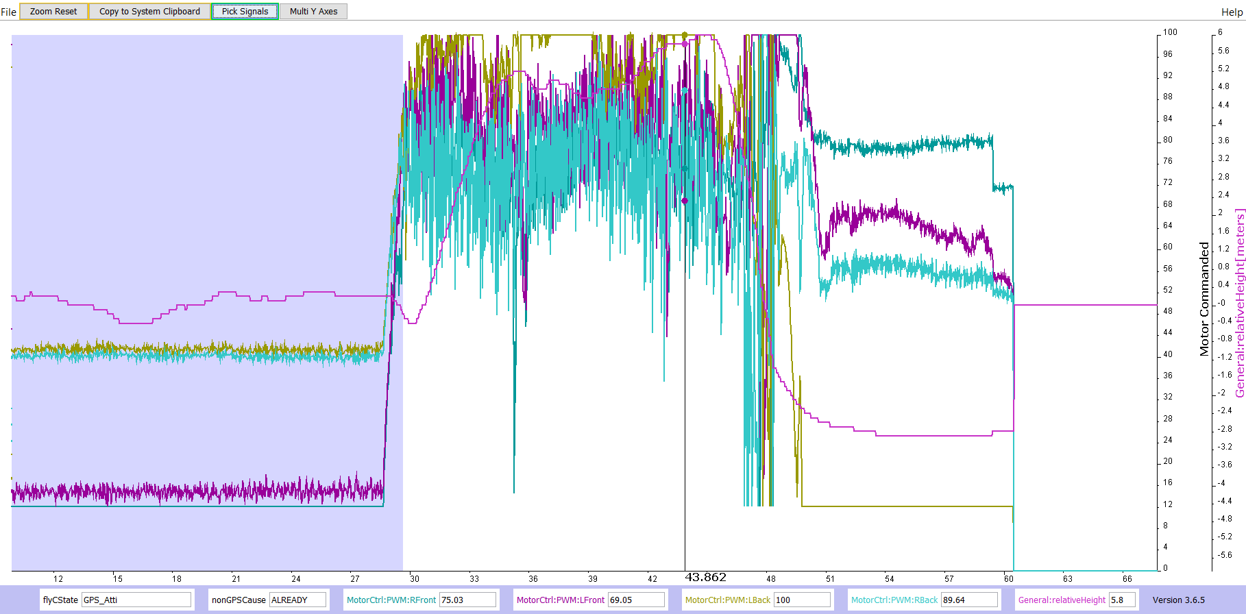

This looks like a Left Rear motor or an ESC issue at quick glance. Let me see if @sar104 can give you a more detailed answer on this.
Yes - the left back PWM is going to 100%, which means that it's not producing enough lift. I guess that could be the ESC or the motor itself. Not likely to be the prop.
Thanks for the quick diagnosis, so if I keep it, send it in to DJI or just put it up on ebay as is, I had P2 that after a river encounter just about put me in the poor house trying to fix it, don't want to go that route again.
