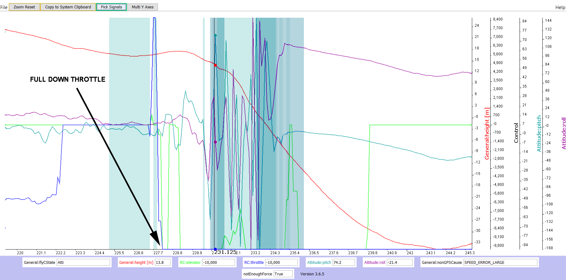

@RodPad .....If this is indeed a compass issue, we will need the aircraft .dat for the MAG data. I will say, however there may be 2 issues here. The compass and possibly an ESC problem. But again, that is difficult to discern from the mobile data. I have looked at this previously but only briefly and did not get back to it due to other issues. I mention the ESC due to the severe pitch and roll during ATTI mode with full throttle down. Why the OP did this is a mystery. Had the OP allowed the aircraft to hover and drift, as it will do in ATTI mode, as opposed to the full throttle down, the crash could have been avoided. That aside the aircraft .dat would provide more info as far as the compass goes.
