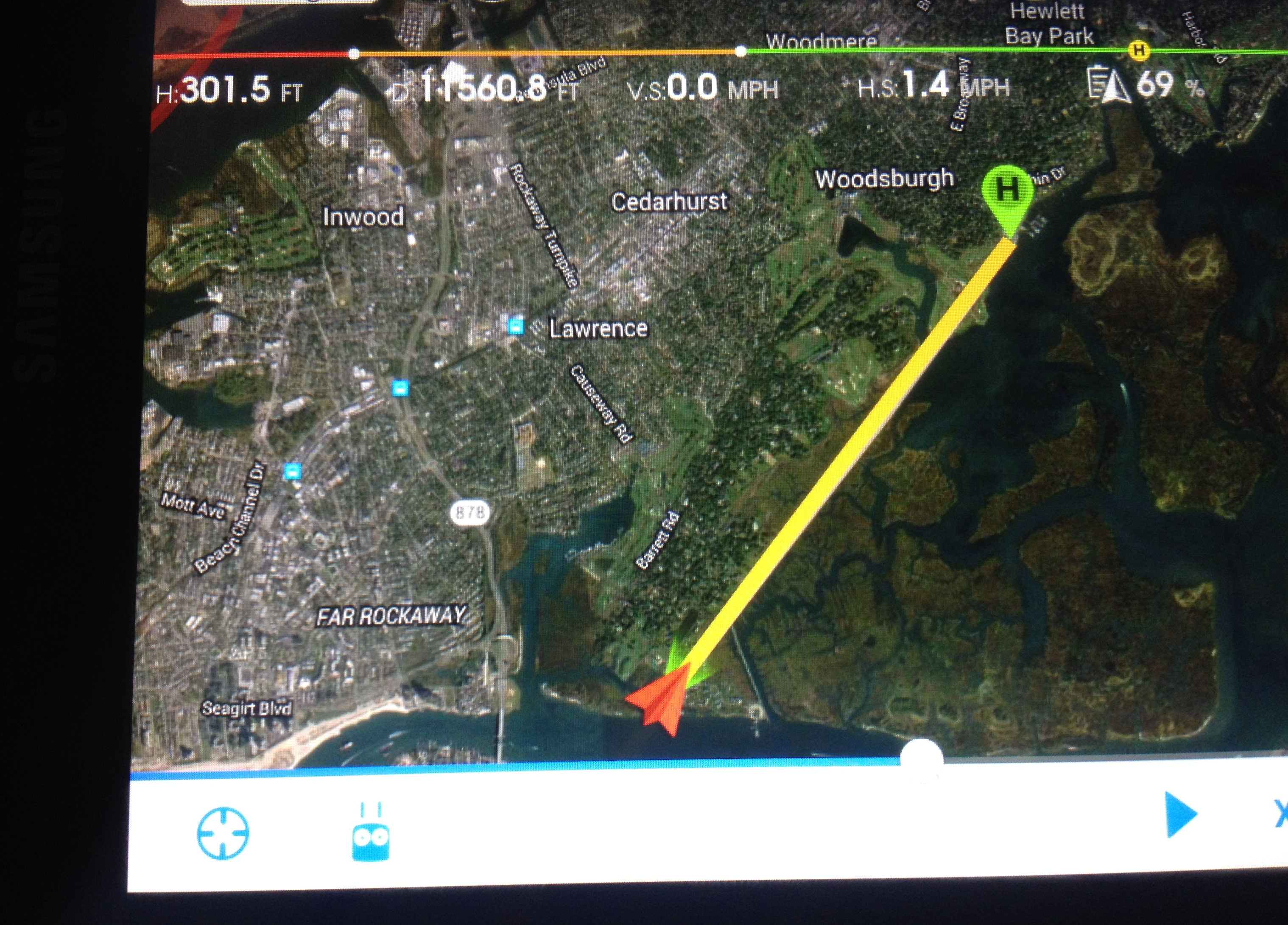

Found 1 screenshot pic of the best flight i had on the P3S. Unfortunately at the end of the flight i had great connection but a group of people stopped right in front of me with one of them on their cell phone and i lost signal right when they moved in front of me. Not sure how much further i wouldve got if those people didnt stand in front of my antenna.

I went with the DBS ItElite and it seems to work pretty well. The internal cables that came with the antenna were too short to run them to the top of the controller so I had to put the connectors out the bottom. That required longer external cables that had right angle connectors on both ends. I got them on Ebay - they are the blue cables and are much stronger than what comes with the antenna. When I went to unplug the original TX cable inside the controller (after carefully removing the glue) the ring that the connector grabs to hold it in place came right off the board with the cable. I used almost no force to remove it - it literally fell off the board. Not a big deal though, just soldered a small jumper from the ground of the new connector to a ground on the board and stuck the connector on the pin and dropped a few drops of hot glue to hold it in place. Works just fine.

I swapped the Samsung S5 Active for an Nvidia Shield tablet and it seems to have a more reliable connection. On my last video I flew 4800' and today I got 8100'. I still has 5 bars but it lost connection shortly after the screenshot.
Hm...interesting So you just have a DBS Mods (ITElite panel) and no extra amps with stock bird and almost DOUBLED your range just using a different DEVICE? I too have noticed some interesting differences between my iPhone vs. Nexus 7 tablet-the Nexus seems to cut out earlier and more often. Not sure WHY the device would matter-but it apparently does somehow? Wonder if anyone could shed light on this? Obviously iPhone has Wifi/4G whereas the Nexus has only Wifi-wondering if that affects the signal in any way?
I'm not sure how the device and signal are related but it seems to be. I flew in my neighborhood and flew 2000' away over houses before losing connection. It wasn't even close to that before.
