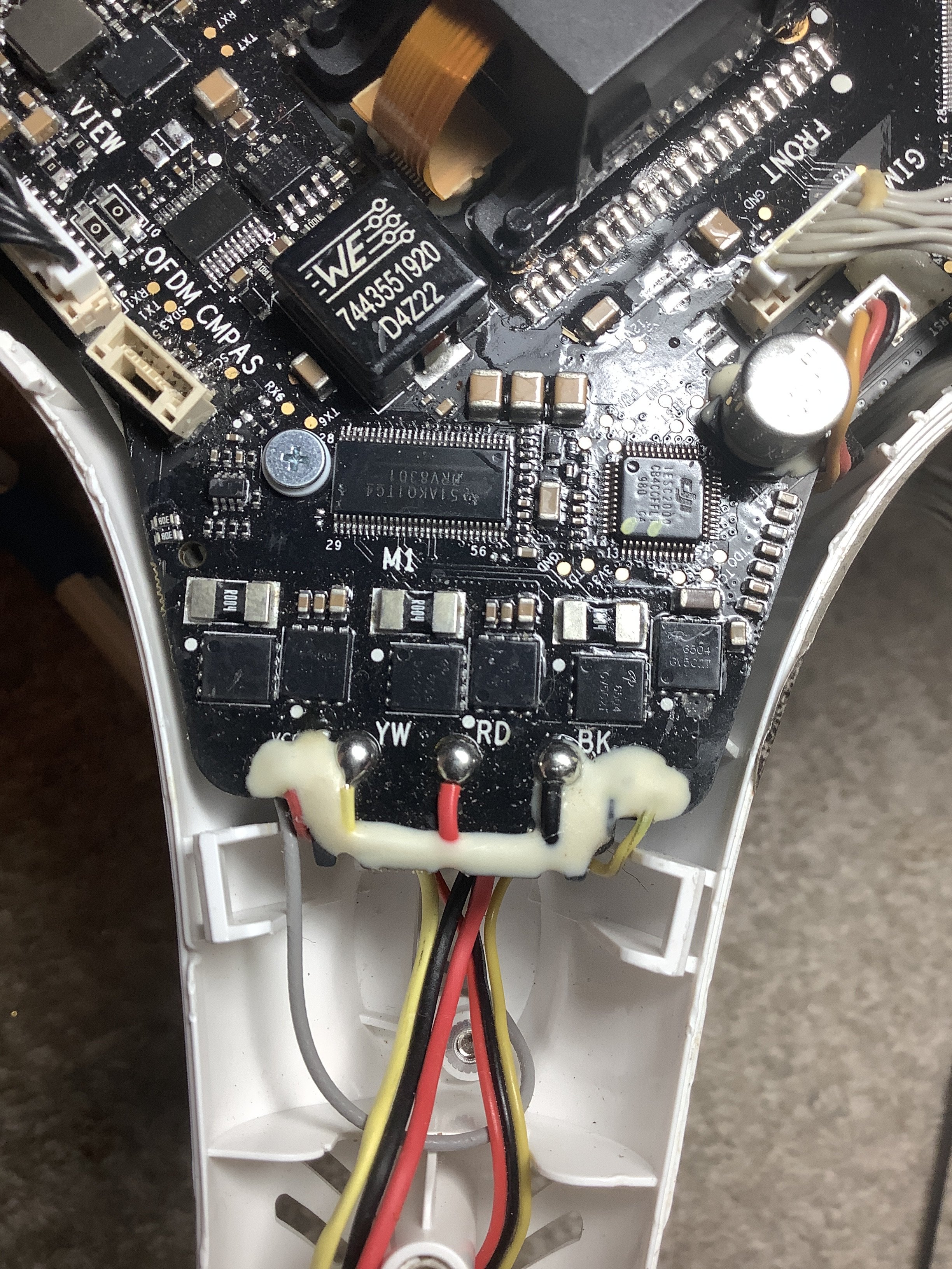

pleeeeeeeeeease which motor or arm is
[00025994][12 01][00] device not detected.
is it front right orleft or back right or left arm ????/
i know its an esc issue but need to determine its location
I would imagine that 12 01 would be the ‘M1’ on the board.
thanks Diver for your support but i suspect its M2 cause it starts 12 00 through 12 03 but it is only a guess!! we need an exact answer i dont want to mess with 2 locations, i searched with no success so far to determine it but i couldnt
