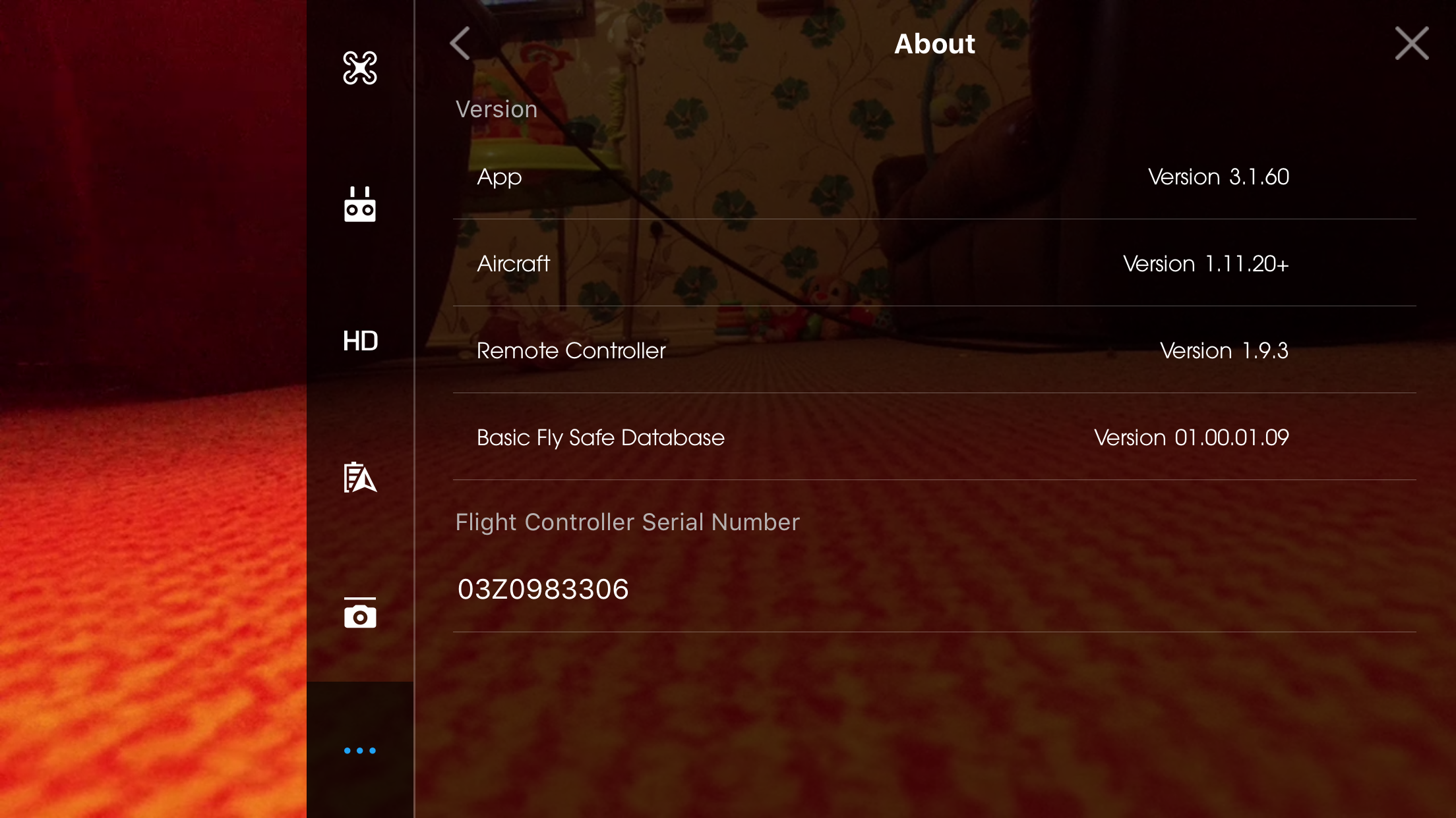

> DJI has historically maintained an archive of FW versions on their site even though they don't always show links to them. For archived FW versions directly from DJI, follow the links in this post. Obviously use the links listed under your model. In your case use those listed under Pro.
You've been asking for 1.8 in a couple of threads. Did you have 1.8 before you chose to update FW? Your range was fine before you made changes? What version did you update to on your AC and what do you have on your RC?

Since the P3P has never used 1.9.3, I suspect that either his RC is actually on 1.9.3 or less likely that his AC is on 1.9.6.
@Brenty20 - which FW version is on your AC right now and why did you choose 1.8.8 as the version you wanted to switch to on your AC? Which version did you install on your AC that you suspect impacted your range?

this is why i asked if the AC was really on 1.9.3 because that cant be true. it seems @Brenty20 you are confused with your AC / RC firmware because 1.9.3 is a good RC version but not a valid AC version for a p3p. did you see 1.9.3 on the AC firmware list that @Oso sent you? no right? post a screen grab of your app screen showing the right versions it might help.

@Brenty20 do you know that the AC and RC do not need to be on the same versions? give us that screen grab so the experts can see and help

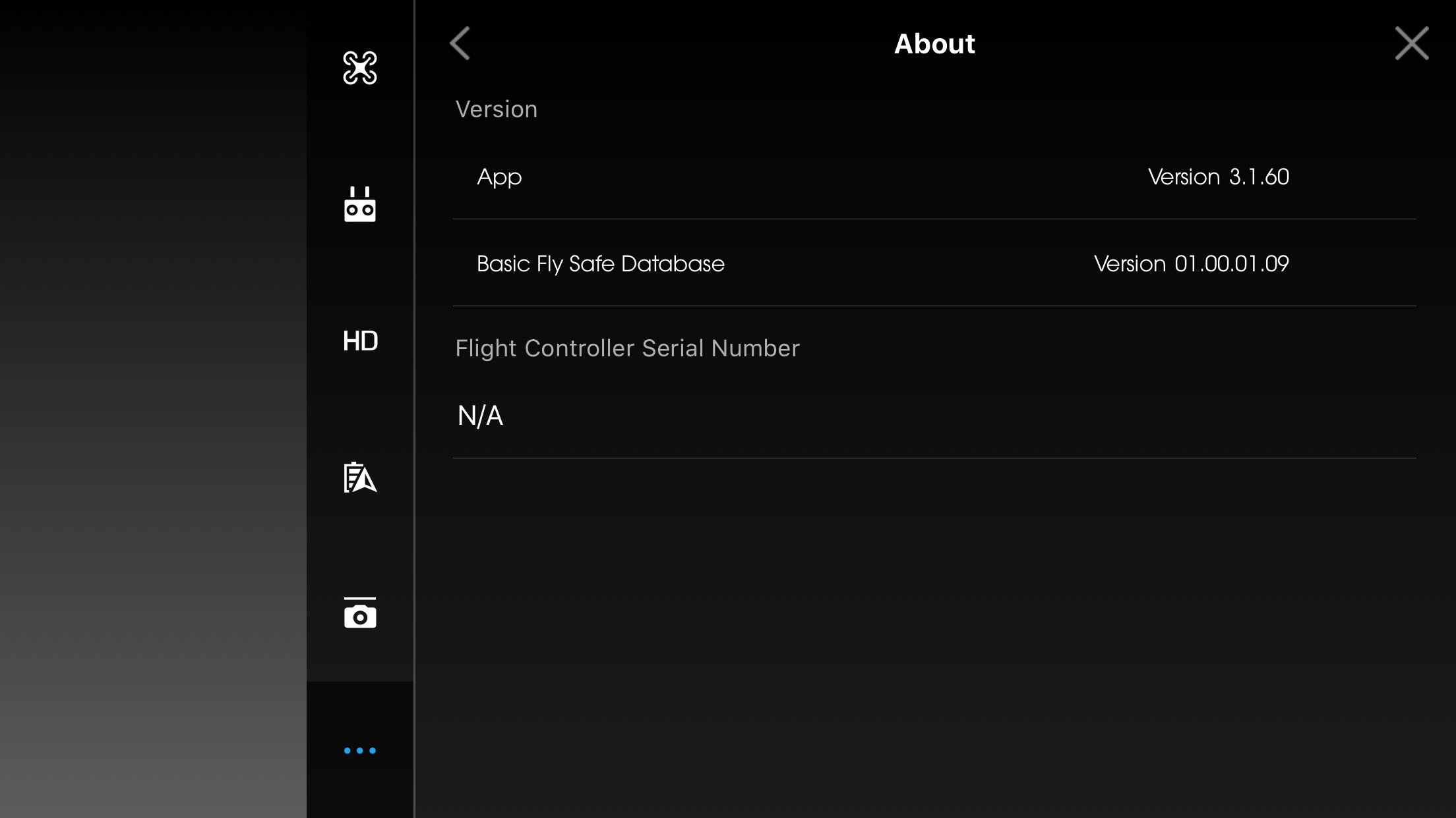

any chance of speaking to anyone of you on here if i contact you it be a lot better, This is all i can find im not to sure if i looked in the correct place
You need to turn on the drone and connect the drone to the remote controller to show the firmware version of the drone and the remote controller! Your screenshot only shows the DJI Go version and the fly safe database version.
How do i get the fw version for the drone
